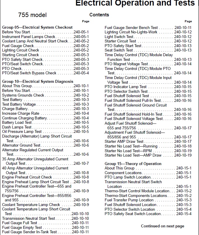

Greetings all,
Great forum and Ive used it in the past to chase down problems with my tractor.
My 755 has been cranking slowly so I bought a new battery. In the snowstorm in the dark I inadvertently reversed the polarity on the battery. Realized my mistake but now I have problems. It cranks but no dash lights and no fuel transfer pump. All the fuses appear good. The battery lead sparks and something energizes in the engine when I connect the lug, even with the ignition off.
Any ideas on where to start? Any help would be greatly appreciated as I need to get my driveway plowed!

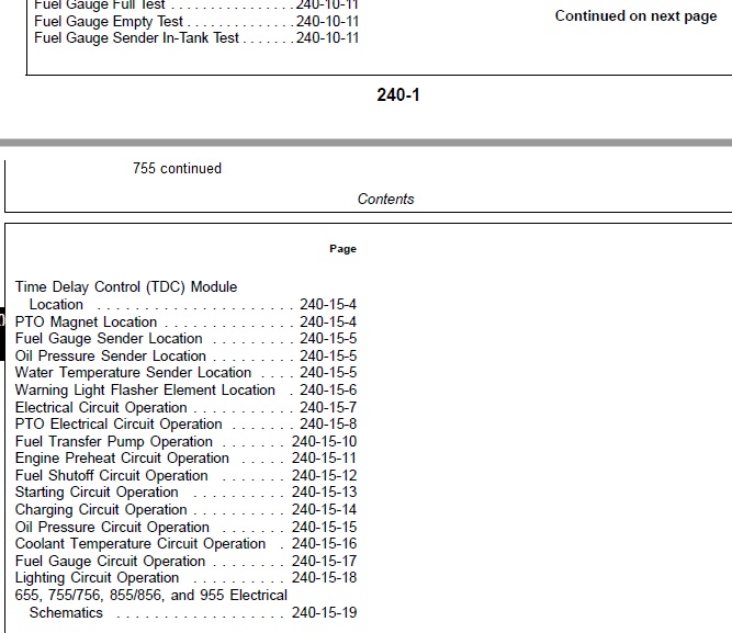

Two pages from service tech manual regards the electrical operation and tests.. as you can see, a long list. Where to start??
