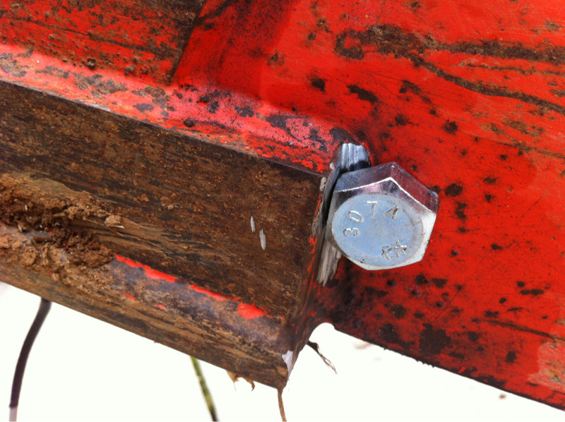

. . . The only issue I had with install was the bolt holes were very close to the reinforced corners of the bucket. Luckily I only had to trim a small amount of weld and metal to allow for the bolt head clearance. . . .
Glad you got it installed. I installed mine last week on my BX23. Interestingly, I had no issues with clearing the reinforced area on the outside of the bucket. Perhaps that's just a difference between the BX23 and BX25.
Here's a pick of mine. You can see how much clearance I had. It wasn't even close.

Glad you got it installed. I installed mine last week on my BX23. Interestingly, I had no issues with clearing the reinforced area on the outside of the bucket. Perhaps that's just a difference between the BX23 and BX25. Here's a pick of mine. You can see how much clearance I had. It wasn't even close.
Looks good! Mine is on a Grand L3830 72" bucket. A lot different shape than the BX bucket.
