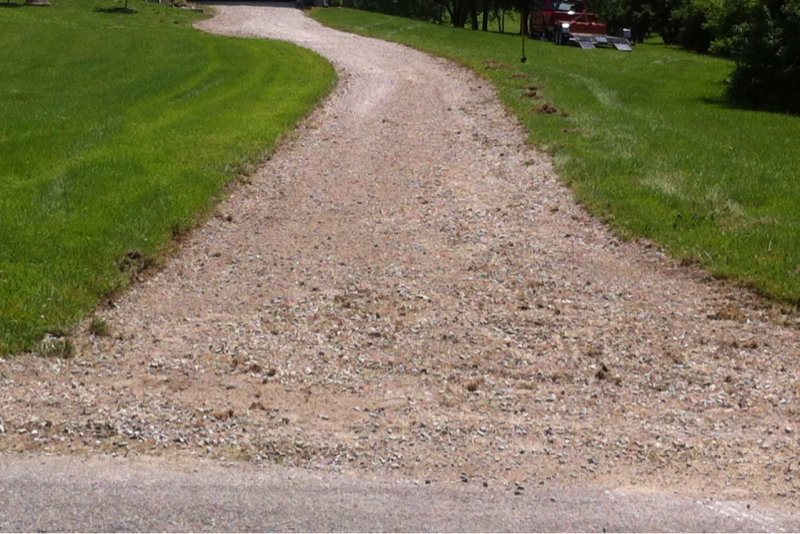

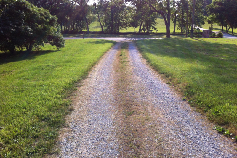

think I need both, the Piranha and the Ratchet. I don't dig lots with the bucket, but if I needed to, the Pbar looks like the ticket. mostly I'd use the RRake as a tool to drag/rake the gravel driveway/road and to prepare the yard for grass seeding. but it doesn't seem to me that you'd leave the RRake on during any kind of bucket use?
That's correct. You would remove the rake when scooping with bucket. It's awesome on gravel driveways. It brings up rock and tears out humps. Can rejuvenate driveway without having to add more rock.
