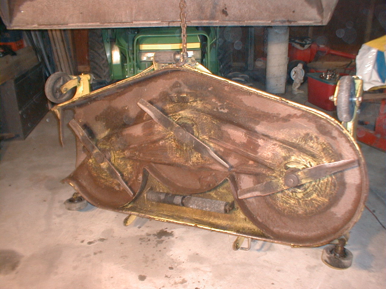

Currently looking to purchase a mower for attachment to a 955. Actually found four within a hundred miles. Some are without attaching hardware, others stored outside in the rain and snow. I did find a 72" from a 4700 that is in very good condition, stored inside, used only several years. I am aware the 4700 attaching mounts will not be the same but if the mower pto drive are in the correct location allowing it to be lifted properly. I ran into this going from a 455 to a 4110. I have made mounts and attachments in the past. ( the fun part of adapting ) Just curious if the basic shape will allow for a transformation.
Are any 72" decks " drive over " for mounting ? Another fabrication addition idea I would consider. Sliding a 400# mower under a tractor is not my idea of an easy attachment process.
Thanks, any hints, ideas, or opinions helpful. Anxious to get the " new to me " 955 out of storage and in use.

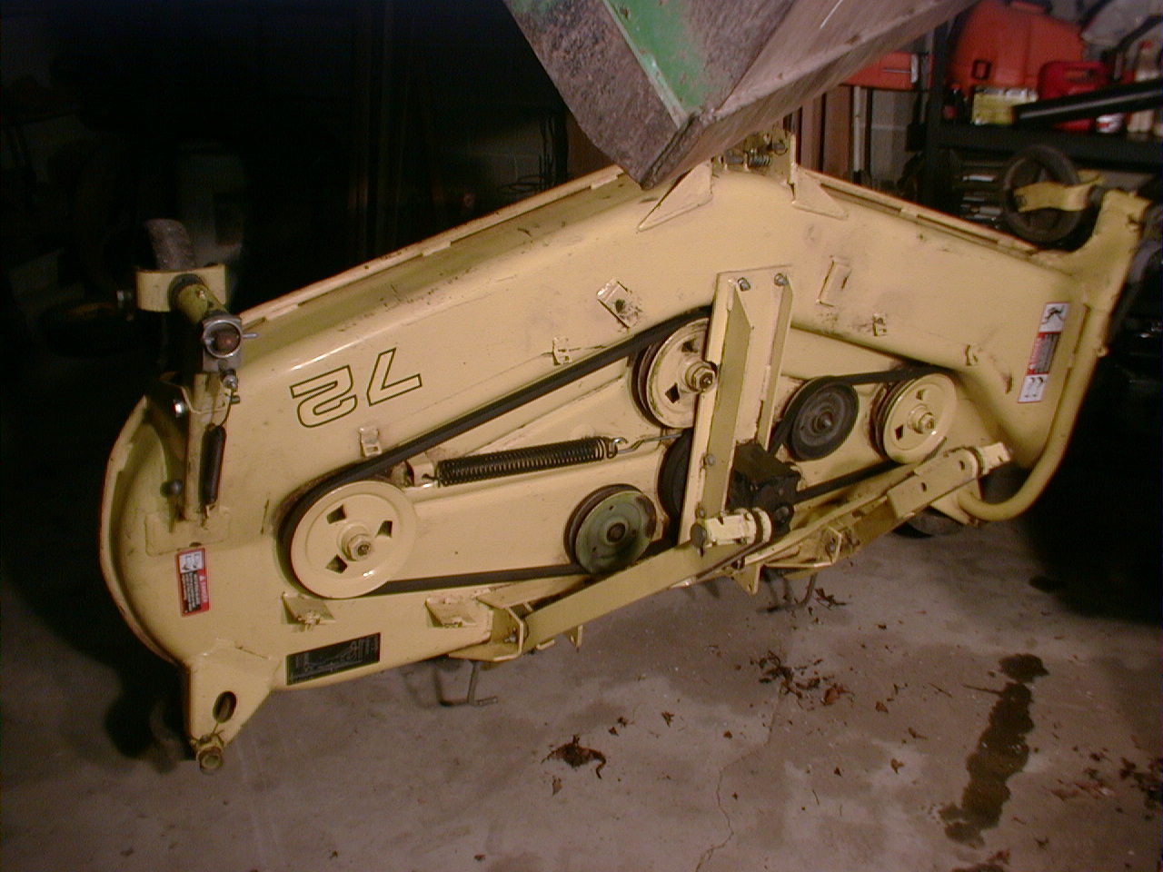

Purchased a vary nice 72" MMM today for $300.00. It does not have the correct attaching pieces for a 955. Modifying the existing mount is in the future. Checked the bearings and belt. The angle drive is full of oil with no play from top to bottom . I would venture to say the drive belt is expensive as it is twice as heavy as the 60" deck.

I was impressed. This deck is huge and weighs a ton. Truly heavy duty built . Its a shame they have a very poor paint process ( electro - static ) I read with no primer. The belt new is probably 150 or more. Anyway the challenge is on to make it fit.
