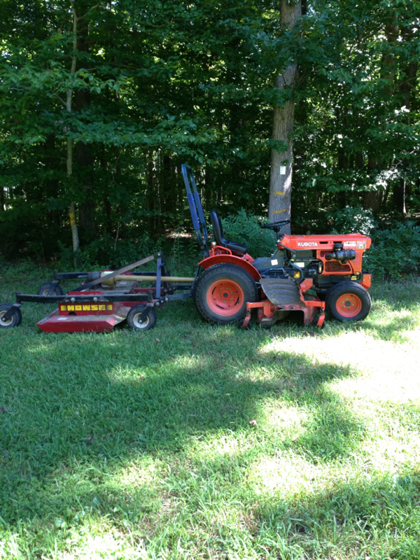

It will do fine as long as you keep up with the grass. Your bigger problem are hills. image-4013483331.jpg

I'm not sure what the Land Pride finishing mower weighs in at but I have a Woods Heritage 72 that I operated with my B3200, it cut well but on inclines the tractor and I knew it was behind it. I now use it on my Grand L3540 and I don't know it's behind it. Now on a BX23 could it even lift it with the three point and keep the front wheels on the ground? I would not do that as it seems like you would be testing the three point to fail on the BX23. Just saying.
