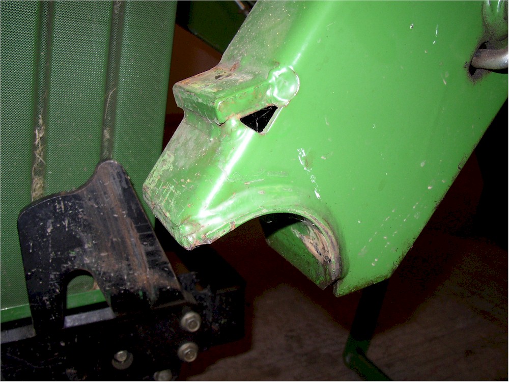

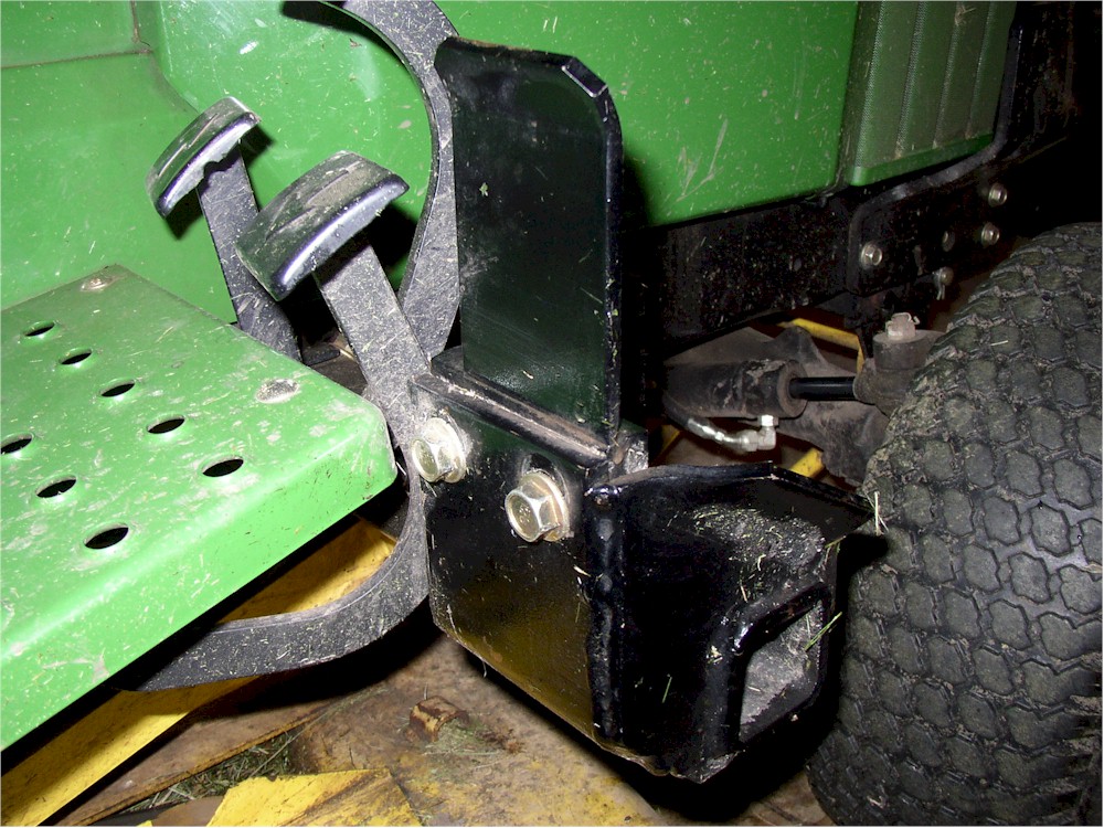

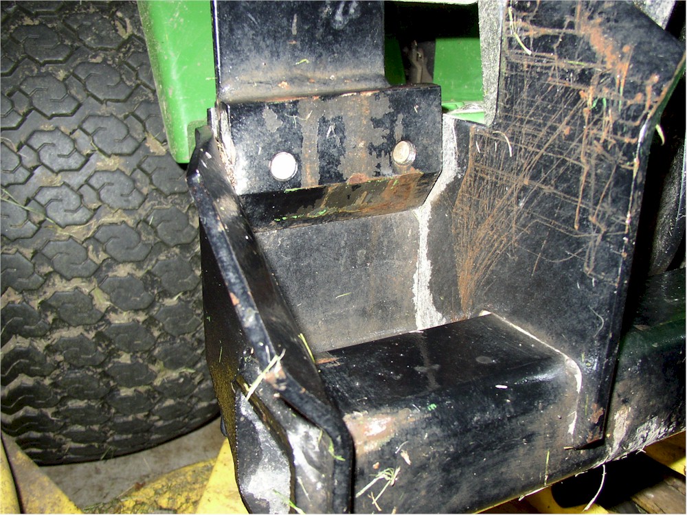

On the 70A, do the masts "attach" to the mounting frames? Or do they just "sit" on there?
   / 70A loader .... and other loader options for 955 #16
The masts sit on the loader bar. They are forced tightly in there during the mounting process using the loader hydraulics while it elevates the front wheels. It is then locked in that position by moving rods to close latches at the front of the tractor while sitting on the tractor seat. There is a procedure to adjust shims in the loader bar to assure a tight fit. In the procedure you loosen a couple bolts, move the shim, and tighten the bolts. It is a one time procedure other than being available to adjust for wear.
Some pics from a previous thread about 70 loader and shims.
