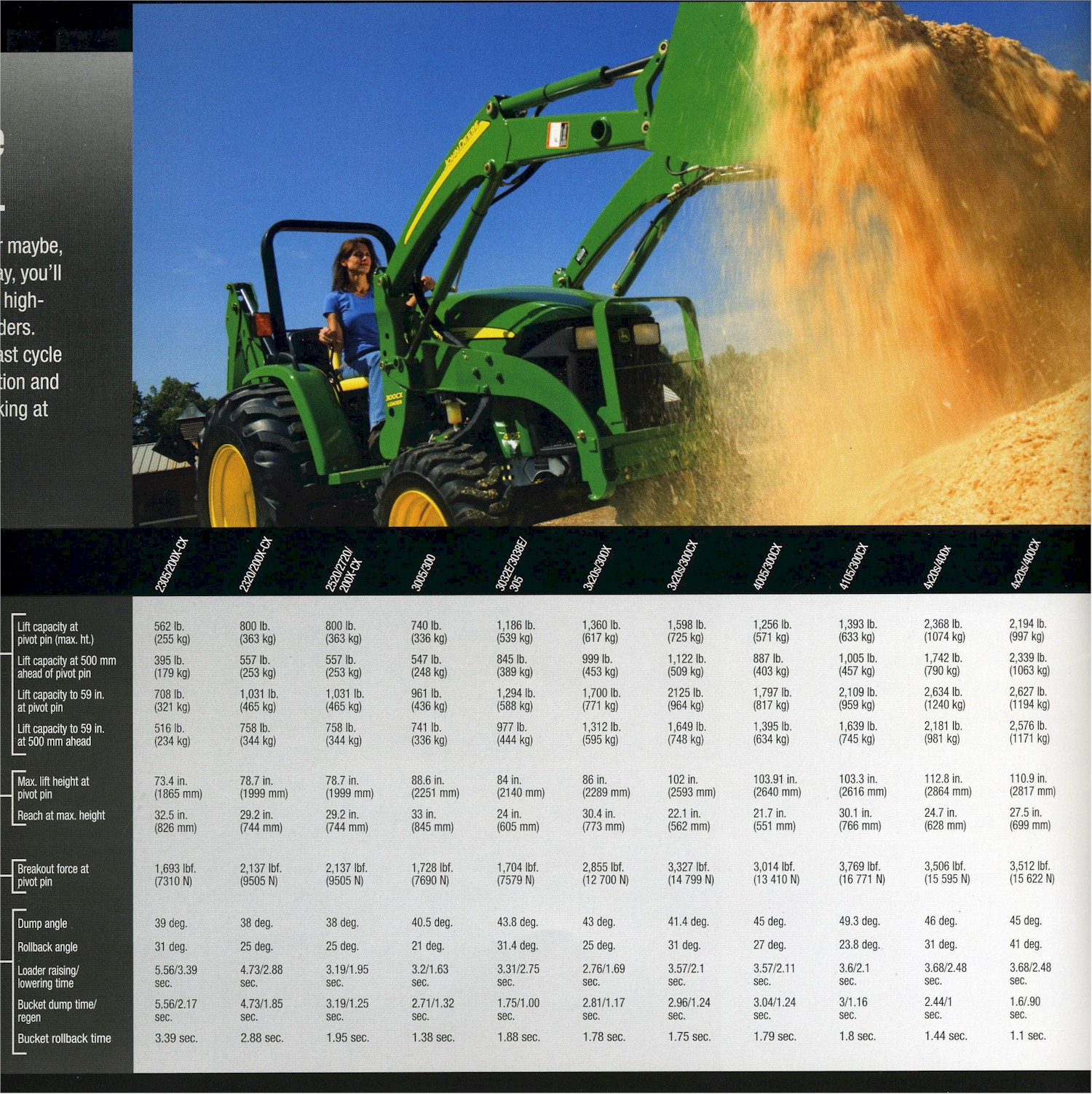

I've been looking around for a loader and the 70A's seem to be hard to come by. Looks like the options for loaders are the 70A, 300cx, and an aftermarket CTC 9050. I haven't seen any used 300cx loaders, but they are available new from JD. The 955 mounting brackets and oil line conversion kits, etc. are pretty spendy and adds up quick to make the 300cx a costly option.
I see that CTC is now offering a loader for the 955 (model 9050) but it's so new, I haven't heard anything about it. I've read about some people having some problems with CTC loaders, but those seemed to all be problems with the PTO aux. hydraulic pump & pump mount on the smaller garden tractors. Since the 9050 uses the tractor's hydraulics, I don't think there'd be an issue.
So, trying to compare the options, what is the rated lifting capacity of the 70A loader on a 955? Also, was is the lifting capacity of the 300cx on 955? I got the specs for the 9050 off of the CTC website and wanted to see how the other two options compared.
/ 70A loader .... and other loader options for 955 #2
The spec sheet from the operator manual for the 70A loader is attached. The far column is for the 955. The other sheet is numbers from a brochure for the 300 series loaders. However, some of those may not correlate directly to a 955. Also, JD Parts only shows a 955 mounting kit for the 300X, not for the 300CX.

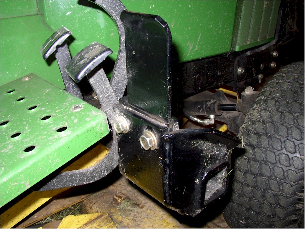

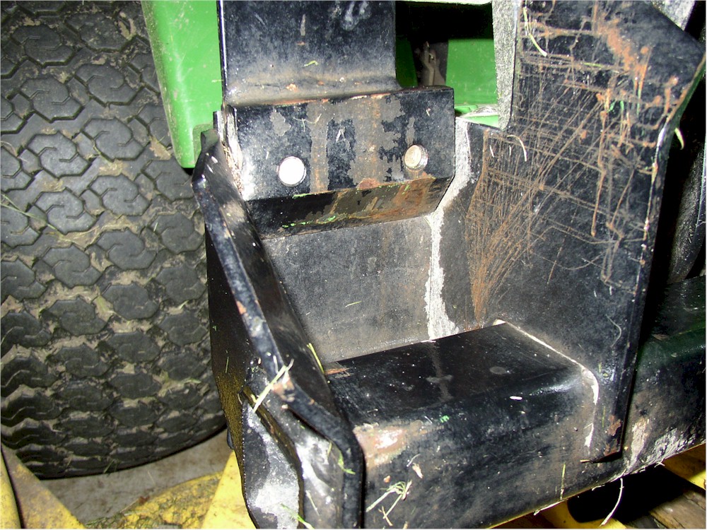

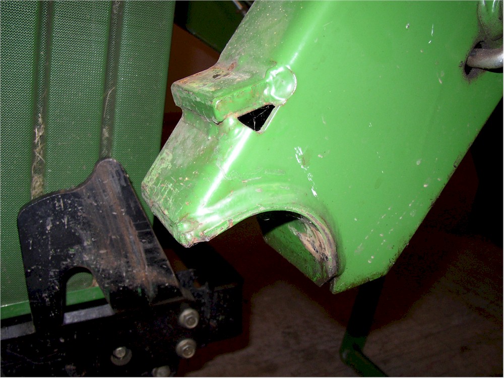

On the 70A, do the masts "attach" to the mounting frames? Or do they just "sit" on there?
/ 70A loader .... and other loader options for 955 #16
The masts sit on the loader bar. They are forced tightly in there during the mounting process using the loader hydraulics while it elevates the front wheels. It is then locked in that position by moving rods to close latches at the front of the tractor while sitting on the tractor seat. There is a procedure to adjust shims in the loader bar to assure a tight fit. In the procedure you loosen a couple bolts, move the shim, and tighten the bolts. It is a one time procedure other than being available to adjust for wear.
