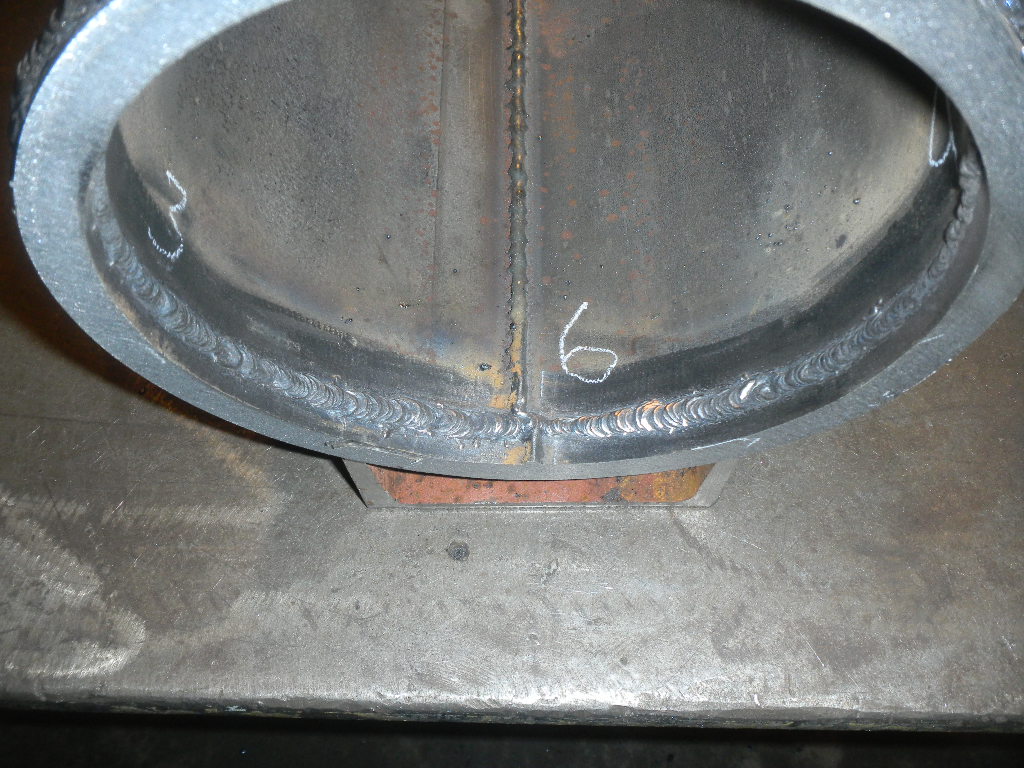

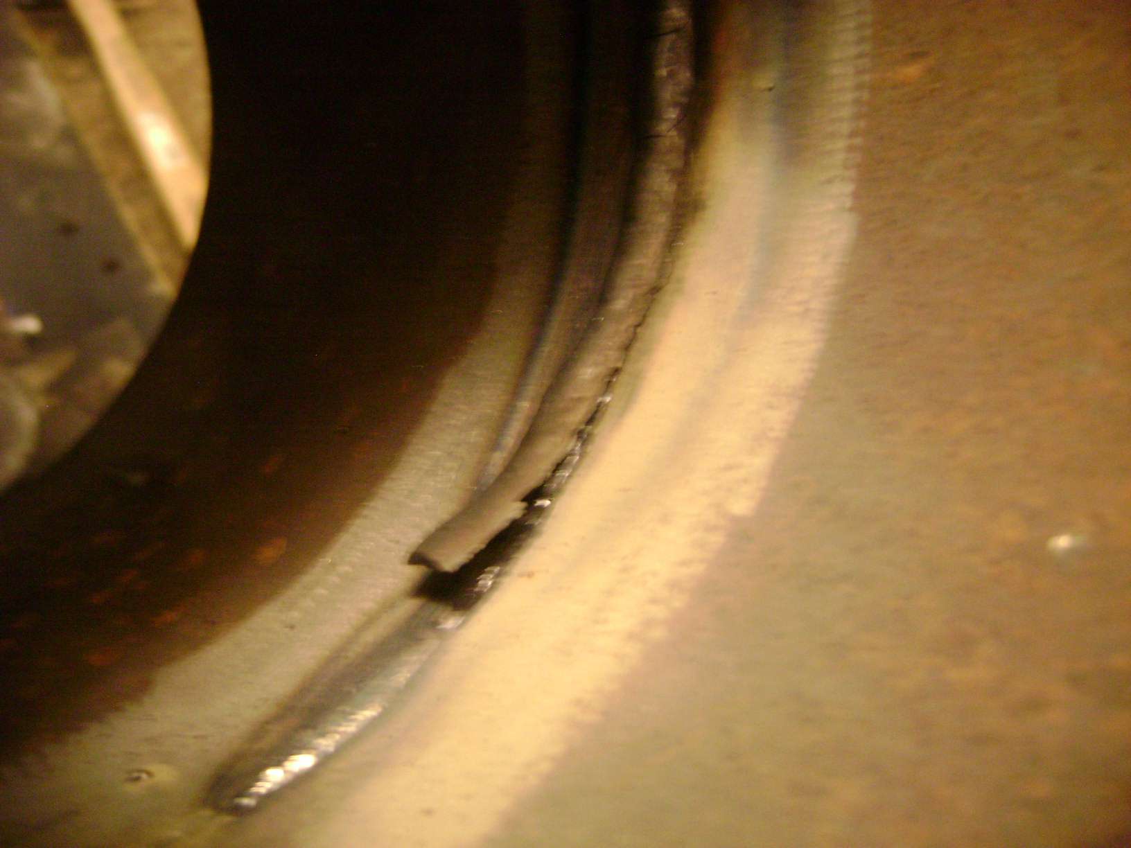

LD1 I understand a lot of places are testing now with open root pipe with 7018. I've played with it some, it is not near as easy as with 6010, but it can be done.
First picture is 7018 open root pipe, second in 6010 open root pipe.
I understand that 7018 isnt great at filling gaps(open rood).
My question was....why not 7014 instead of 6010?
Again, I havent used 6010, cause I have an AC machine, and when I have used a DC machine (everywhere I have ever worked), it has been 7018, but we arent dealing with pipe or gaps.
Just strictly looking at this from a "on paper" standpoint, and not from "experience", why not open root with 7014? Higher tensile strength. I would think the inspectors or engineers would see it this way. What am I missing?
