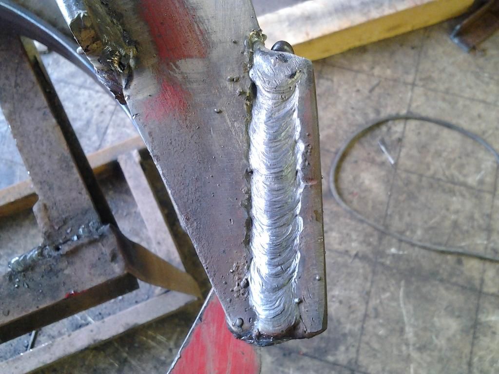

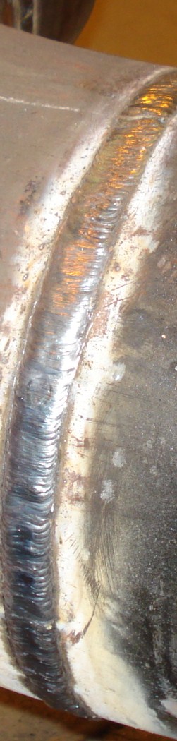

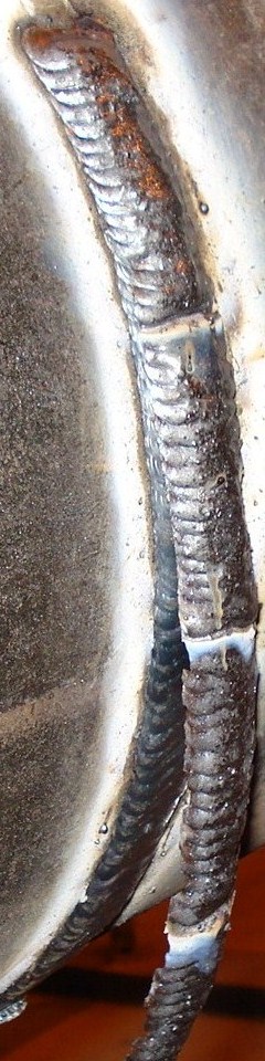

First picture is 7018 run on a AC buzz box. The second pictures is 7018 run on a DC welding machine.
See how the DC weld is much smoother, and more flowing lines to the weld? See how the AC weld is choppy, raged? That what I mean by wetting out.
So judging by your pictures and compairing them to mine... looks like I used DC rod on AC... ?
/ 7018 vs 6013 vs everything else #23
Dieselcrawler, your 7018 weld bead looks very good except you didn't allow it to fill in the undercut at the edges. I would run a quick bead with no weave to fill the undercut. That would eliminate the notch effect where a crack could start. For your application, 7018 was absolutely the best rod for the job!:thumbsup: Standard 7018 will work on AC, it's designed as an AC/DC+ rod. What Shield Arc was referring to was the way 7018 flows on AC current not how "DC" 7018 works on AC. That said, AC 7018 is specifically designed to be easier to use on AC current and give similar characteristics to 7018 on DC. Run standard 7018 on an industrial AC welder and it will run better than on a low end buzz box. Also different brands of 7018 can make a big difference.

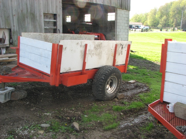

This trailer is about 20 years old now, and dont have a single weld on it that ISNT 6013. And has hauled MANY MANY loads of wood.

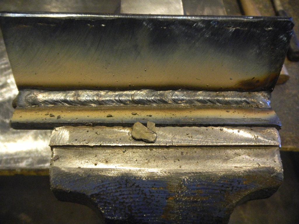

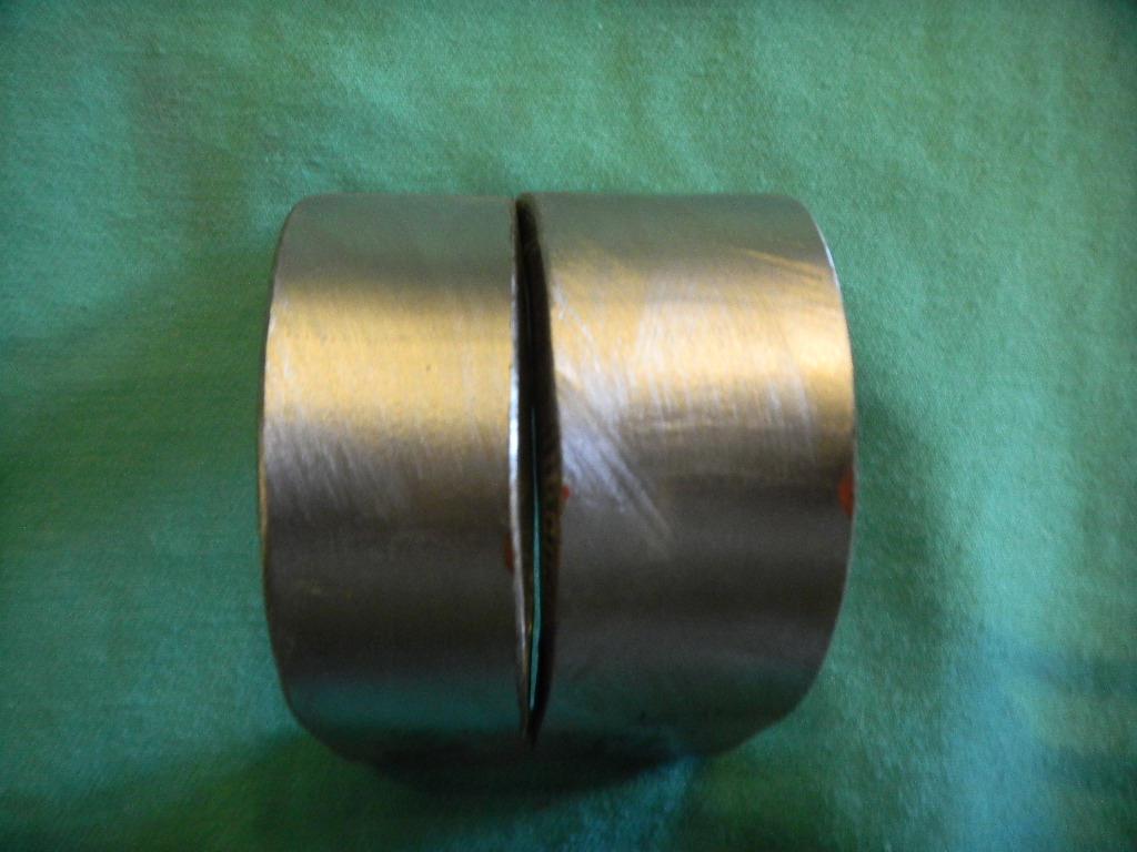

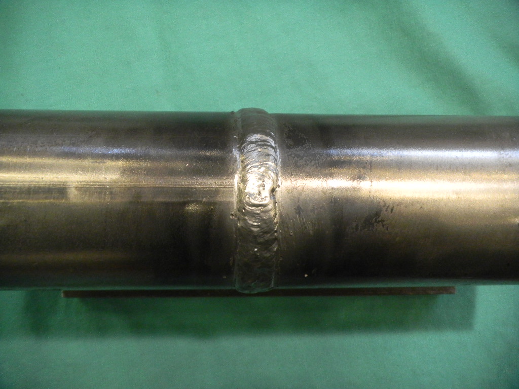

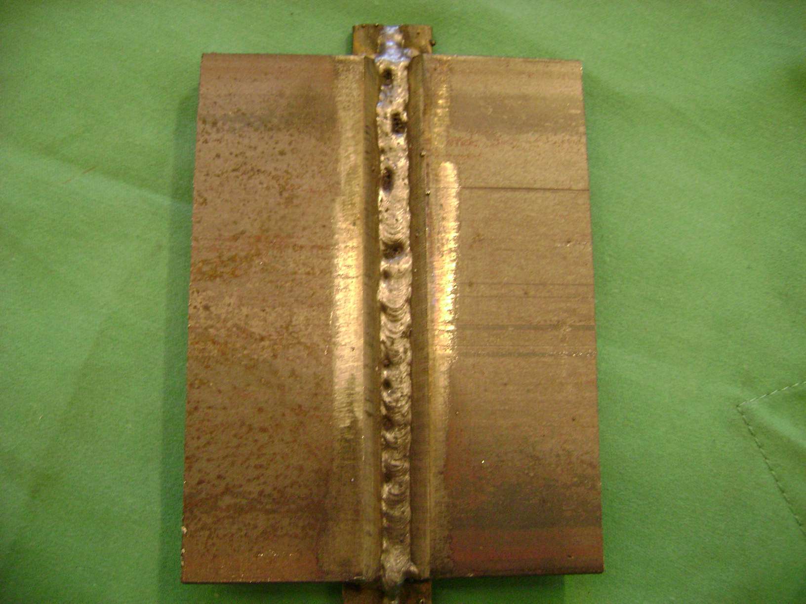

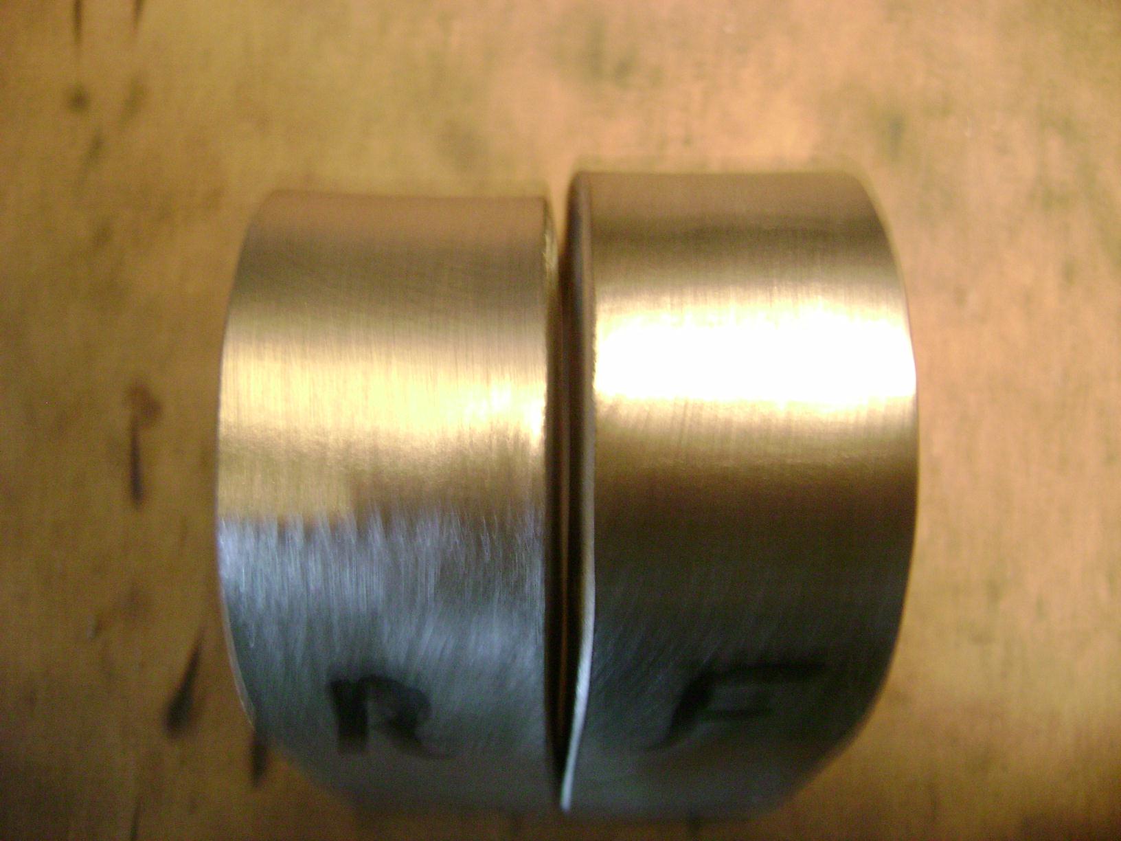

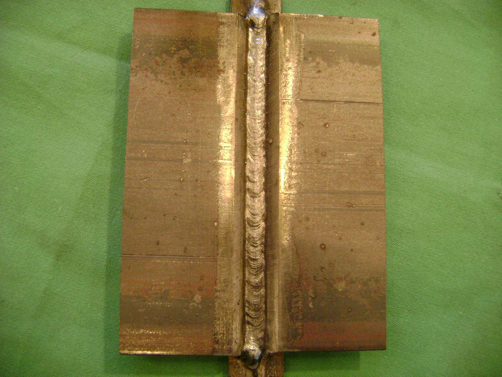

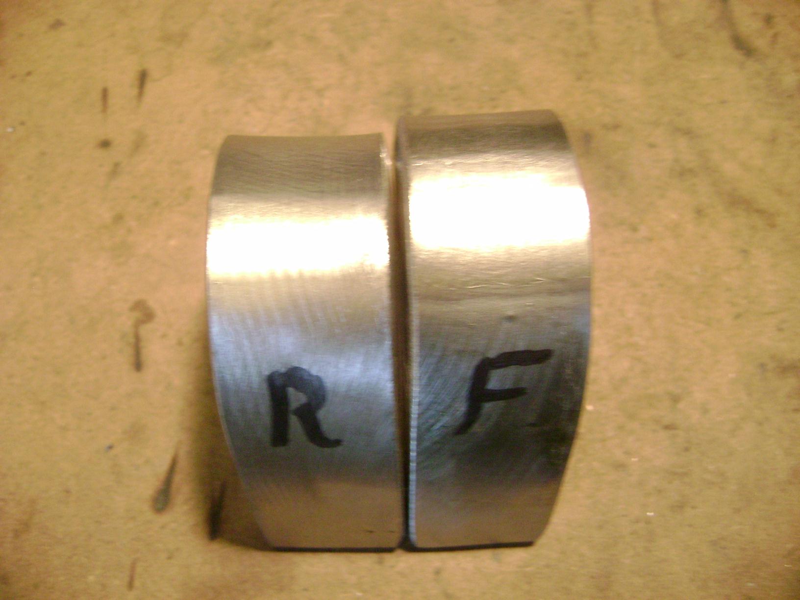

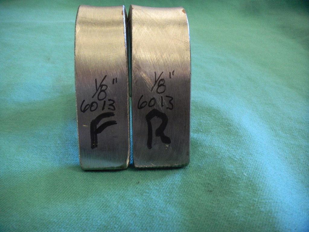

I think for the majority of the members here 6013, and 7014 will work great for anything they're going to do. I never seen 7014, or 6013 on a structural job. When I worked in a fab shop we had 6013 on hand, but we never used it because we had Mig machines. I never heard of 7014 until joining these tractor sites, so I bought some. WOW! Childs play to run, that stuff is cool! I'm not impressed with 6013 just because it has no impact quality.
But I did bend tests with both 6013, and 7014. Not a flaw in either one, for most of us here do we need anything more? I say use what ever works best for you, but I'm a 7018 guy, but that comes from spending my whole life on structural jobs, and that's all they will buy for you. True 7018 is over kill for just about everything, even on the job. I guess the reason engineers require it is because it is over kill, but I really don't know why, but I can't remember ever seeing a set of drawing where at least 7018 was called for.

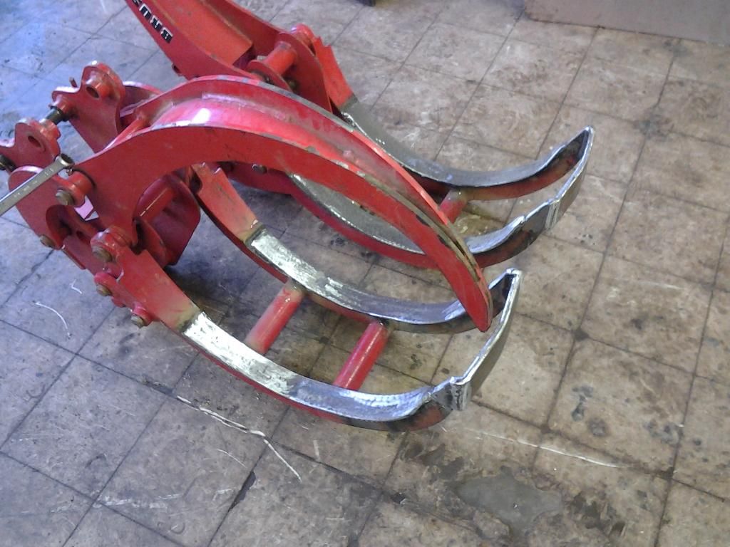

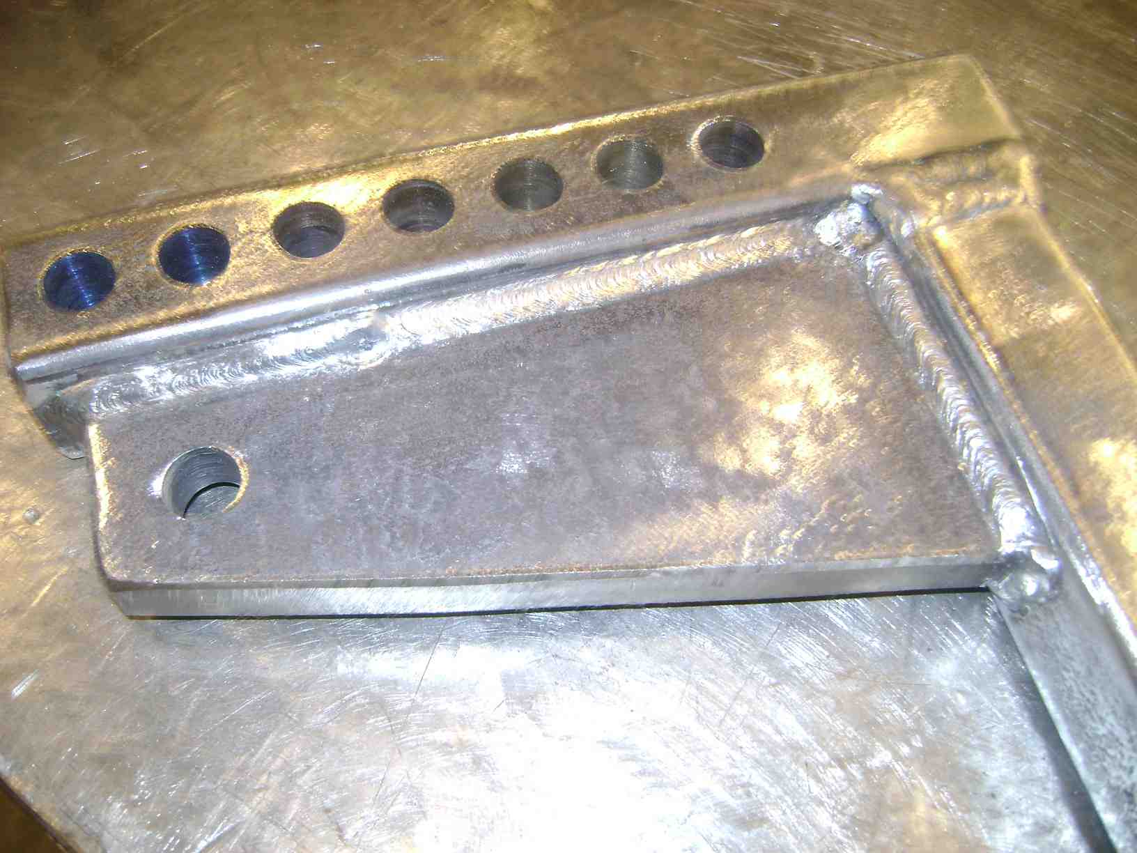

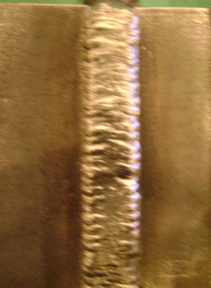

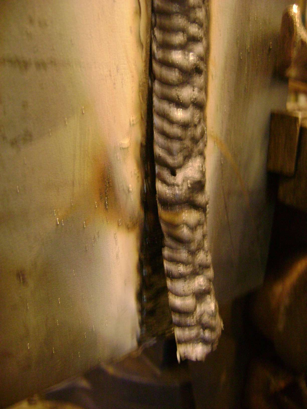

I never ran much 6013, never really gave it much thought until joining these tractor forums. So I bought some to give it a try. My first pass I ran it like I would 7018. Whoa! That was a mistake!:shocked: I learned right away you have to give it more angle. Once you do that, it's really easy to run.

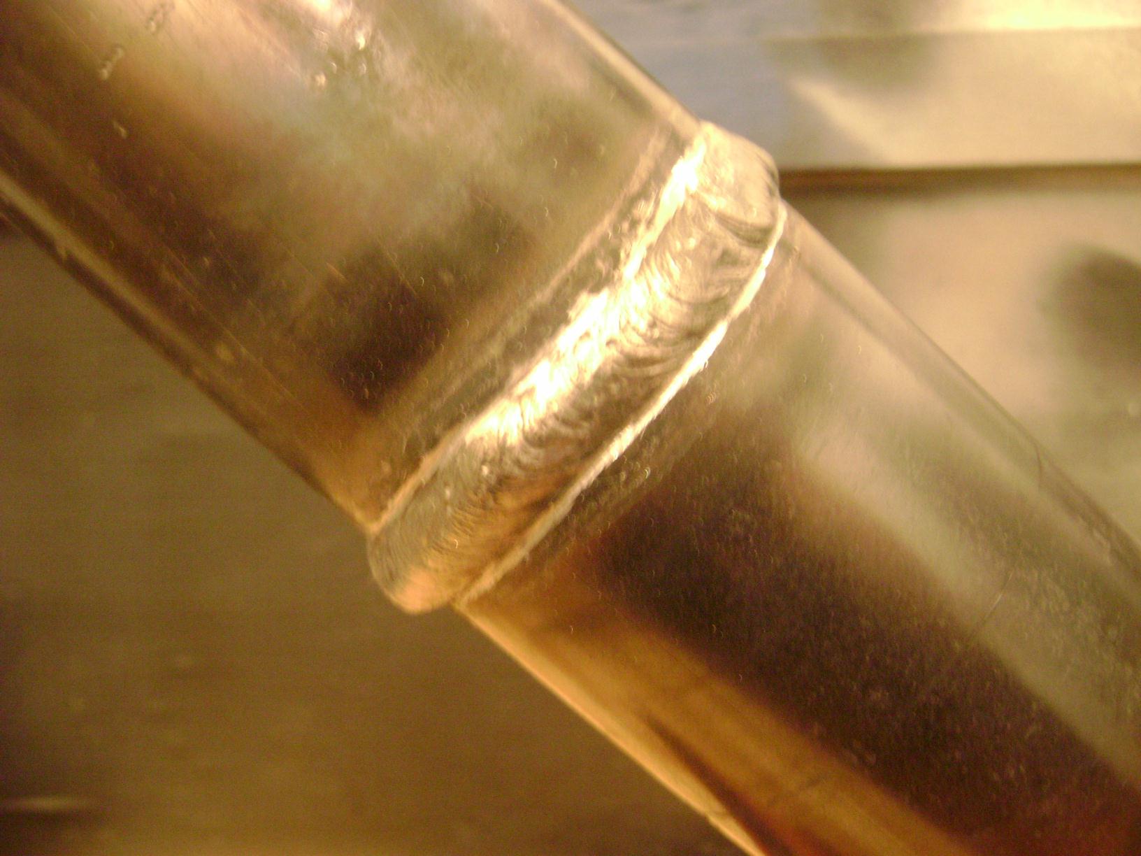

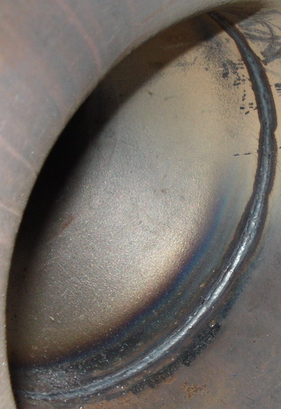

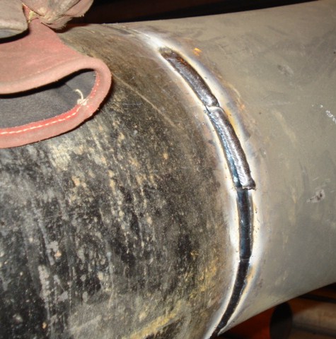

You know Dan I was wonder about that! There is a guy on a lot of the welding forums who lives in Northern Ireland. The guy is amazing with 6013, he works in a pipe fabrication shop. His welds are nothing short of inspirational to say the least. :cool:
