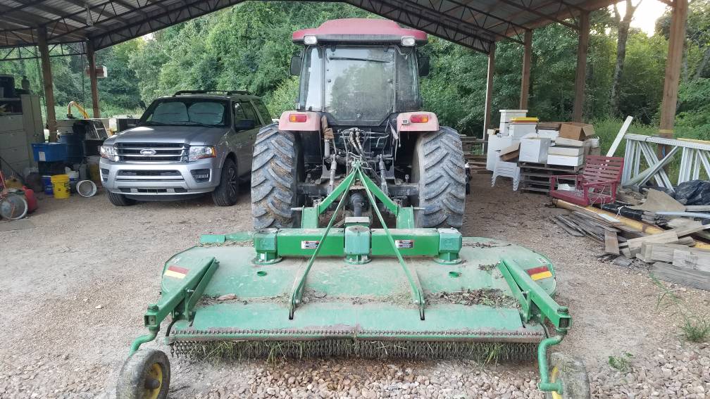

Have a 7' LMC med duty, grass & weeds around the yard are easy to keep trimmed with it. Big thick stuff does not mow well unless going slow.
Got a MX10 last year to speed up keeping trimmed around planted fields & brush cutting in edg of fields. Does not work around the yard.
Either one on 8560 Mahindra but 35hp tractor is a yard mowing machine with LMC 7 footer.20190902_190343.jpeg20170519_191855.jpeg
