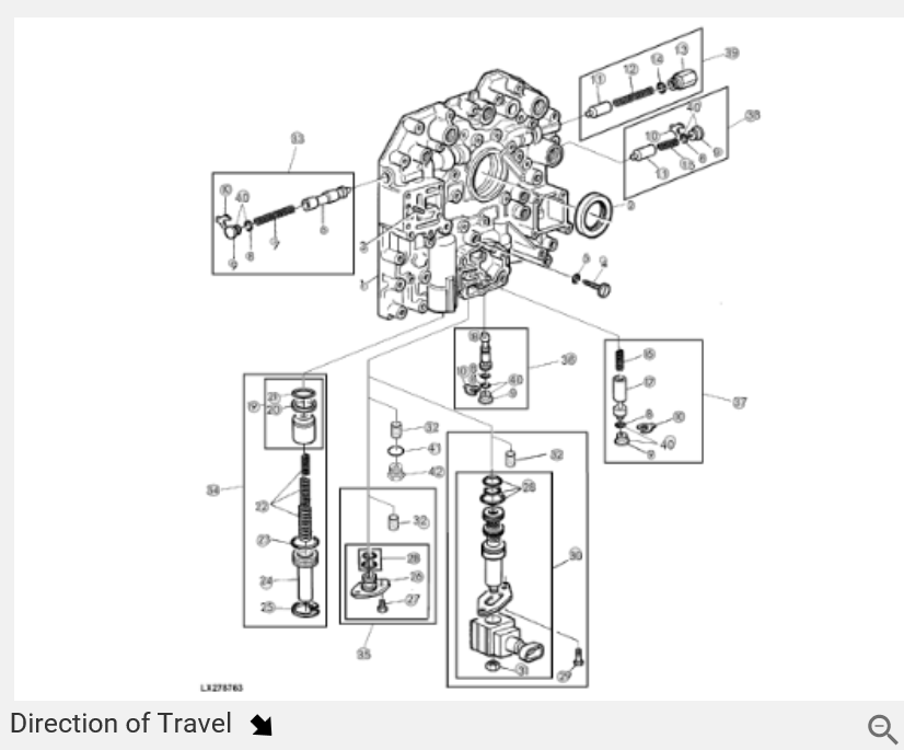

this is a JD 6400 fwa, power quad with right hand reverser. Just as the clutch is about to engage, the tractor jerks forward. it had a broken spring in the modulation valve and I also changed the piston but it did not solve the problem. If I quickly release the clutch the tractor pulls away smoothly. what do I look at next? Tractor has 12000 hrs, is clean and works everyday
/ 6400 jerky clutch #2

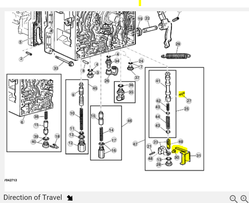

Does tractor shift forward to reverse and reverse to forward smoothly without using the clutch? If so, I suspect the clutch valve may be sticking in the bore. you need to remove the front cover on the transmission to inspect it. I had one that link 49 was worn crooked and was binding on guide 31. Replacing the link and attaching pins 27 and 30 cured the problem.

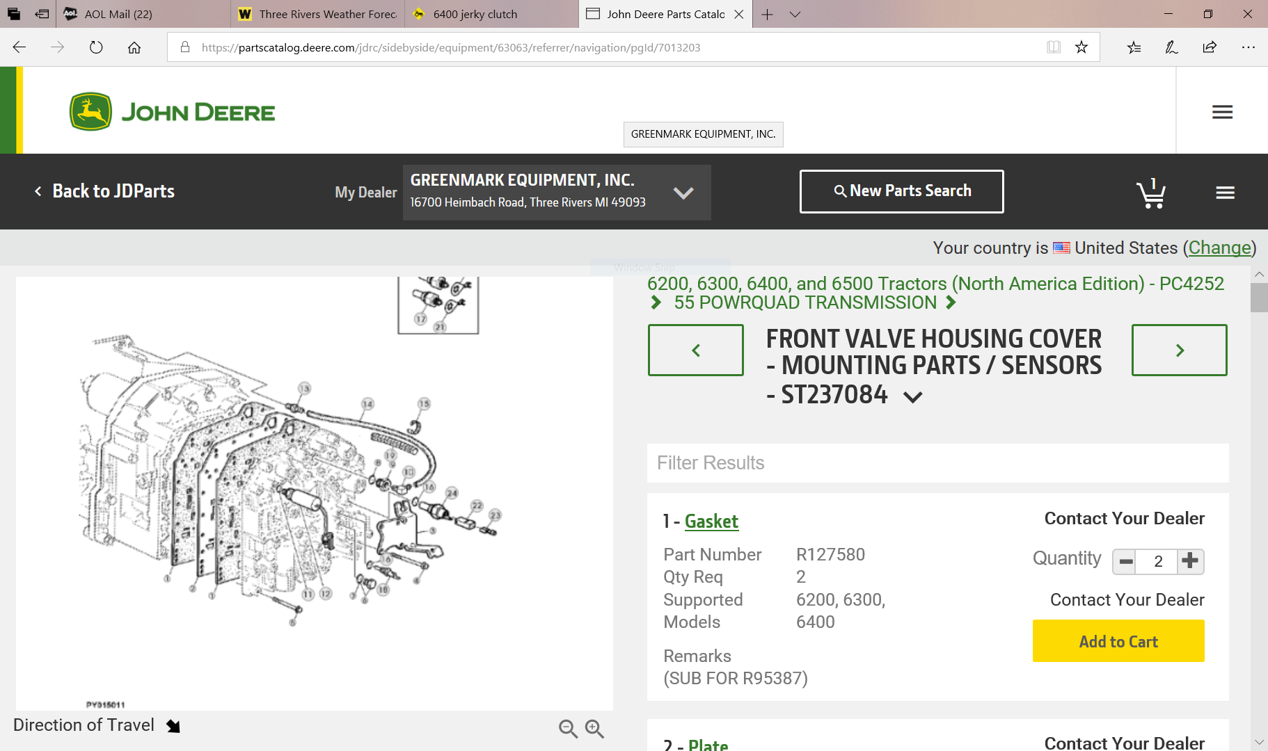

TRANSMISSION FRONT COVER - ST237081 is where I'm looking at JD parts.com. Is the linkage external?

Looking at JD parts catalog, it looks like you have to remove the front cover to get to the parts he mentioned (27, 30, 31, 49). I would say you have to drain the transmission.
I am not sure what you mean by is linkage external. It looks like arm 20 to shaft 22 to internal part 23 which connects to link 49. Arm is external rest are internal. I assume clutch cable connects to arm 20.

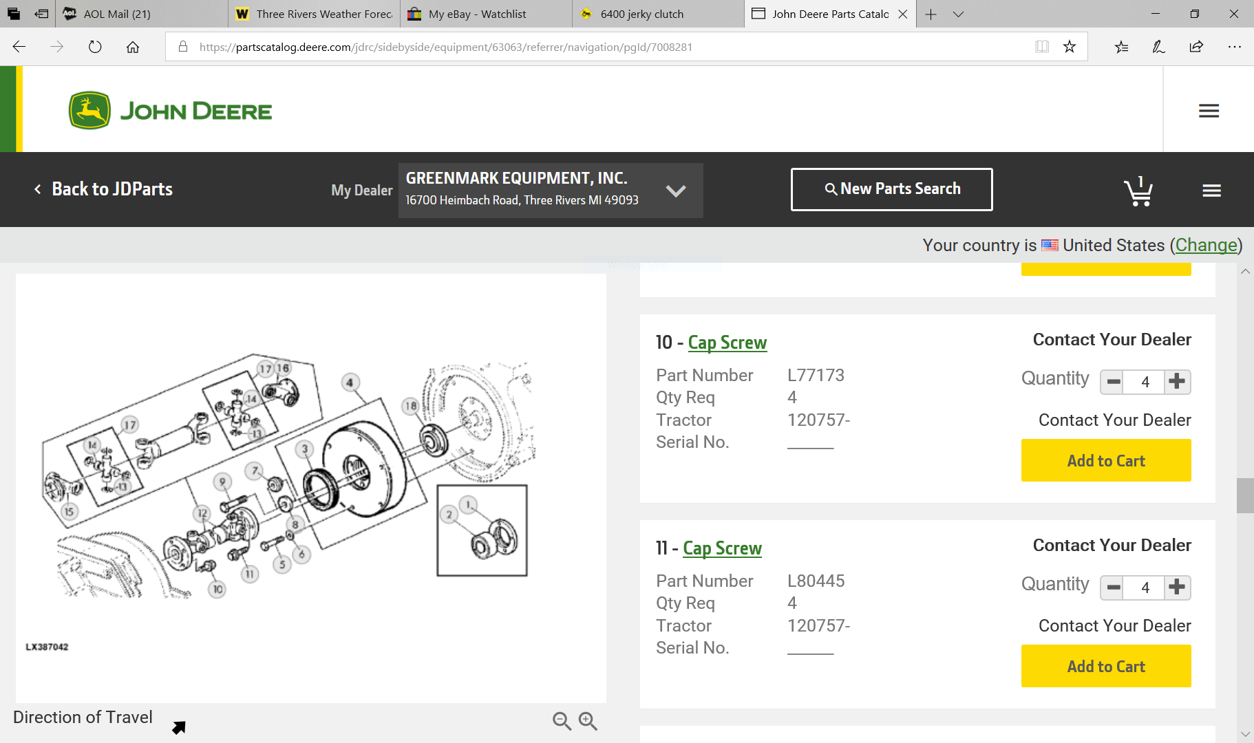

I have NOT done this job, BUT looking at JD parts it only looks like there is plate with gaskets both sides behind the front cover.
IIRC the cap screws that hold the drive shaft in (4 front, 4 rear) are "one time use". They have serrations on the under side of the head.
Key 10 and 11 in the drawing.
