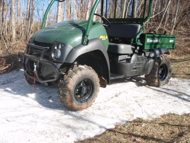

ANOTHER NEW MULE OWNER HERE...Just thought I'd chime in here. As with Toy, I'm a new Mule owner, and new to UTVs. I just bought a used 2008 610 Mule with 30 hours. It came with a Warn winch, top, 2"lift, upgraded tires and wheels, trailer hitch, brush guard, for $6k. I sold my tractor, a MF 135, and a golf cart to fund the Mule. It will replace both. Later I"ll add a snow plow and windshield. I'll prolly make a windshield myself. So far I"m tickled with it. I found it a bit noisy at first, but gettting used to that. Here's a pic on the last bit of snow on our property.
