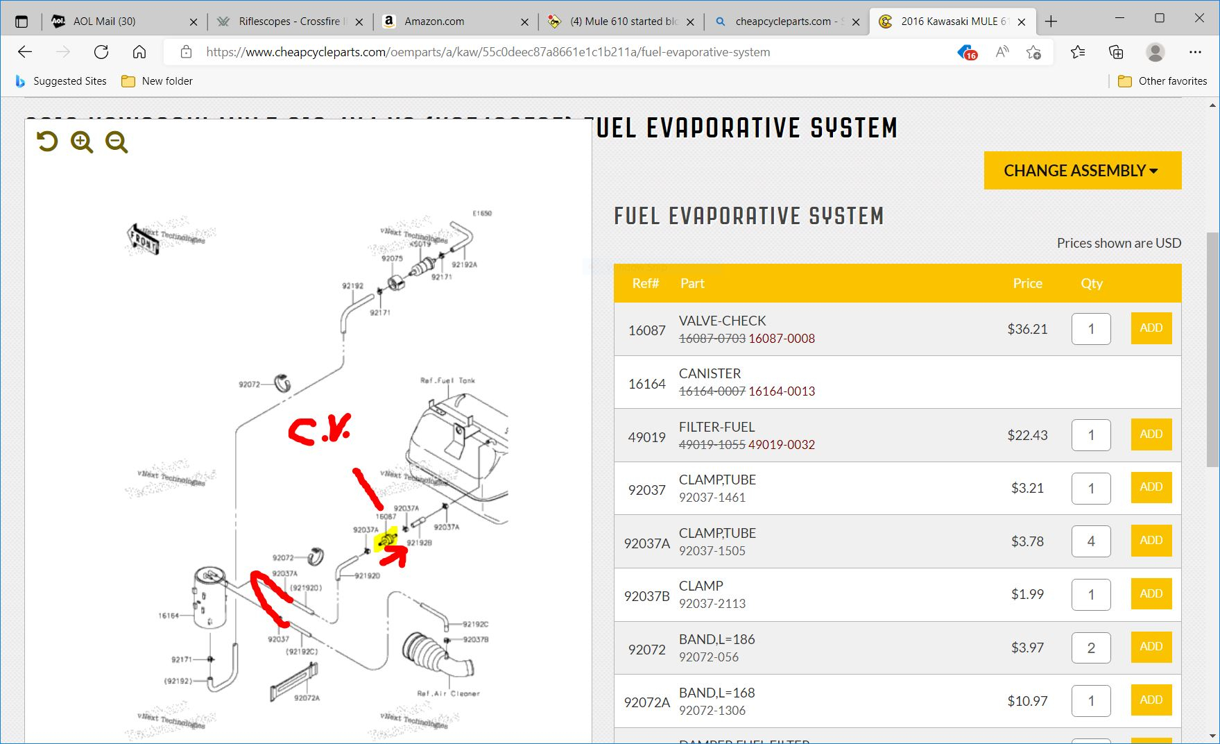

anyway today, drained the oil, looked at the fuel pump and it was bad so installed a new one tank still pressurizes if left for half hour so the tank has two hoses coming from it, front goes to filter then pump, the other has a short hose then a plastic (sort of valve) then to the charcoal canister, canister has 2 hoses on top onw from the tank the other to the intake manifold, there is another larger hose off the bottom runs to the tank area with a fuel filter to prevent dust entering then open below the seat.
all lines are clear after the odd plastic valve, no idea what it does but it has a red end and black body, as it is it allows free flow from the canister to the fuel tank but restricted flow from tank (hard blowing with my mouth) to the charcoal canister, Im guessing it should vent the tank pressure but it is not.
trying to find one of these valves, dealer has it backordered till June, has no idea how it works or what it does, removing it the fuel tank does not pressure, unit will run 75% throttle for a half hour but full throttle it bogs down and dies has a distinct odor no smoke but when you slow down and let the fuel catch up, if you open the gas cap it runs 75% no issue at full throttle after a few mins it slows maybe 10% and will continue at that no issue.
anyone know what this valve does, by chance anyone got a mule with one of these on and willing to take it out and see what direction or flow it gives?

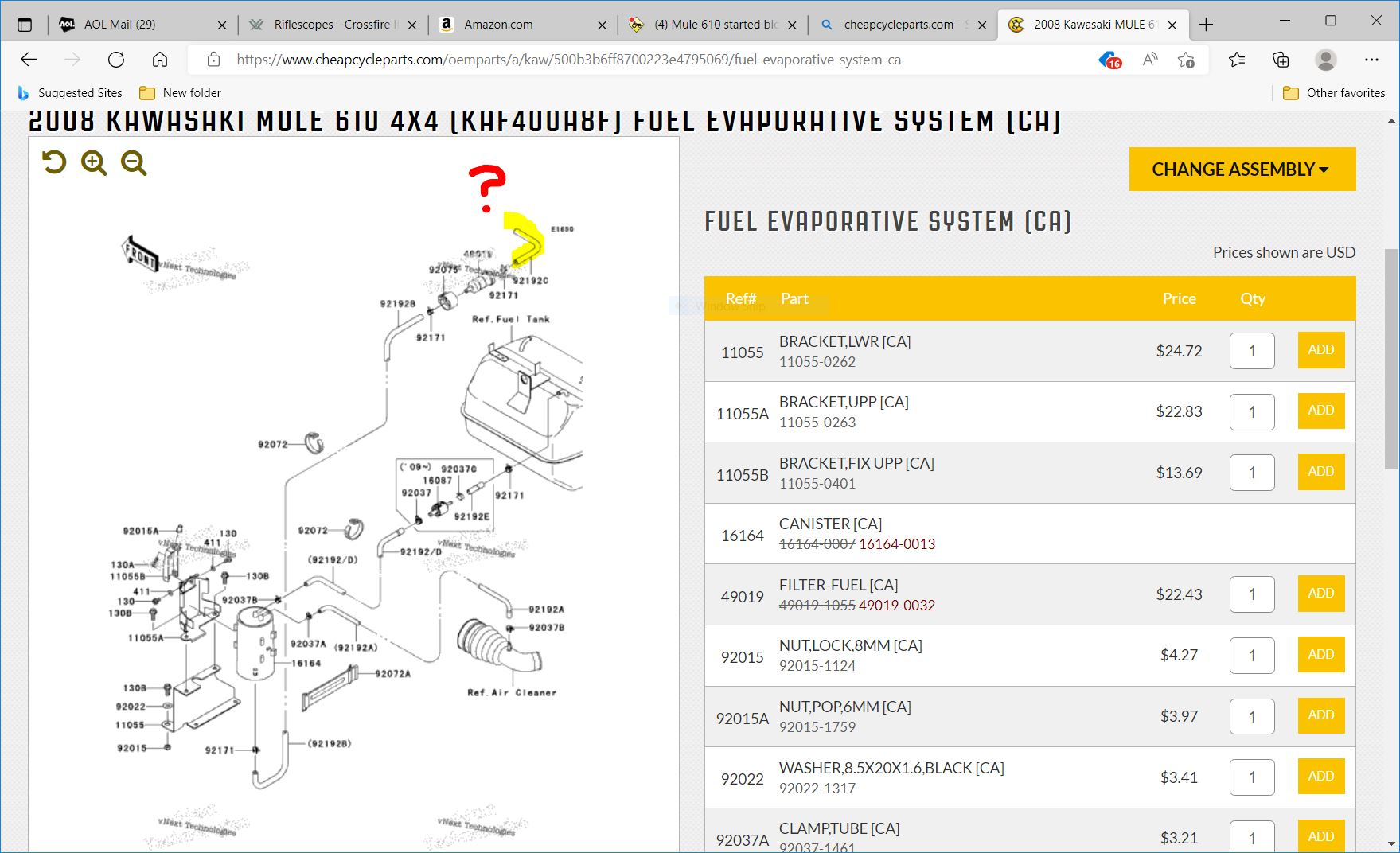

California versions have the cannister. The fuel system has sealed fuel cap, not vented. The cannister is for emissions/prevents fuel vapor getting in the air. The plastic valve, black, red end is a check valve. I am not sure which direction it goes. You mention another line from the cannister with a filter in it. Where does this line go?

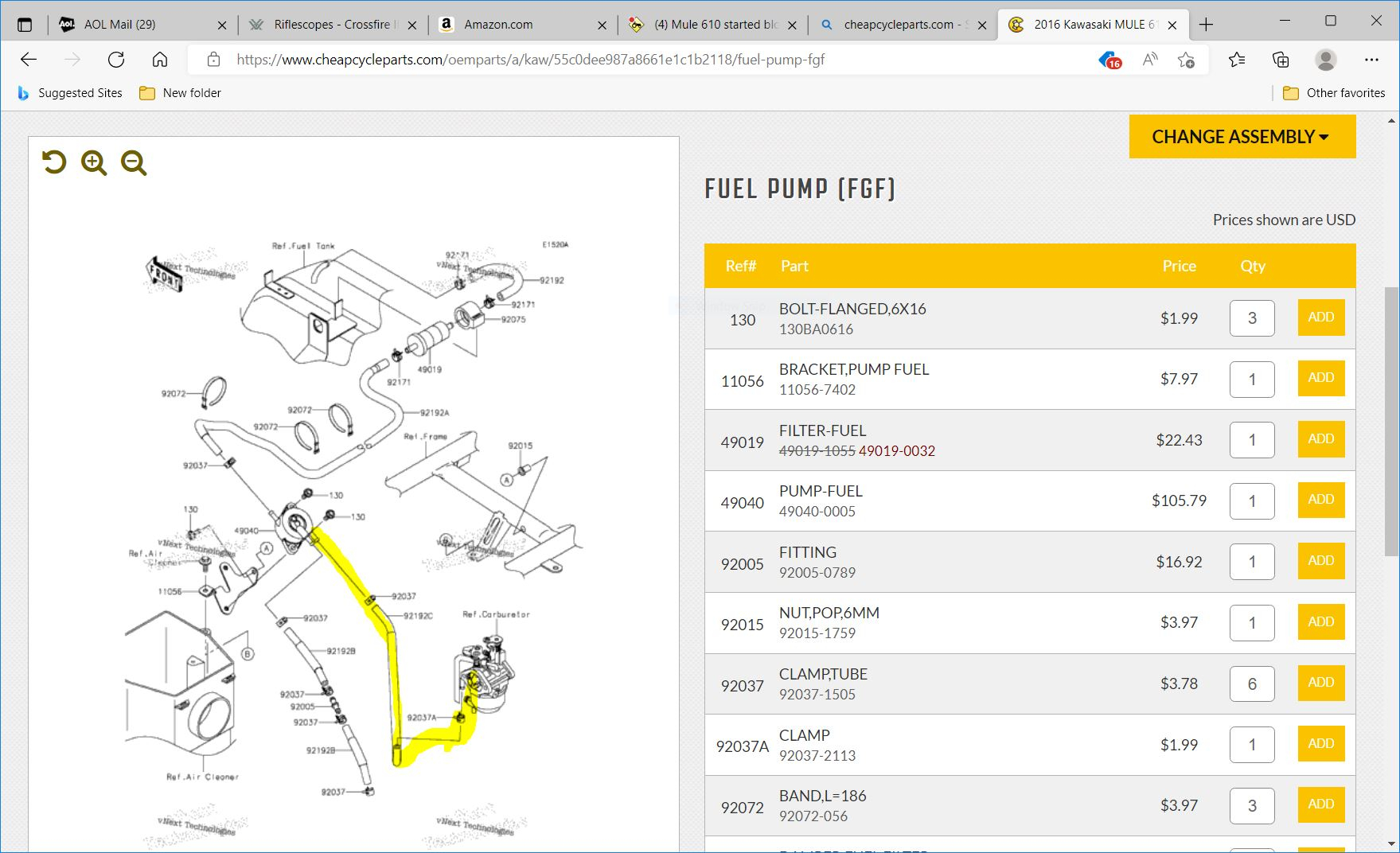

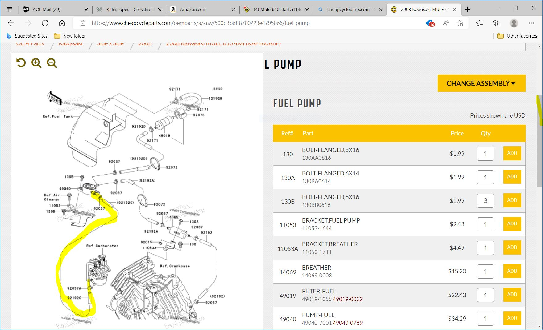

What year is your Mule? Parts drawings show different fuel pumps for different years and also hook up looks different. Some lowest fitting goes to tank, others to carb. Maybe you have the wrong "new" pump?

As test, I would connect the hose from the air intake that goes to the cannister to the hose from the cannister to the check valve, to the fuel tank. I would position the check valve to allow flow into the fuel tank. This will bypass the cannister and filtered air would be able to enter the fuel tank as fuel is being used.

the connections on canister never have changed, one goes to the intake, one has a hose and goes over the fuel tank, has a fuel filter then a hose thats open sitting between fuel tank and front right of seat panel, assume its a breather.
as for the fuel pump, its the right one from dealer, identical the original pumped fuel but allowed it to flow back I could blow air both ways inlet to outlet, the new one only one way
Im still leading to that check valve, this one free flows air to the tank but needs pressure to go from tank, its what is holding pressure in tank, eta for a new one is 3rd week June

You need to find out how/why the fuel tank is being pressurized.
Only two sources. The cannister or fuel pump.
If you disconnect the cannister at the check valve, the check valve should let the tank take in air as the fuel is used, but not allow air out. If the tank still becomes pressurized, it has to be the fuel pump. If not, problem is with cannister system
