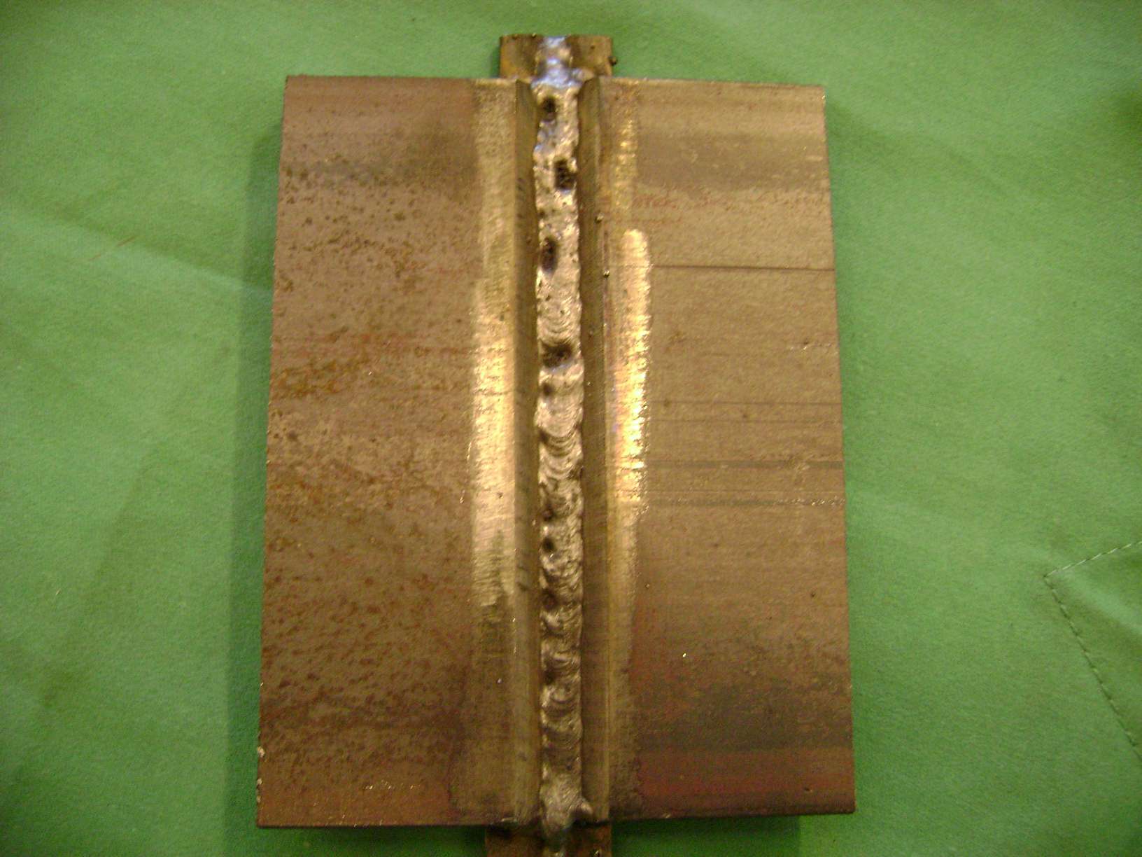

I was at the local ACE hardware store yesterday, they had some Forney 6013.
I ran a V-groove test plate this morning.
1/8-inch 6013, 115-amps for the root pass, 110-amps for the remaining.
I cut the coupons a little differently so you guys wouldn't think I was using other test coupons.:laughing:
The face coupon has a very small flaw, less that 1/64th of an inch.

Looks great. :thumbsup:
What thickness bar stock is that?
/ 6013 test results. #3
the bends looked good, no tearing at all.
nice Job

Looks great as usual. 6013 has been called a sheet metal rod. But I have used it to reweld ball ends on to 3 point hitches, without so much as a single small problem when put under full load.

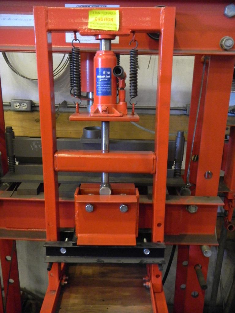

Love the bender. Got a wide view?

Mark I can't ever remember running any 6013 on the job. Year or so ago I bought some Lincoln 6013 at Lowes, didn't like it at all. See? Now this Forney runs 1000 times better than the Lincoln I got!
I just through that bender together, nice to have an ample scrap bin, all I had to buy was four 5/8-inch flat washers.

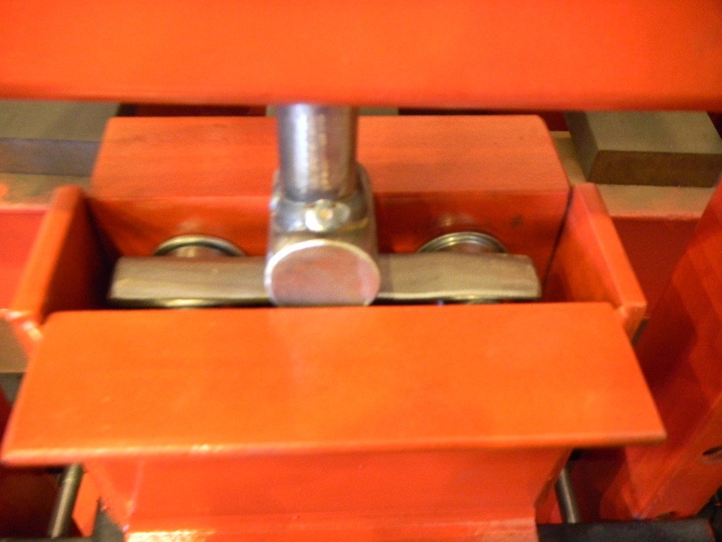

Nice, simple setup on the press. Is that cylinder rod you are using for the press ram?

I bought that small press for a key way broach I have. The bigger press in back you just don't have any feeling with it when running the broach. I just used a piece of 1-inch cold rolled, with 1 1/2-inch cold rolled welded to it for the upper die. Made a new cross arm, because this one is trapped in it. Used some scrap C-channel, and the two 1 1/2-inch dies out of my Harbor Freights compact bender for the bottom dies / rollers.

I would be interested in some up close photos of that press jig for bending the coupons. Looks like something I could fab up rather cheaply for my 30 ton shop press. Have been searching the web for a design to use that utilizes scrap pile materials in lieu of buying metal.
Theres really not much to it. Some 6-inch C-channel, two 5/8-inch bolts and nuts, four 5/8-inch flat washers, Some flatbar welded to the ends of the 6-inch C-channel. The two 1 1/2-inch dies from the compact bender worked perfect! That way I didn't have to drill holes through the 1 1/2-inch cold rolled I have.
