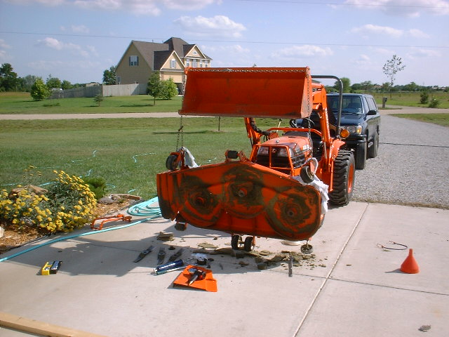

Thought this thread as good a place as any to post pics of MMM maintenence. Also, prompted by this thread I thought it time to look at the bearings to see what condition they were in. Unfortunately my wife was gone so once my hands got really dirty the pic taking ceased--oh well.
Here is pic of the 60 MMM being hosted by the FEL. J

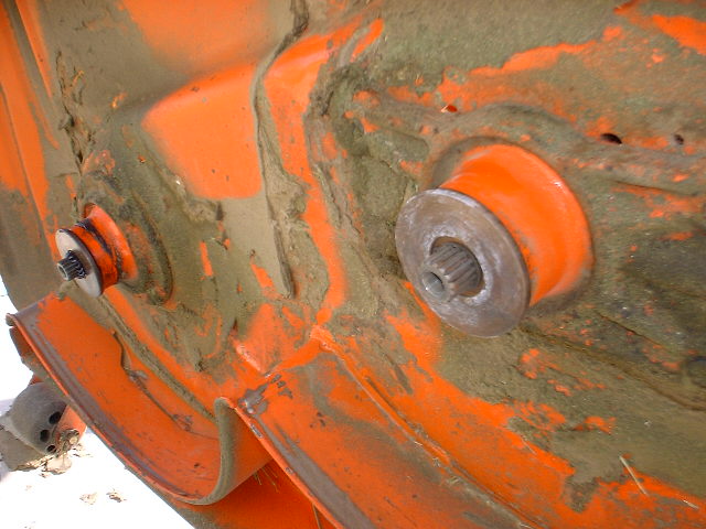

Re: 60\" MMM Grease Zerks
I sharpened the blades and then scrapped and pressure washed the deck. I also greased it /forums/images/graemlins/shocked.gif. I observed the grease flowing out with the dust covers removed. Notice the center spindle is dry. J
/ 60" MMM Grease Zerks #43

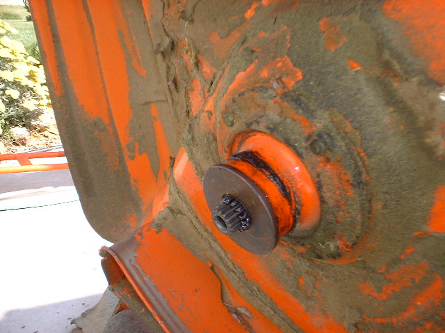

Here is the pic of one of the outside spindles, notice the squeeze out of grease. The center bearing was not getting grease in sufficient quantity in my opinion and does show wear. The other bearings are in tip top condition, only normal wear. Repeated pumps into the center bearing had squeeze out on top but none outthe bottom until I had a cup or more of grease extruded on top--that bites. J
