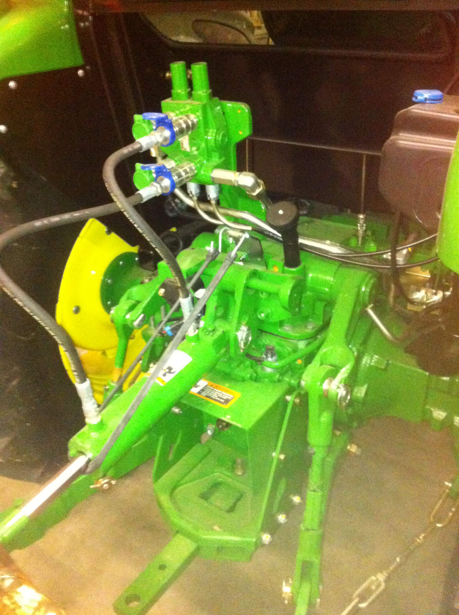

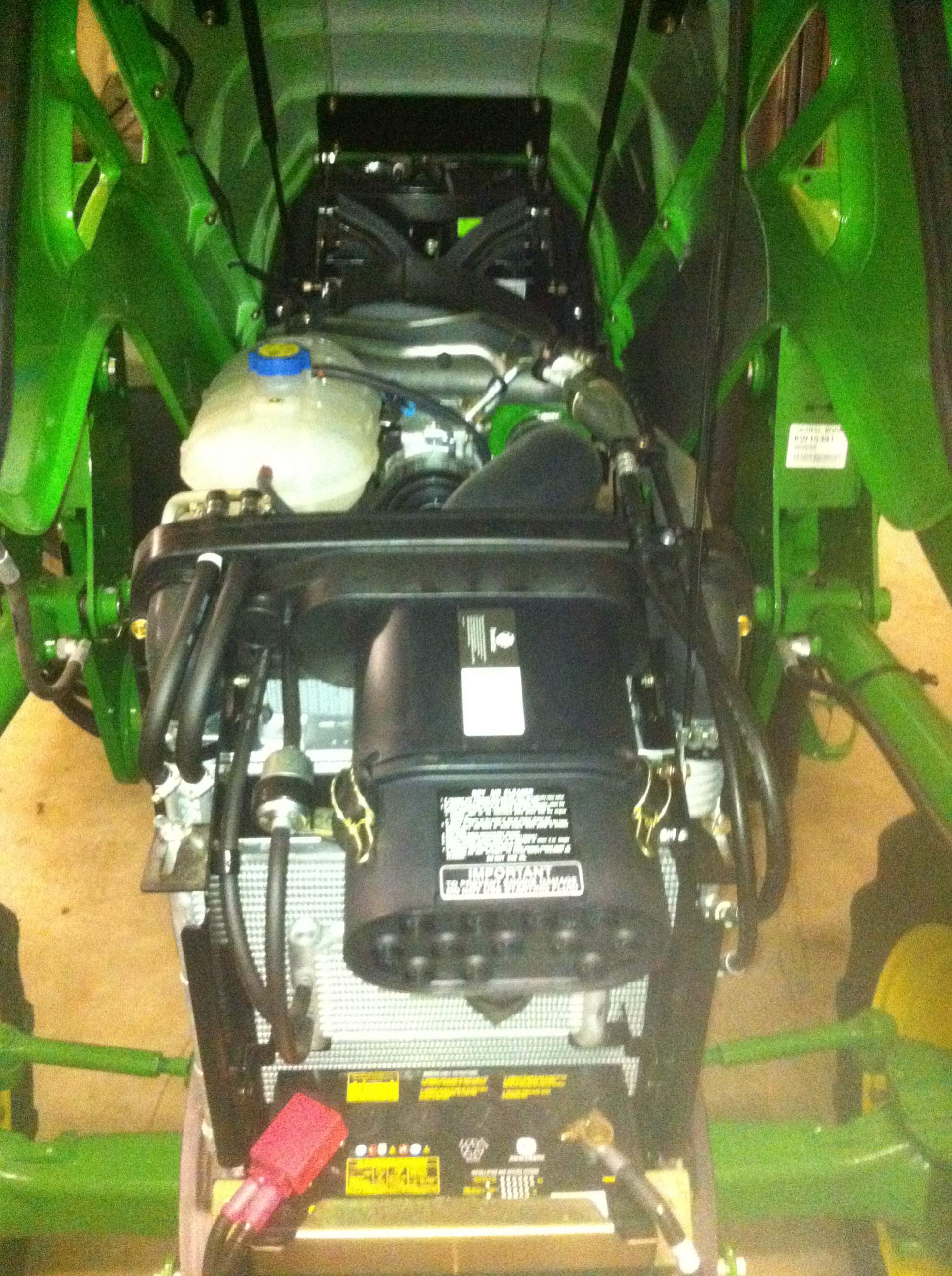

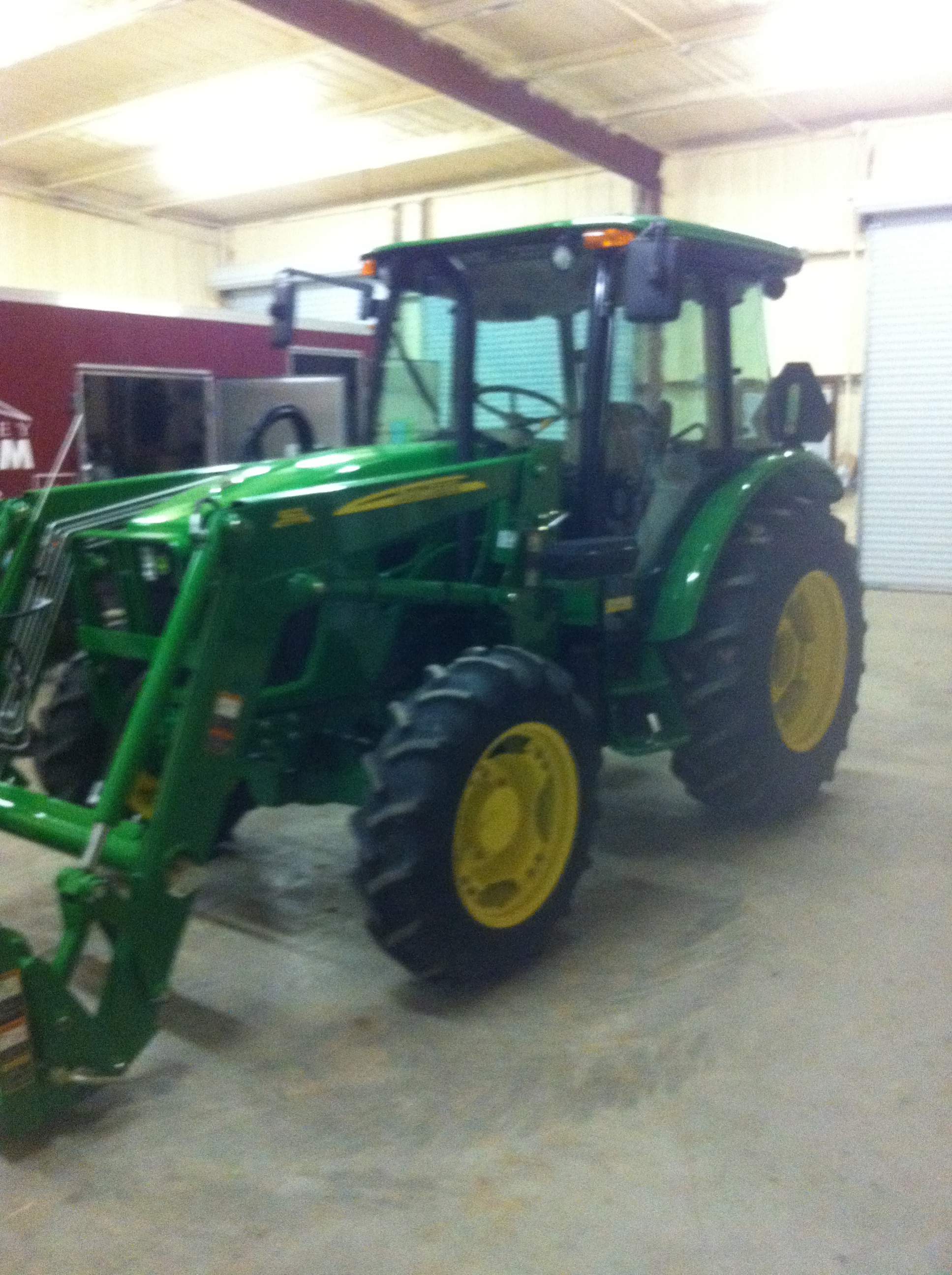

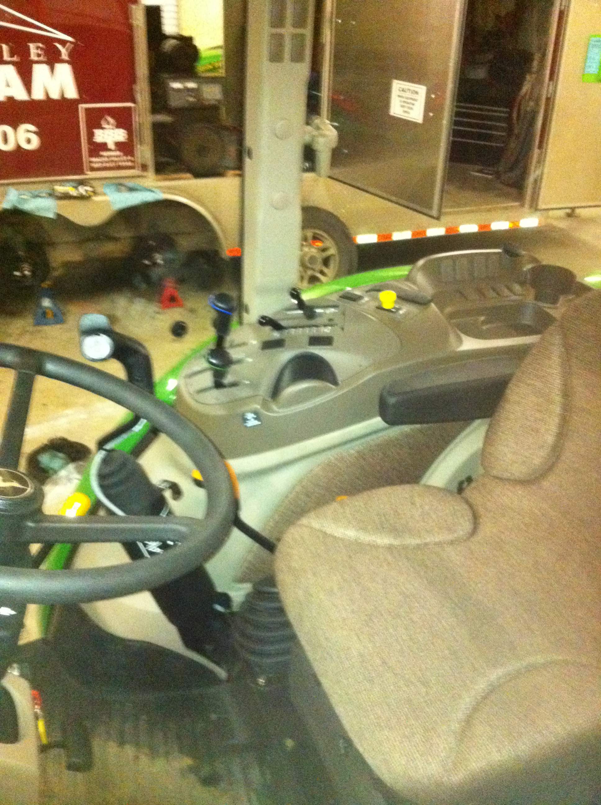

I had a 2010 5083e and traded up to the MY2012 5083e a couple weeks ago. All the creature comforts that seperated the M from the E in 2010 are fixed in the MY2012. Except for electric 4x4 activation and throttle, the cabs are essentially the same. The E now uses a console where it previously had the levers coming through the floor. The only reason I would go with the M is if I absolutely had to have the frame it comes with, and for the price I'd go with the 6030 series.
Make sure you are looking at the MY2012 with the green frame and not the black frame because they are very different. At first glance you will swear you are looking at an M.
BTW, not all M tractors use the common rail injection system.
