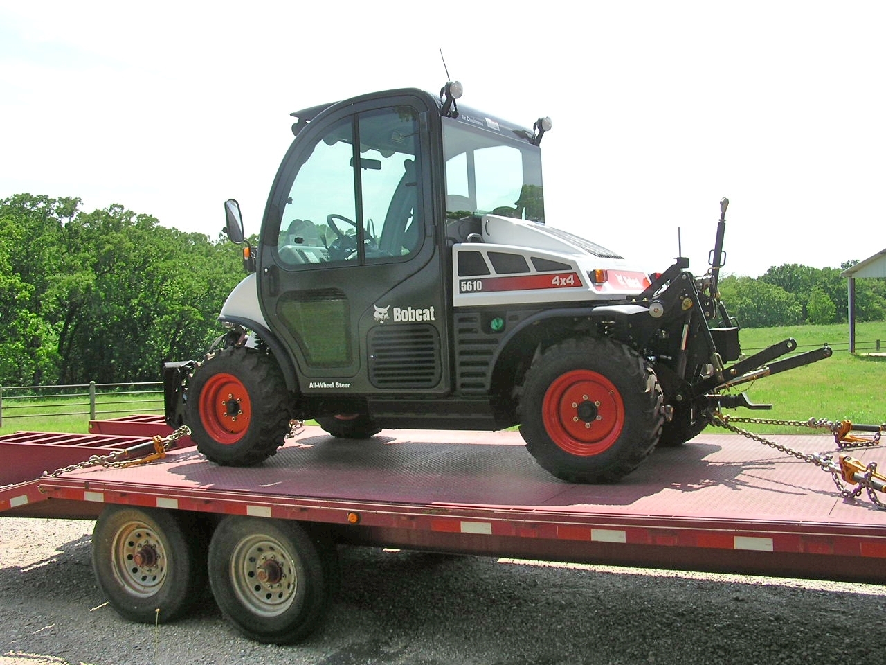

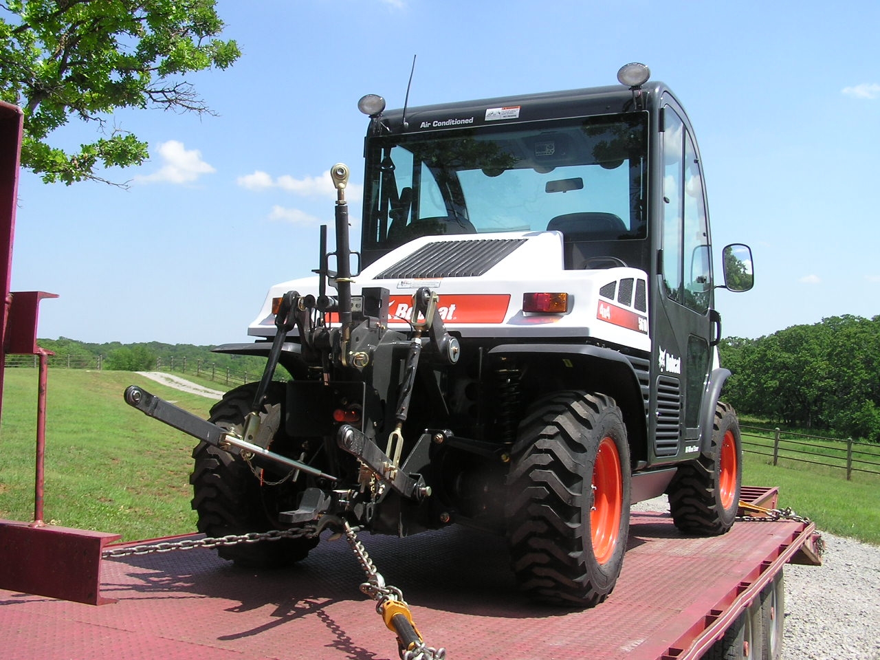

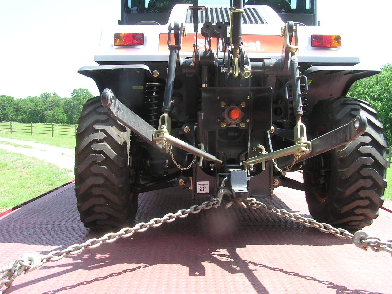

True for tractors. Not a problem for Toolcats:

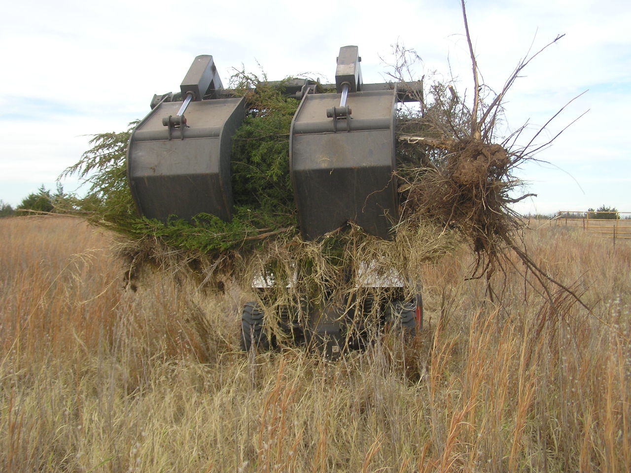

I have used my TC for pulling trees and pulling neighbors stuck cars. I have used the 3pt, receiver, and the front tow hook. If there will be a side load, I'll try to use the receiver or front hook because they are a solid attachment. When pulling trees, I like using the 3pt so I can raise the trunk to keep it from digging in. The biggest trees being about 18" diameter. The front hook allows you to see what you are pulling.

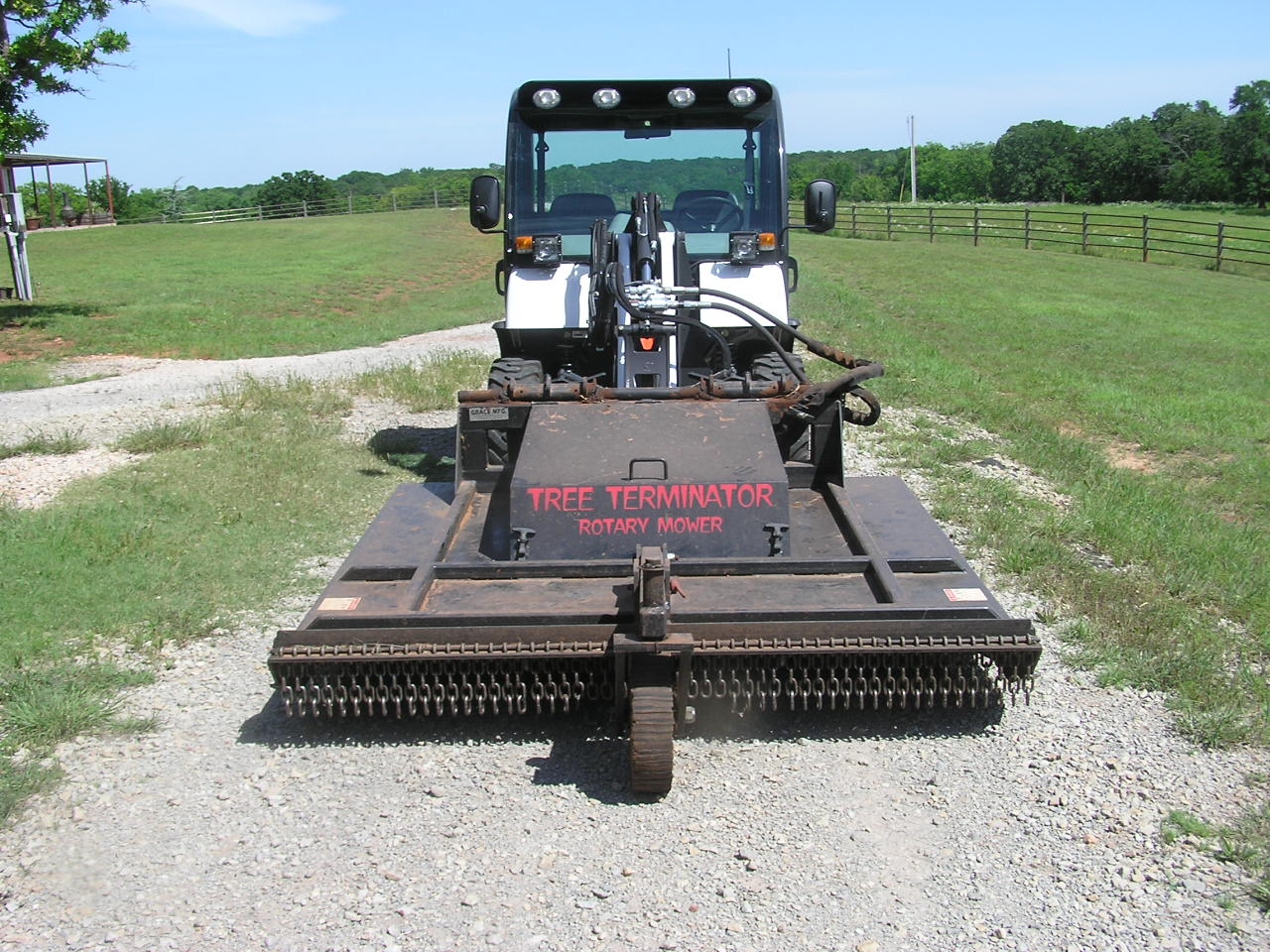

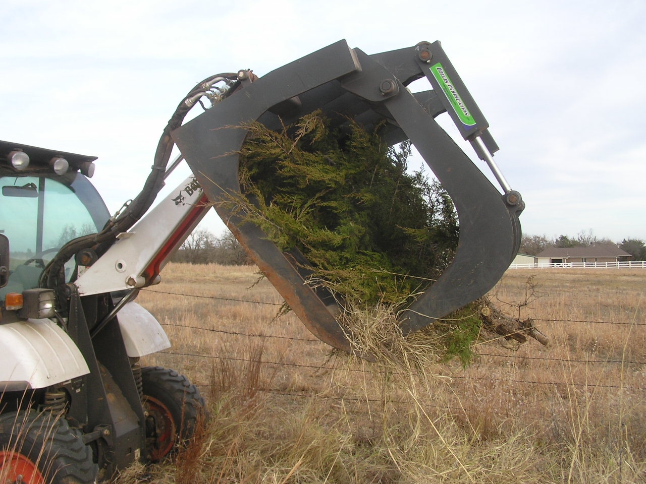

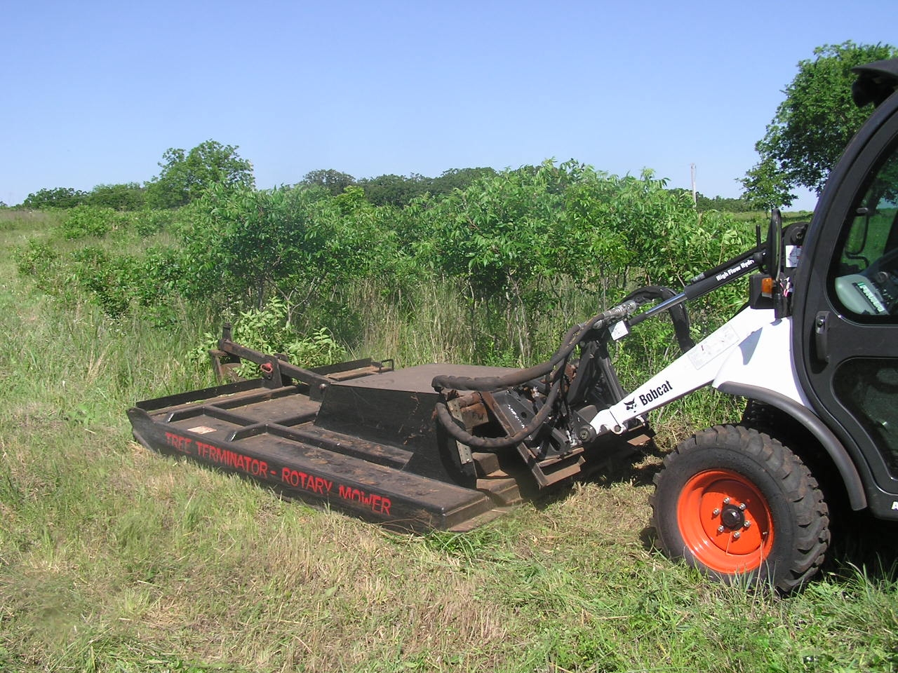

If you say so.. Looks to me like the pictured one is a bit shy on remotes as well.
I use the aux hydraulics on the lift arm.

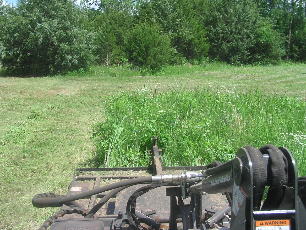

The 7' brush hog:
The view from the seat:

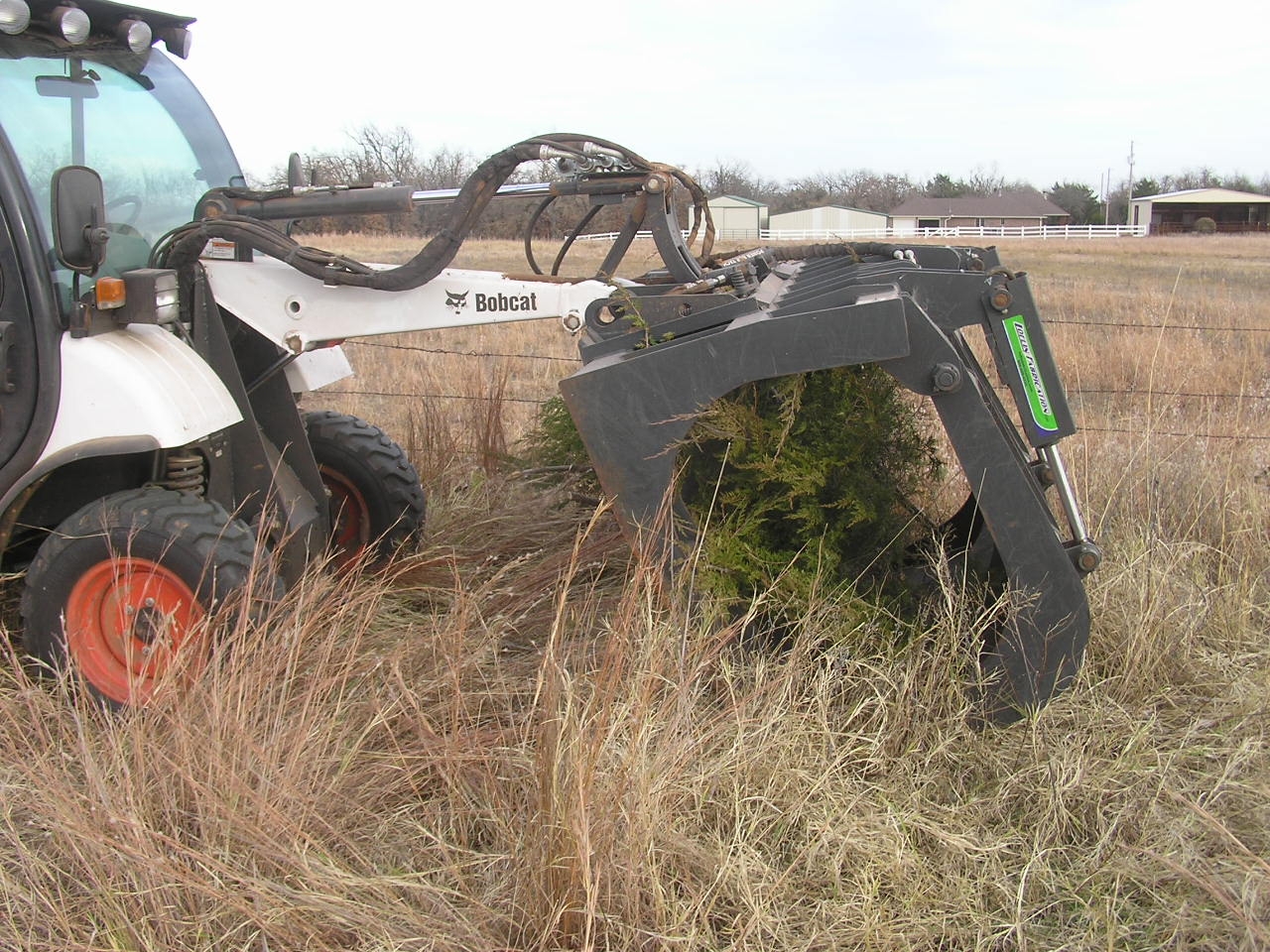

And for the grapple:
