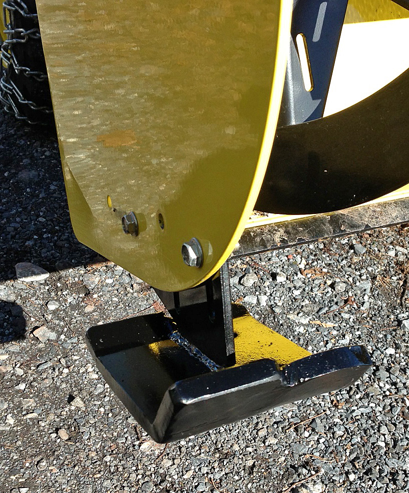

I'm in the process of modifying my snow blower shoes as they seem to dig into my gravel a lot. I am going to add another identical piece of 2 1/4 x 8" x 1/2" flat bar to the side of the existing runners - effectively doubling the surface area. I plan to get started on it this weekend. I hope it helps.
I wouldn't mind seeing a photo of the new shoes you had made.

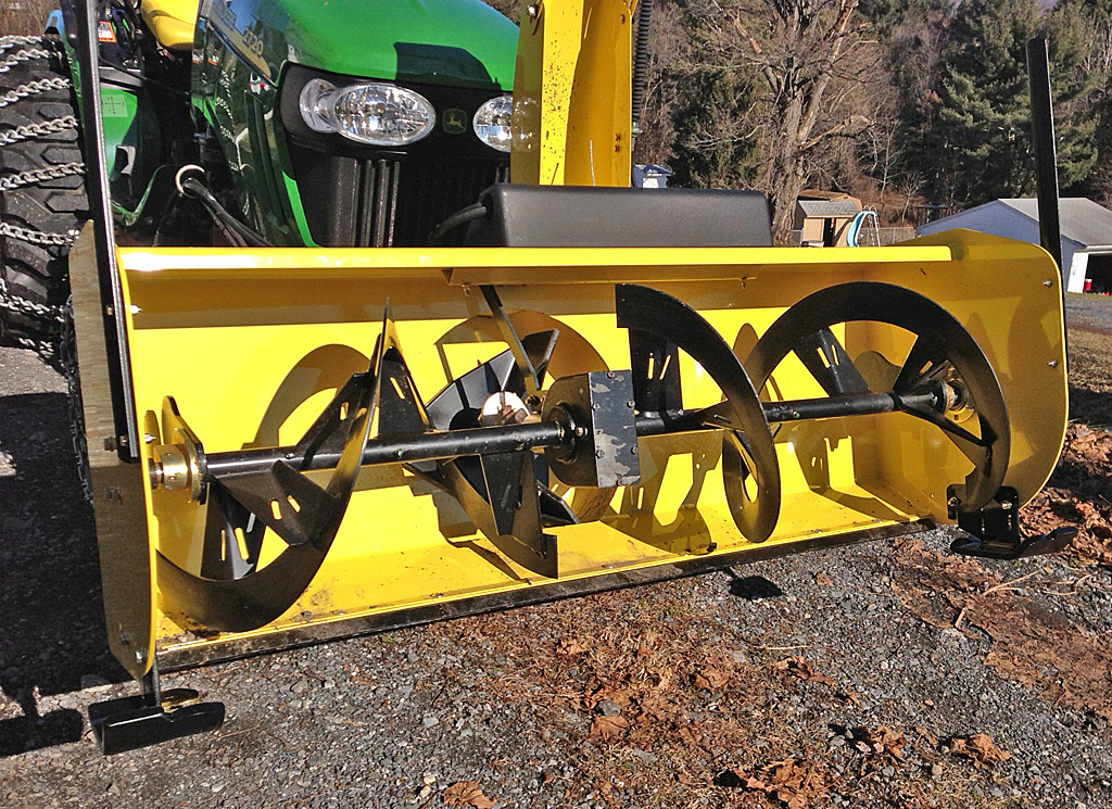

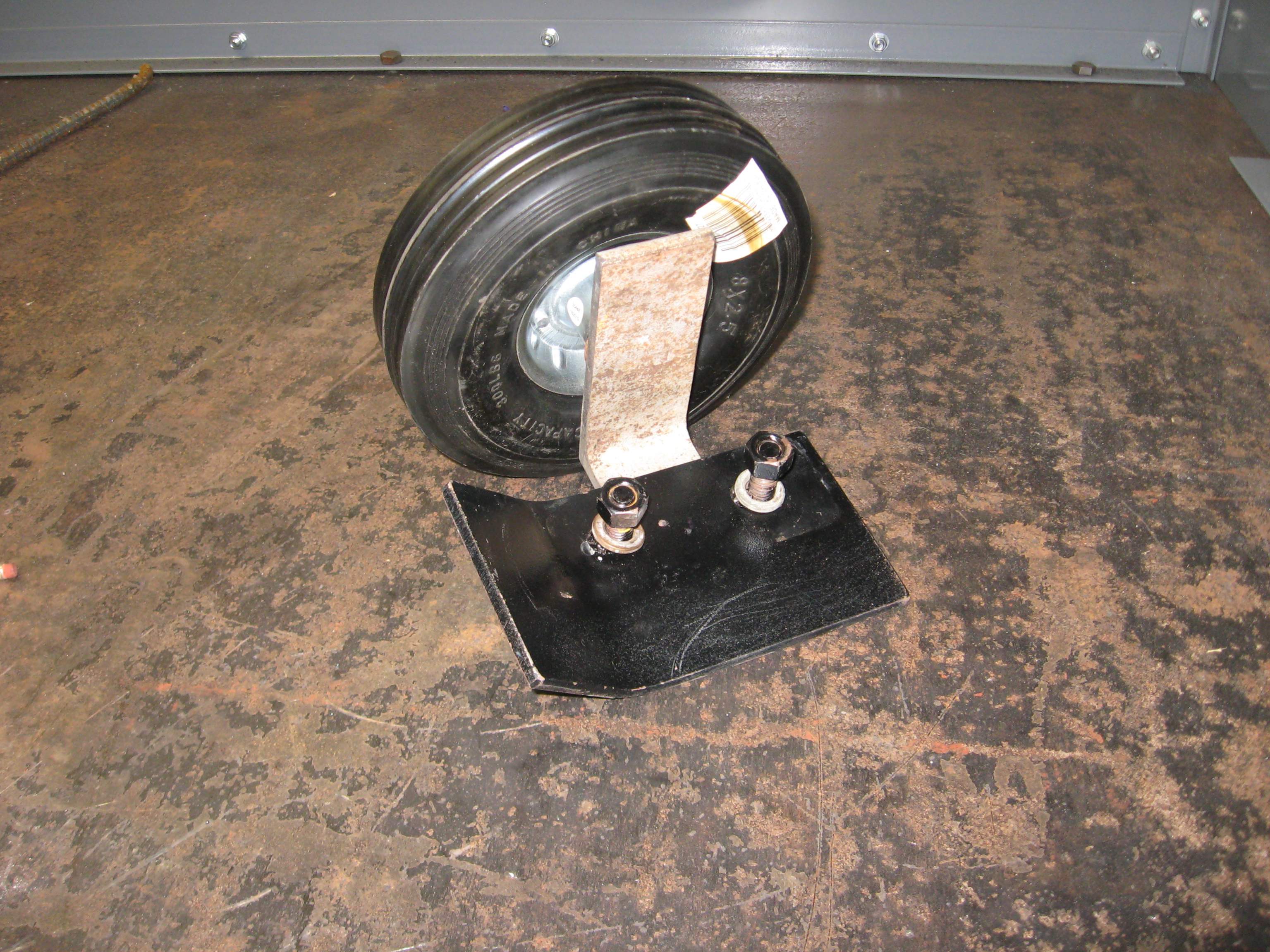

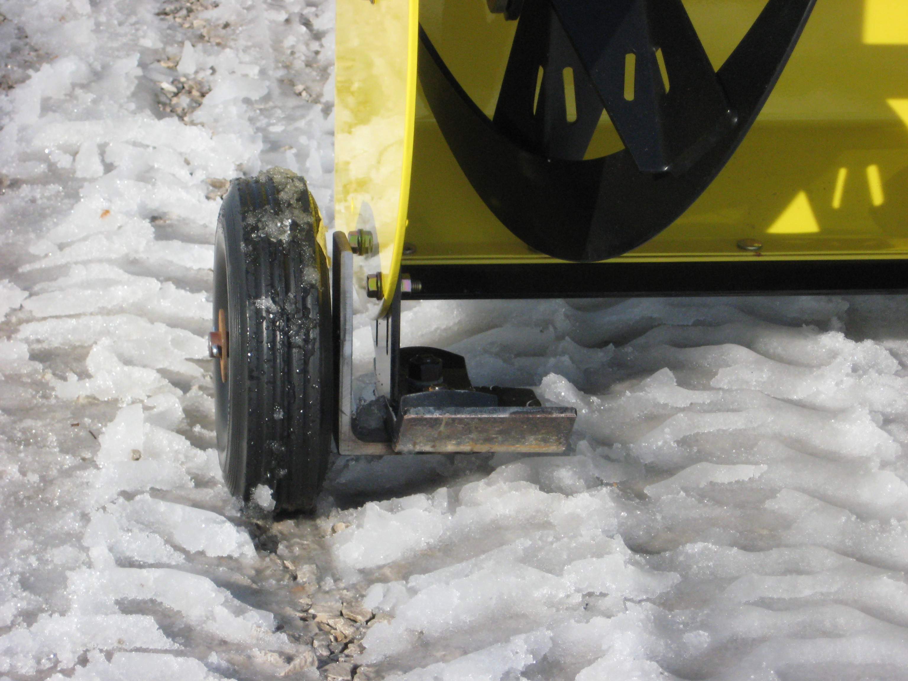

I tried increasing the area of the shoes as described and it still dug in, so I decided to add wheels to large angles that bolt to the bottom of the shoes. Seems to do the trick. IMG_3181.jpgIMG_3182.jpg
/ 54 " Blower fan observation? #25
I had the oppertunity to check out my "new shoes" last night and they did a great job although I wish I would have gone another 2 inches wider which I still may do. The shoes I had fabricated are exactly the same as the "stock" shoes but longer instead of 3.75 inches on the ground I have 8 inches and it definately kept them from digging in to my gravel driveway. which I will cap with another few inches of D1 come spring and compact it, since now what I essentially have is at best 1" minus material with a binder that has washed down after 3 years leaving some nasty loose rocks for the blower to digest, by leaving a solid 2" of snow base down and the new shoes I didn't pick up one rock last night. Eric
/ 54 " Blower fan observation? #26
I will post a photo of my shoes when I install them this weekend. I made them exactly twice the surface areaof the existing shoes by adding an 2 1/4" x 8" skid opposite the existing skid. Of the 8" on the original skid I would guess about 5" touches the ground.

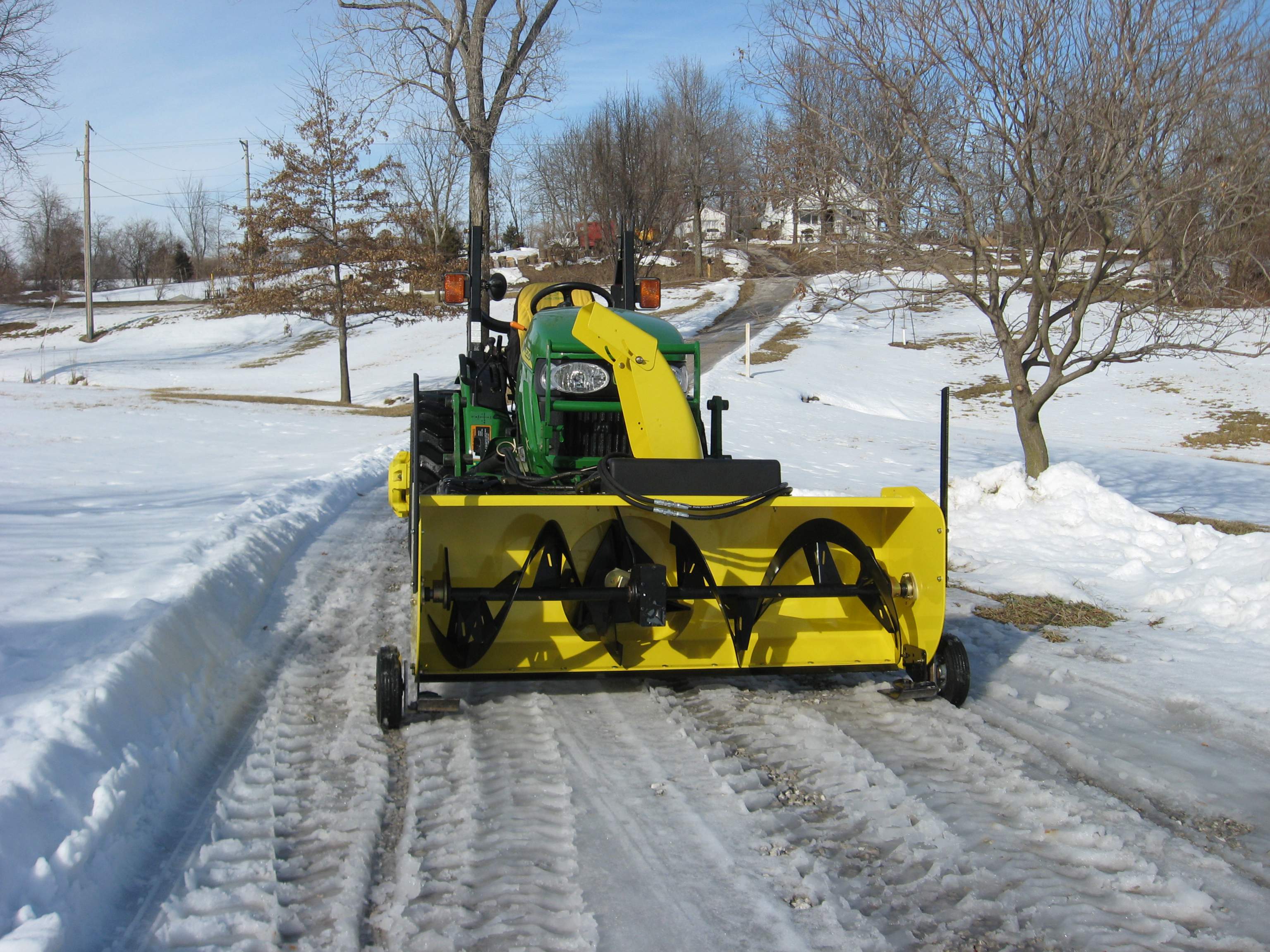

I tried increasing the area of the shoes as described and it still dug in, so I decided to add wheels to large angles that bolt to the bottom of the shoes. Seems to do the trick.View attachment 298075View attachment 298076
Never seen a set-up like this before, but hey, if it works good for you. :thumbsup: Up here the ground is frozen solid usually from Dec. to end of March, so not a problem. Have to say that I'm not to sure of the position of your hydraulic hose in front of the auger. :confused:
/ 54 " Blower fan observation? #28
Yeah looking at those hoses made me a little nervous too :D

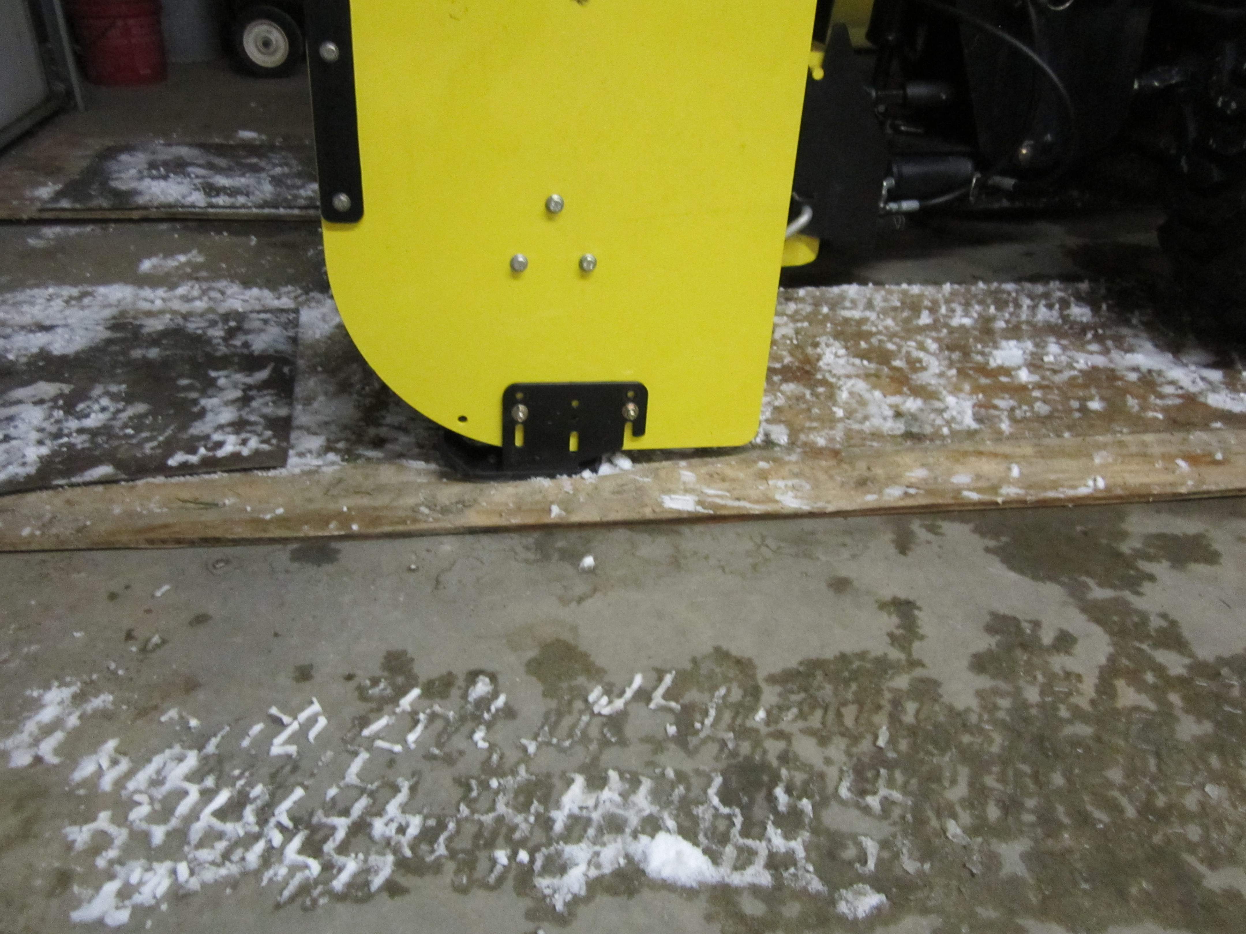

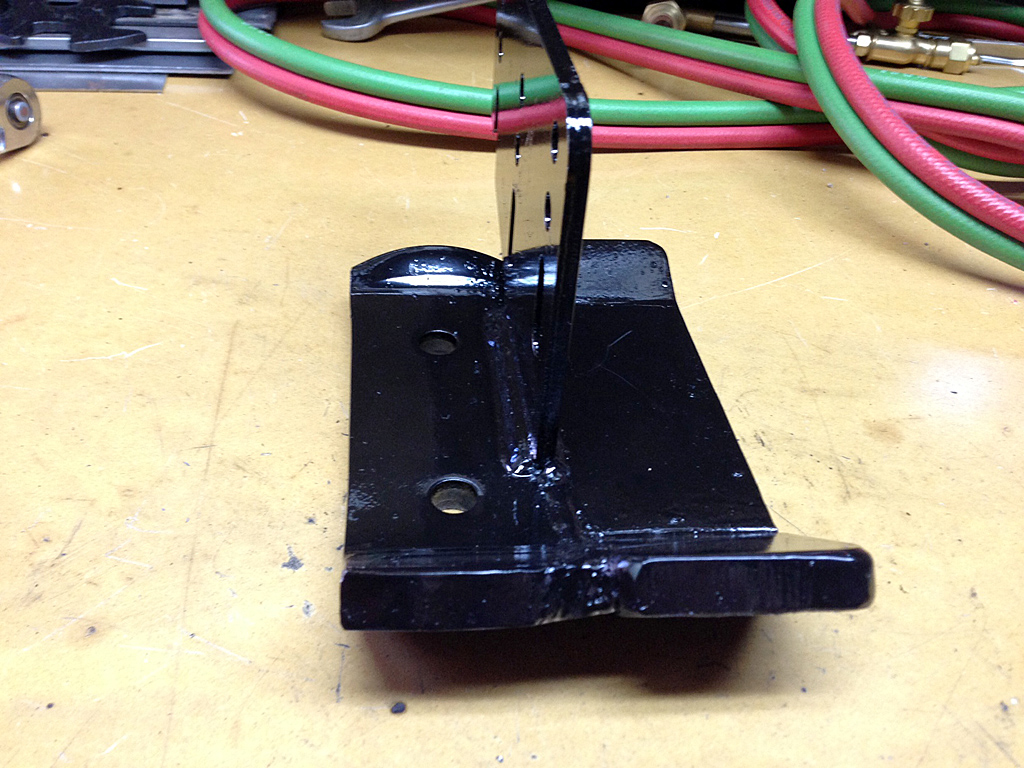

I installed the new blower shoes today. I guess I will have to wait until our next snow to see if I made any improvement. Below are a few photos to show what the new shoes look like. I simply added an additional skid to the side of the existing skid.
BTW, does anyone know why JD put the two holes in the original skids?
/ 54 " Blower fan observation? #30
I don't KNOW this but they may be locating holes for the welding fixture when the two pieces are welded together

No, I don't, but I used them to accept the bolts that hold my oversized shoes/wheels.IMG_3176.jpg
I have used them to mount extra sacrificial wear plates in the past. Replacing the shoes gets expensive, but you can bolt a piece of 1/2 inch plate under there, and it will last a long time.
/ 54 " Blower fan observation? #32
I know what you mean. JD wants $50+ for each shoe. But the shoes are super easy to make. If you are able to cut off the old skid a new chunk of 2 1/4 x 1/2 x 8" steel is only like $5.00 and it would last a long time. The hardest part for me was bending the ends. I can't imagine it costing more than $15.00 to make a whole shoe from scratch - that's materials cost of course assuming you are doing the cutting and welding yourself.

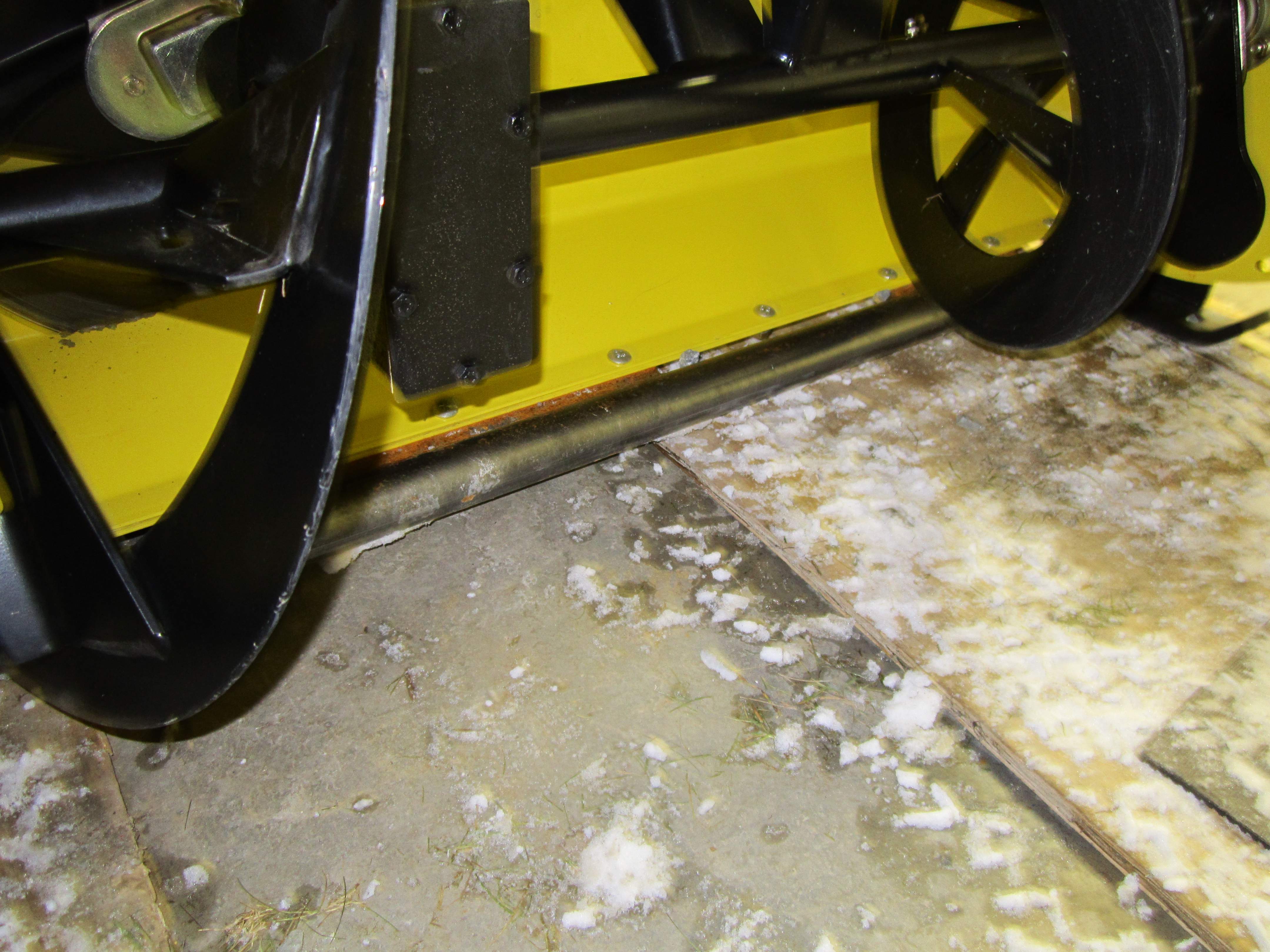

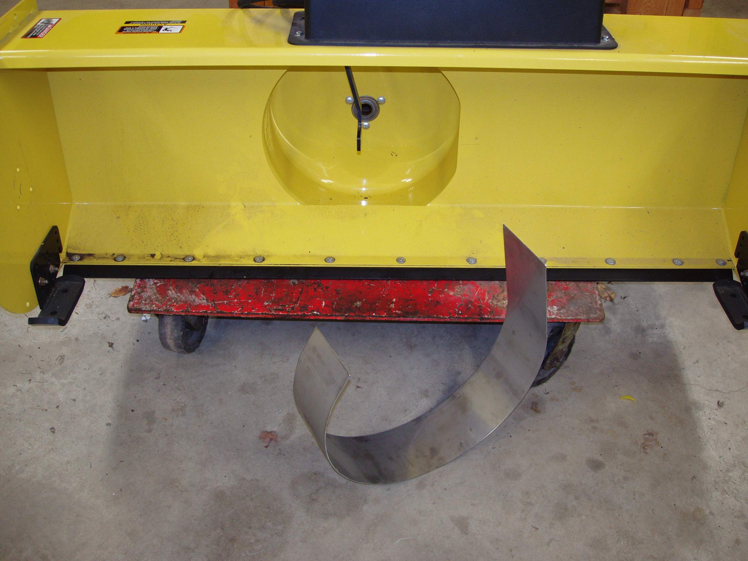

Another thing I did was remove the cutting edges on both blowers. I replaced them with a length of 1 1/4" schedule 40 steel pipe. The pipe has 3 tabs welded to it. A tab at each end with 2 holes and a tab in the center with 3 holes. It bolts right up using the bolts from the cutting edge. I only used the blowers a couple of times last season and 3 times this winter so far but I really love them pipes!! Here is a pic of the liner. EricView attachment 295943
Just curious, do you have any pictures of how you welded the tabs to the 1 1/4" pipe as well as pictures of how you attached it to the snowblower?
