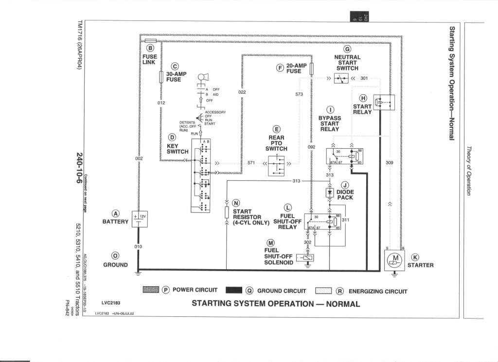

I reread your first post, my error. You are right the solenoid has nothing to do with it not turning over. At least on my 5210, the only safety switches are PTO and neutral switch. I have attached a picture of the wiring and starting systems for 5X10. I believe it is close if not the same to 5X20. As you will see from the starting system, since you indicated you could hear the fuel solenoid, it is one of the 2 safety switches, start relay or the starter. I would start by seeing if you have power at the starter and work back from there.
Have you checked the voltage on the battery? I have seen lights work, but the starter not work when the battery is low.

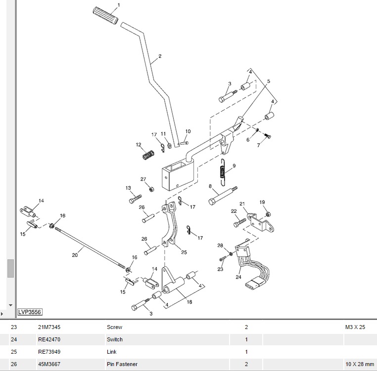

Where would the pto switch be located?
/ 5220 john deere won't start #10
Goto JDparts at the link provided (PTO lever and linkage). There are different selections and related pictures not knowing the transmission you have, I might be showing the wrong picture. Looks like the part number is RE42470.

Finally warmed up. I took the plate off by pto and found my problem. Mice have had there way with my wiring. They chewed the entire cluster into. I thought I might try splicing them back together but all seven wires are the same color blue. What the ****? Any ideas?

I found where mice have chewed thru pto safety switch wiring. All seven wires are completely into. I want to splice them together but they are all the same color, blue. Got any idea?
/ 5220 john deere won't start #15
Your Deere dealer should be able to come up with a wiring diagram for your tractor so that you can reconnect the wires. May take some tracing with the ohm meter or measuring some voltages when the switches are on/off, and hope the time fits in to your schedule. Is it the short wiring connector, or are the wires running on into a wiring harness?

The wires run under the seat and I haven't taken it off yet. I'm sure they just go to a plug because they come right out of the safety switch.
/ 5220 john deere won't start #17
The safety switch shows in jdparts.com as a pretty short (looks like maybe 6" long) set of wires to the connector.
Might the mice only have destroyed those wires and not beyond the connector. Then just a matter of buying the safety switch.. looks to be about $30 some bucks.

I still haven't had time to remove seat so I'm not sure if there is anymore damage. Hopefully there isn't, if not I'll get another switch, $30. Isn't to bad, probably better than trying to splice it. Thanks for all the help.
/ 5220 john deere won't start #19
Here is a shot of the jdparts.com showing the switch that I am thinking is what you have "moused" up. Item no. 24.
I would assume that the microswitch is captured in that bracket shown (item 21) and held by the bolts through the bracket and the switch. Have to unbolt the bracket first to get at the switch bolts. \\
Only shows 4 wires tho.
Hope that works for you.
#20
I'm pretty sure that's the setup I have. Haven't had a chance to work on it anymore but that diagram will really help. Thanks
