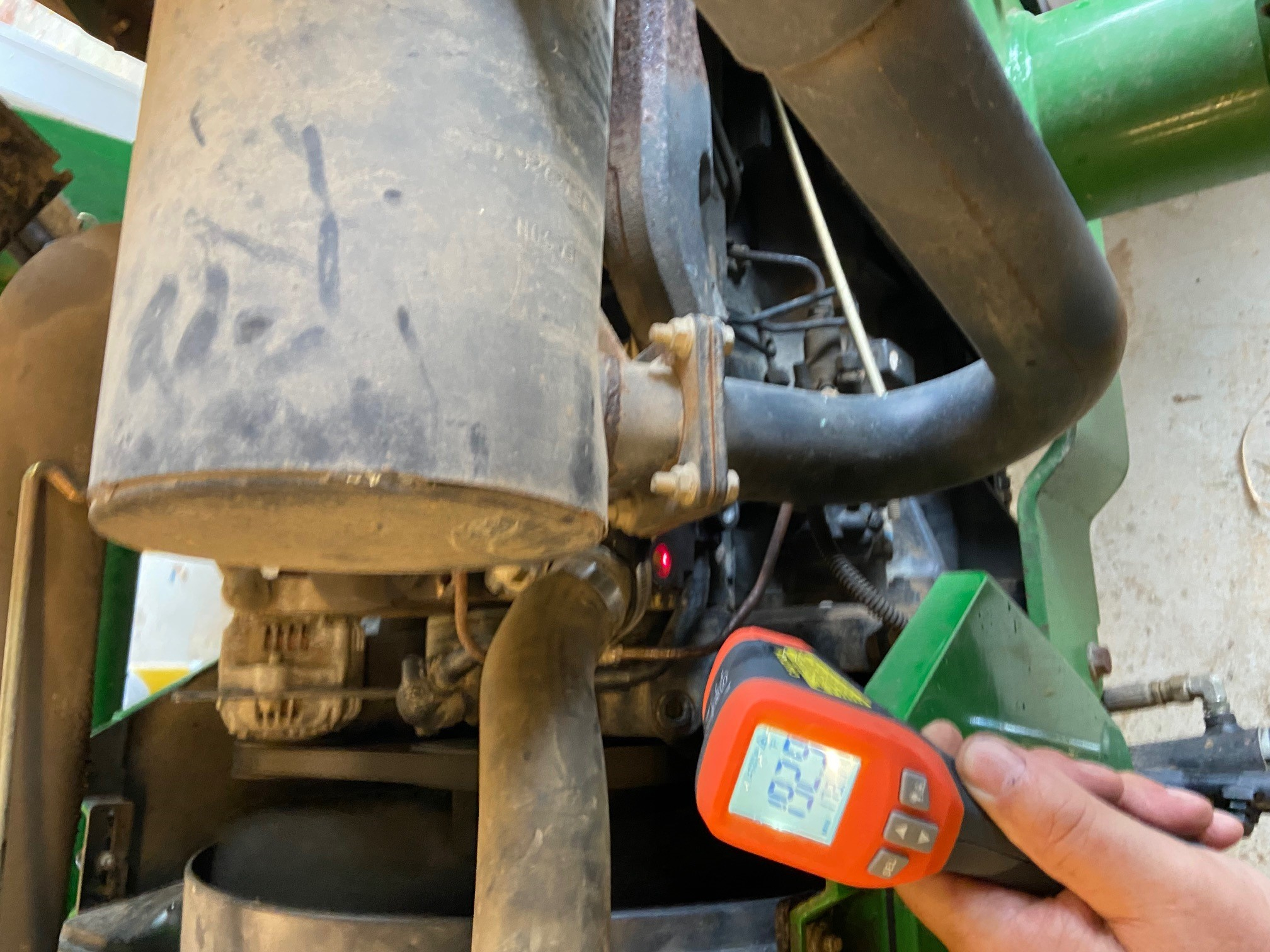

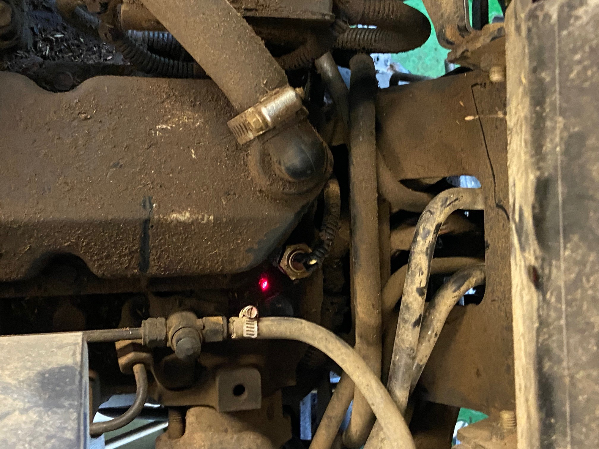

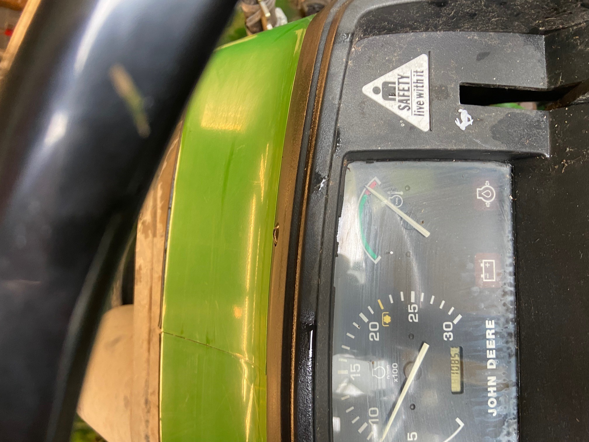

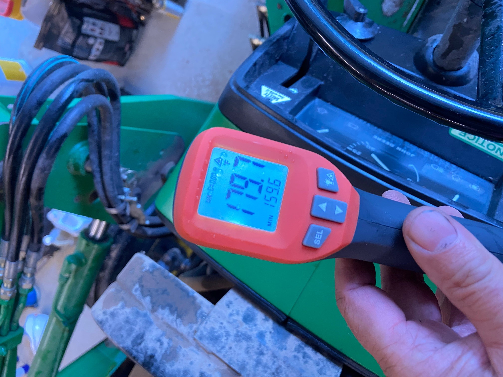

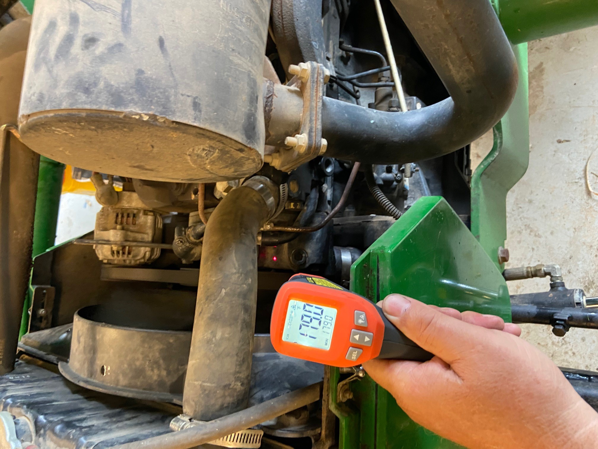

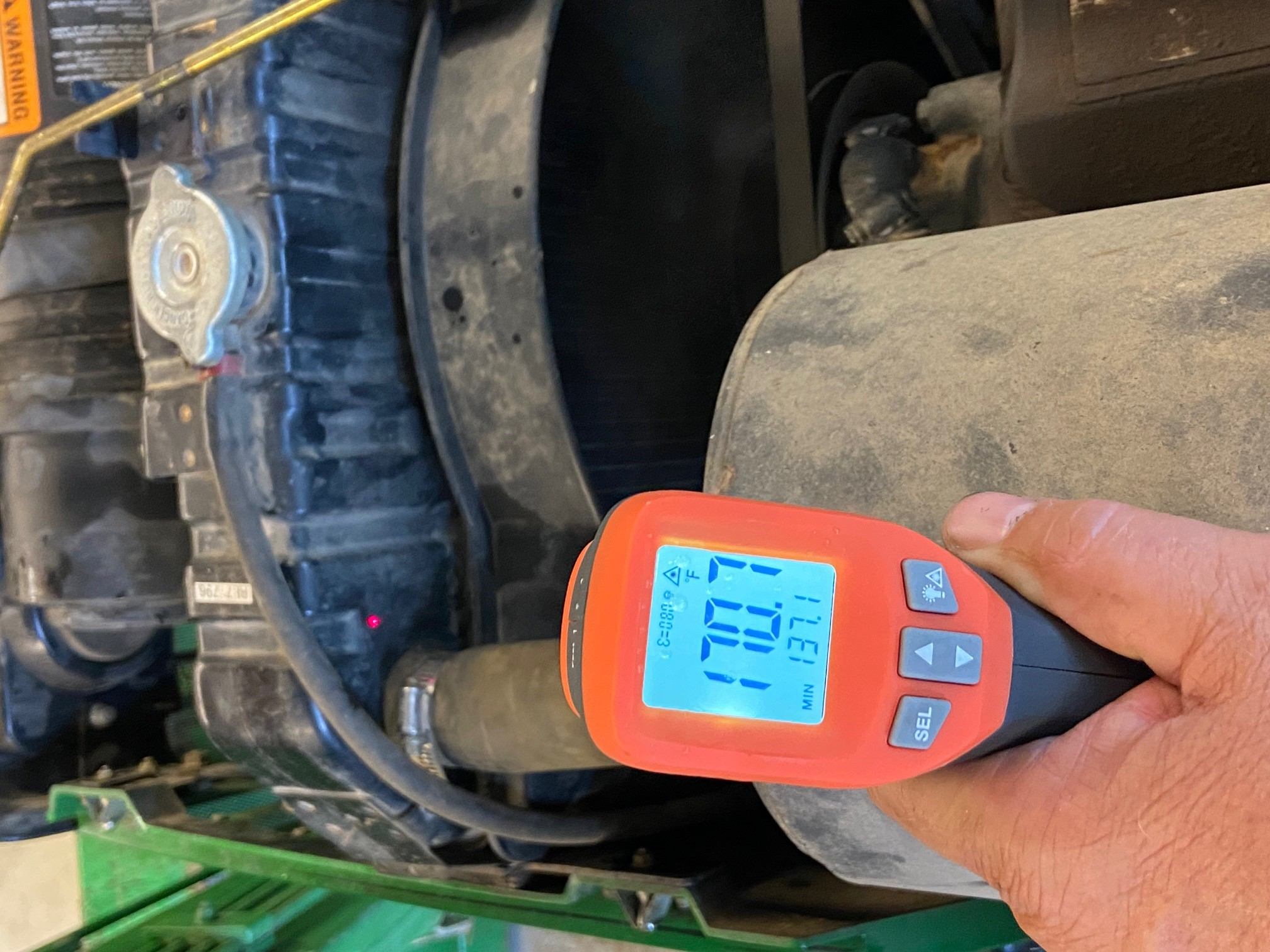

Tested the water temp sender per the manual and it seemed to be out of range, so I was able to get a new one from the dealer. Finished the flush and filled with pre diluted mix. The gauge still reads in the red zone. reading about 180 on the block at the sender location. Reading at the Tstat varied from 165 to 192. I could tell when it opened and closed. 170 at top of radiator, 180 on the pump housing. I think the conclusion is that the gauge is reading high.

How do you test the temperature sender? Ohms? Range? How about replacing it with a fixed resistor to to test the temperature readout?
It may help you to know how the temperature sender works on our older John Deere (2008 model). I'm not saying that this is your problem. Just letting you know that what you are seeing may not be what immediately comes to mind.
On our JD, the temperature sender starts cold at about 5 or 10 ohms and decreases to almost zero as the water temperature goes up. The sender signal goes into the engine computer where it is used to generate a very realistic-looking gauge on the dash. To the operatorin the cab, the gauge on the dash looks like an old-fashioned trustworthy analog gauge - but it isn't. It's a simulation of what a gauge would show at that temperature.
