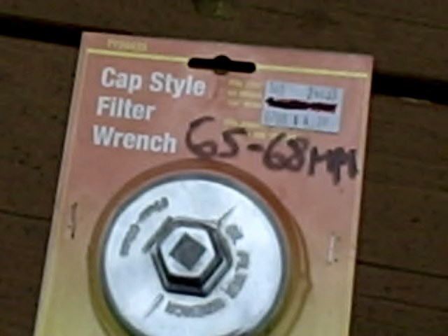

I'm no big time wrench, having said this, I would tell you to forget the torques specs and just use feel and common sense. Most of the bolts involved in the 50-hour maintenance have little meat to bite on. So if you go cranking em, you'll either strip em or breakem. And besides there isn't a lot of room to use a torque wrench.
I would also advise you to this this type of filter wrench for the oil filter. Using a ratchet extension, you can remove the filter without having to remove the loader, the guard, and the cowl.
Good luck.
