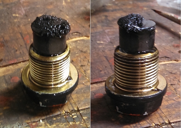

Hopefully this picture will show up. I am just doing the 50 hour service on my Kioti DK45SE gear model right now. This is what the rear drain plug with the magnet looked like. Pic on the right has the filings half wiped off to give an idea of depth and height. I don't know who all has run a Wet Surface Grinder, but that is what the filings on the magnet remind me of. Only wet with oil instead of coolant. If the attachment doesn't work you'll have to copy/paste the url.
http://www.acorncrestfarm.com/wp-content/uploads/2014/11/HydDrainPlug.jpg
While the hydraulic fluid looks very clean, I'll not be putting it back in this tractor. I'm rather cheap, but I'm hoping this one will last for the rest of my days.

You can evaluate the situation by looking at the filters when they come off. Normally the magnetic ring is there, and either gets reused or you get a new one with the new filter. Look at the old ring to see how much metal is on it, and the size of the particles (should be a fine gray fuzz/sludge, but there may be some small chips). See if any larger chips are stuck in the filter ports and ports on the filter mount.
I remember someone on here posted pictures a few years ago with a handful of metal shavings jammed around the filter ports. That was abnormal, and would be a reason for concern. I believe he got in touch with Kubota on that one and talked with engineers. Seriously, it looked like the nest of shavings I see in the bottom of a lathe tray after turning a part!! It was scary. Looked like the transmission case was not properly cleaned out when it was machined during manufacturing.

Just changed all my fluids yesterday. I had a lot of metal shavings on my drain plug also. I also used a strap wrench for the filters. Took some muscle but got both of them off without too much trouble. I bought the strap wrench at Home Depot, HUSKY brand.
