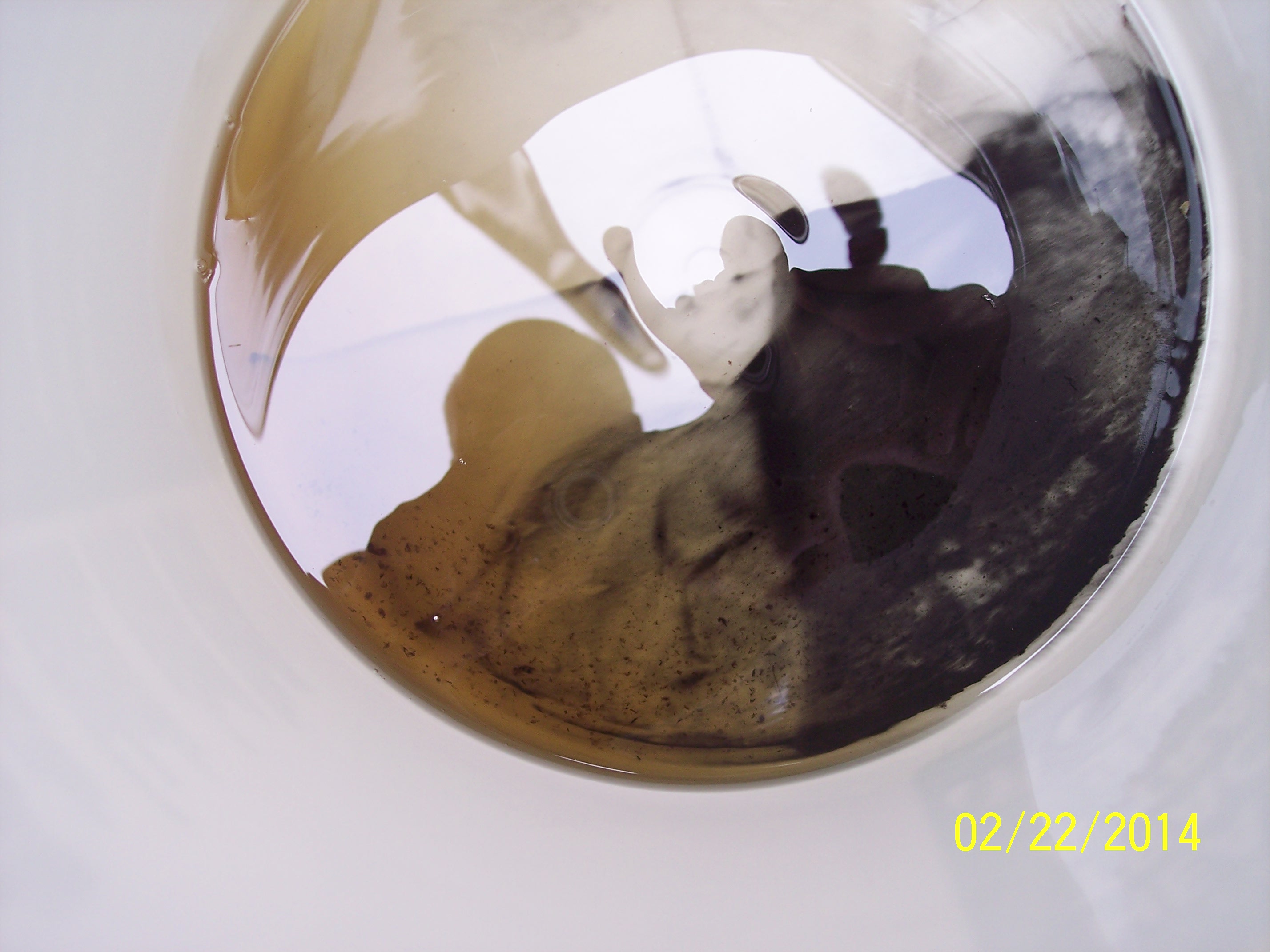

After looking at grm61 pics on page 3, I will change my hyd. fluid at 50 hrs. for sure .Yes Kubota hyd. fluid is costly but much cheaper than any repair that might be needed because I didn't do it .
/ 50 hour fluid change #51
That doesn't alarm me at all -- just a little heavier layer of particulates that settled out. It's hundreds of hours away from being an issue. When I saw the pics, I was actually surprised how clear the fluid looked overall.
I bet that if you put new fluid in your tractor and run the hydraulics for 10 hours, then drain and let the fluid settle, it will also look that way. 50 hours is just not enough time to really be a concern for hydraulic fluid, as long as the 50 hours happened in a reasonable amount of time. If it sat for 20 years for that 50 hours, then I'd be concerned.
Really at 50 hours, you want to evaluate the filter and any magnetic rings/rods for larger particulates, filings, chips, etc, and get those out. Anything big enough to be a problem will get caught in the filter or magnetic trap.

I cannot find the photo, but fileings or bits are just small pieces of metal like would be produced by running a file across a piece of metal. What we saw on the photo was more properly called machining swarf, or you could call them shavings. These are long (some maybe as long as 2 inches) of curled metal strips. These are produced by a cutting tool, cutting into metal. These are the same kind of swarf you would see from a properly running drill bit or a lath cutting.

I think this is a good explanation! When I first cleaned my hydraulic fluid strainer, I had some of both. I attributed the 'filings' from wear, and the 'shavings' or chips, coming from the machining process during build. The second time I pulled the strainer I found a little build up of filings, much less than the first pull, and no chips. Made me feel good about things.
