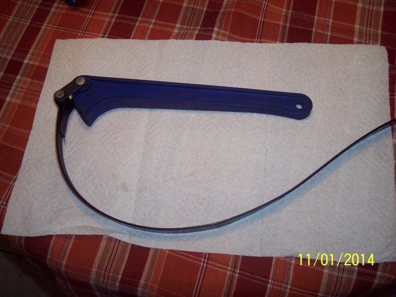

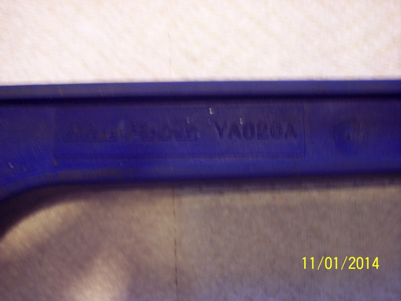

OK guys:), this will solve your filter removal issues....
This is much lighter and easier to use than a chain wrench, is very strong, and crushes less than a chain wrench as the strap has a little give and grips filters very well even if the filter gives a bit where the jaw is pressing into it, just back off a little and pull the strap tight and keep going.
I originally bought this when I was working on concrete trucks to get the hydraulic filters off, they get cooked on ,and can be very very hard to break loose, worked great on my DK45;)
This is a real tool, specifically for filters in industrial applications, and will do the job properly....no pounding screwdrivers through filters etc.
The one I have, I used commercially for several years on heavy equipment, and never came across a filter I could not remove....
Made by Blue Point...Part number YA826A
Copy of Blue point filter wrench 001.jpgCopy of Blue point filter wrench 002.jpg
/ 50 hour fluid change #29
View attachment 396929View attachment 396930
I bought one from sears
