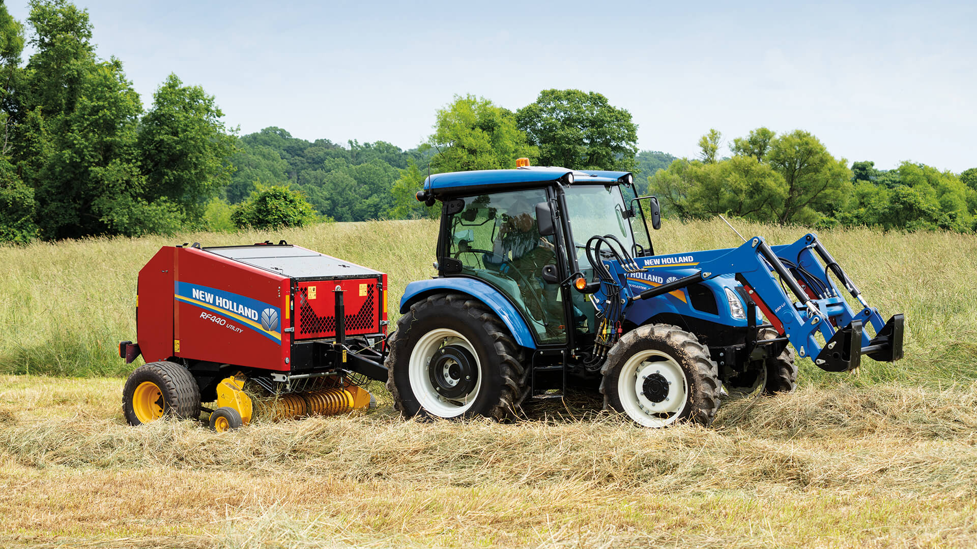

I like my NH Workmaster 75 HP. It comes in a 55 HP/40 HP PTO and a 65 HP/50 HP PTO model. Same cab, chassis, and loader. It weighs 6,800# without the loader. The 555LU loader is rated at 3,153# at max lift height of 131" (10.9'). The AC keeps the cab cold in the East Texas heat.
