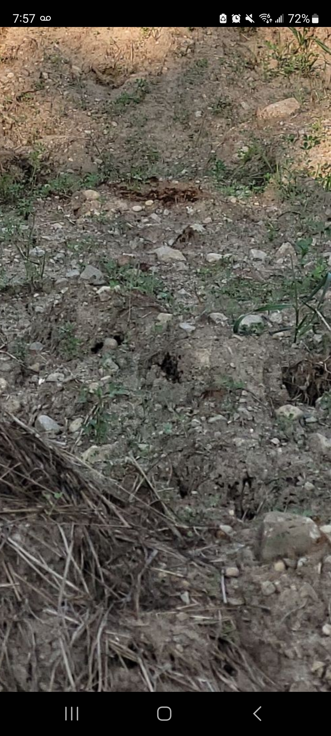

Actually, it does. I don’t use it primarily for stone burying, but it is the best maintainer of my fire breaks. I have 40’ to 50’ wide firebreaks around the perimeter of my 26 acres. This is desert and while there are no trees to speak of, the brush grows every spring after the rainey season.
The Blec will grind up any brush & weeds up to about 3’ high and bury it almost completely. After a pass all you see is bare dirt and a few larger cut up branch which will not burn on the ground.
And if it does encounter rocks, it burries them too.
