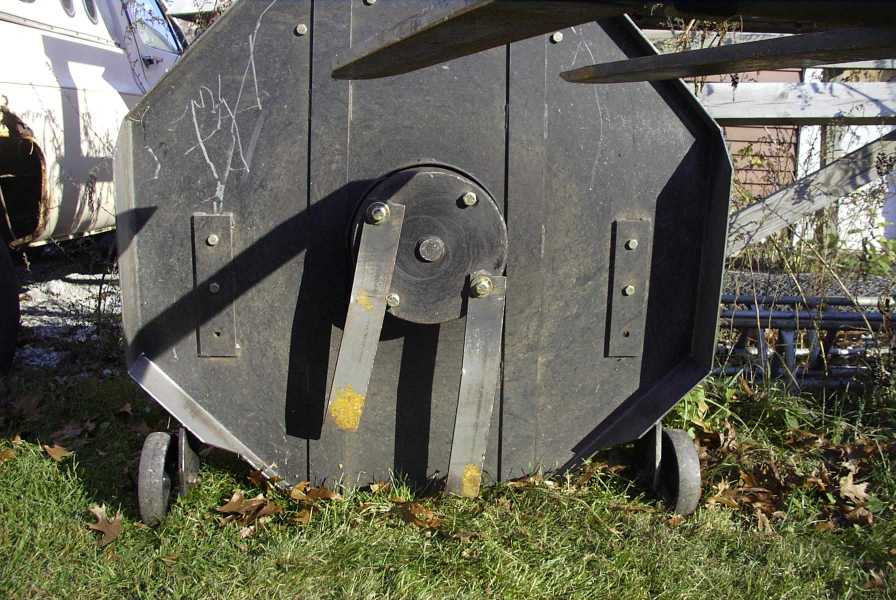

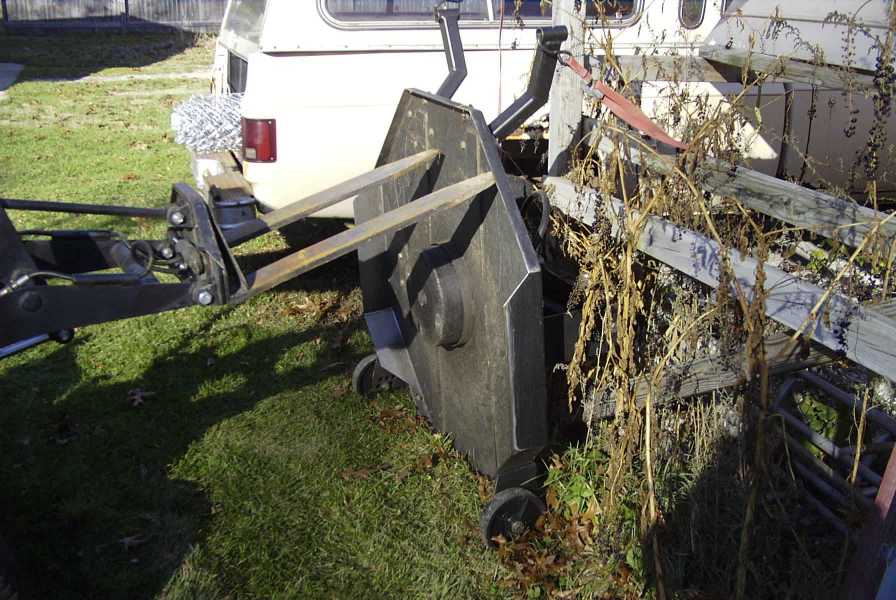

/ 48" Brush Hog Re-Assemble #56
It would be nice if PT sold them like this.
/ 48" Brush Hog Re-Assemble #58
That's what I'm talking about. Is that a converted unit?
I just looked for brush cutter pieces on the internet that would work; stump jumper, blades, and bolts. Then just retro fit things.
/ 48" Brush Hog Re-Assemble #59
Maybe I could make up packages of these things so that other PT 1430 owners could just buy it and bolt it on.
