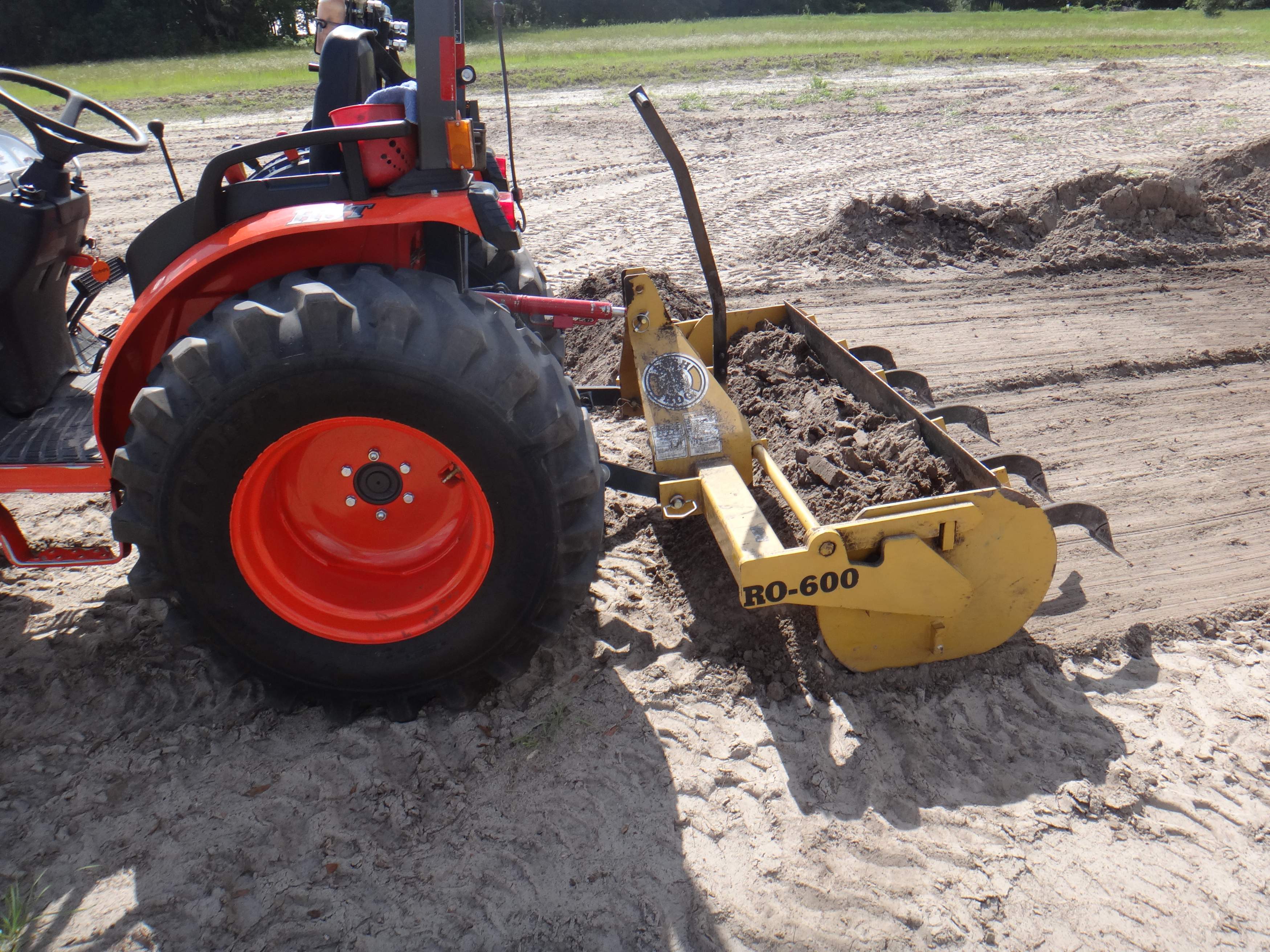

/ 48" Blade Box for BX23 #4
BB1248 It is Cat 1, rather than Cat 0 and heavier. There is hydraulic LIFT on the 3-Pt. Hitch, but drop and implement ground engagement is effected by GRAVITY only. You need as much implement weight as your tractor will pull in order cut into the dirt and peel off layers.
Just check with Land Pride to be sure your BX2370 will lift the BB1248 high enough to clear the pulled dirt the times you deposit it in a mound. I am 90% sure it will.
I pull a 630 pound Rollover Box Blade behind my 33-hp/1,900 pound/4-WD BX3300SU, which has 59" tire width.
Also, you want 3-Pt. counterbalance to approximate lift capacity of your FEL.
My B3300SU bucket lift is 750 - 1,100 pounds.
As the Box Blade sticks out a little, the cantilever effect makes it effectively somewhat heavier.
