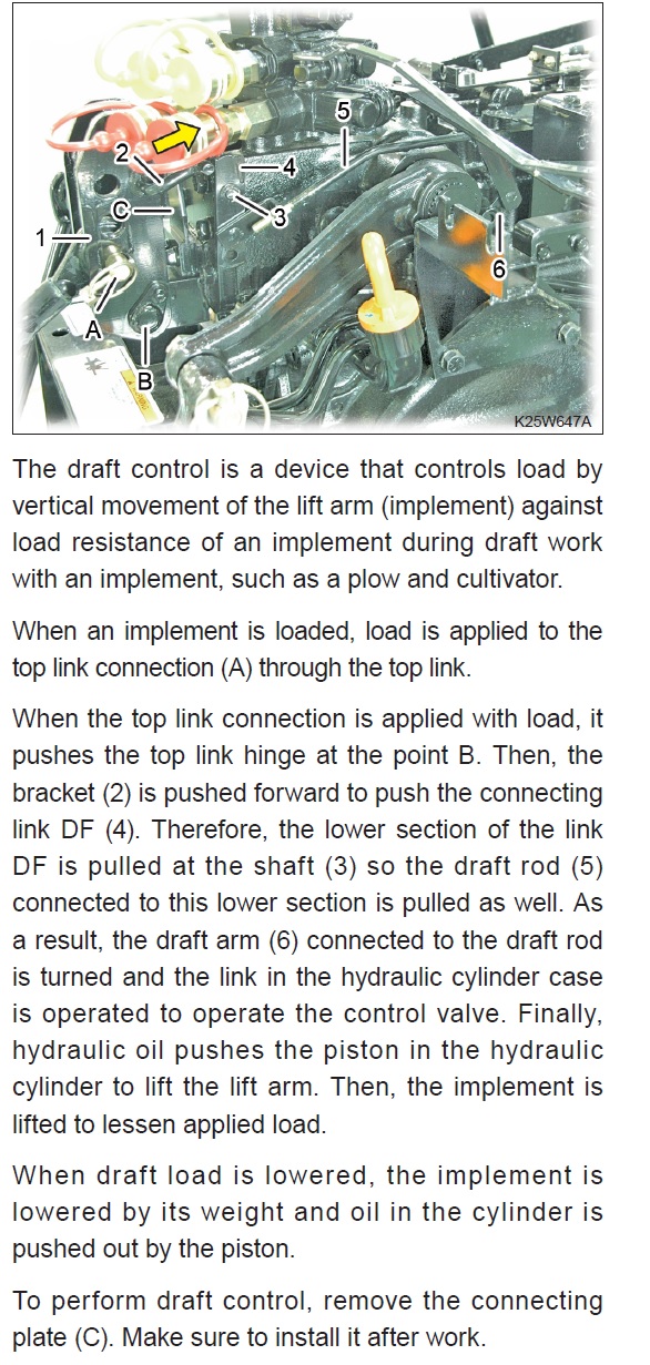

US models don't get draft control, although some older models might have. My guess is somewhere from 2012 and on. The EU and AU models get draft control.
The Operators manual is quite vague about draft control and the service manual is not great either but helps a bit when using the info from both models.
Here is a picture from the service manual to explain:
On mine, I just played with the shims and moved the part C all the way back, put the shims on front and tighten the bolts. When I'm not using draft, I just lock it with the swinging spacer on top of the top link bracket. When I need draft, I just swing the spacer and go on.
