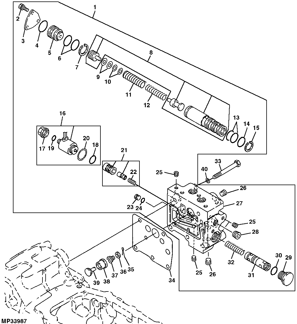

I did all checks and it is the PTO valve that is not working properly. Has anyone tackled one before? Any hints or suggestions?
/ 4720 PTO issue??? Help!!! #23
So I understand that you did the test that Spanner recommended and it was fine.
I presume since you stated that the PTO valve was not working properly that you did the test I recommended back in an earlier post.
Specifically the test that is on page 624 of the manual and that both of those tests or at least one of them failed.
Which one failed: Test port plug (A) or Test port plug (B). What were the readings on the gauge on both of the two tests?
#24
I tested the solenoid and wiring. It gets power when PTO won't engage. When I take off solenoid and put it back on the pto will engage for about ten mins. I did this about 4 times with same results. PTO will engage after taking off solenoid and replacing it. I have not done the valve test. Guess I'll look that up next.

I wish I had a good update. I decided to tackle the PTO valve. I replaced all components, orings, springs, shims, etc. When taking it apart all the hyd. fluid just in the pto valve was very grey, like it was full of metal, makes since because the PTO solenoid draws metal particles towards it. But why is there metal in fluid? Other than the grey tint of the fluid everything was in good shape, no dirt or grim. I put it back together and it still does the same **** thing. I mowed a little longer than normal but when I stopped PTO and then re-engage it, it won't turn on. I let it sit for about 20 mins and it worked again, this was the fastest its ever worked after letting it sit. Usually a couple of hours before pto will engage.
The only two things I can think of is: 1. maybe the fluid was run too low for a long time and parts weren't lubed thus metal components wearing. 2. something is going out, bearings or maybe hydraulic pump. When I check the fluid level it is still very clean.
Any more thoughts?
