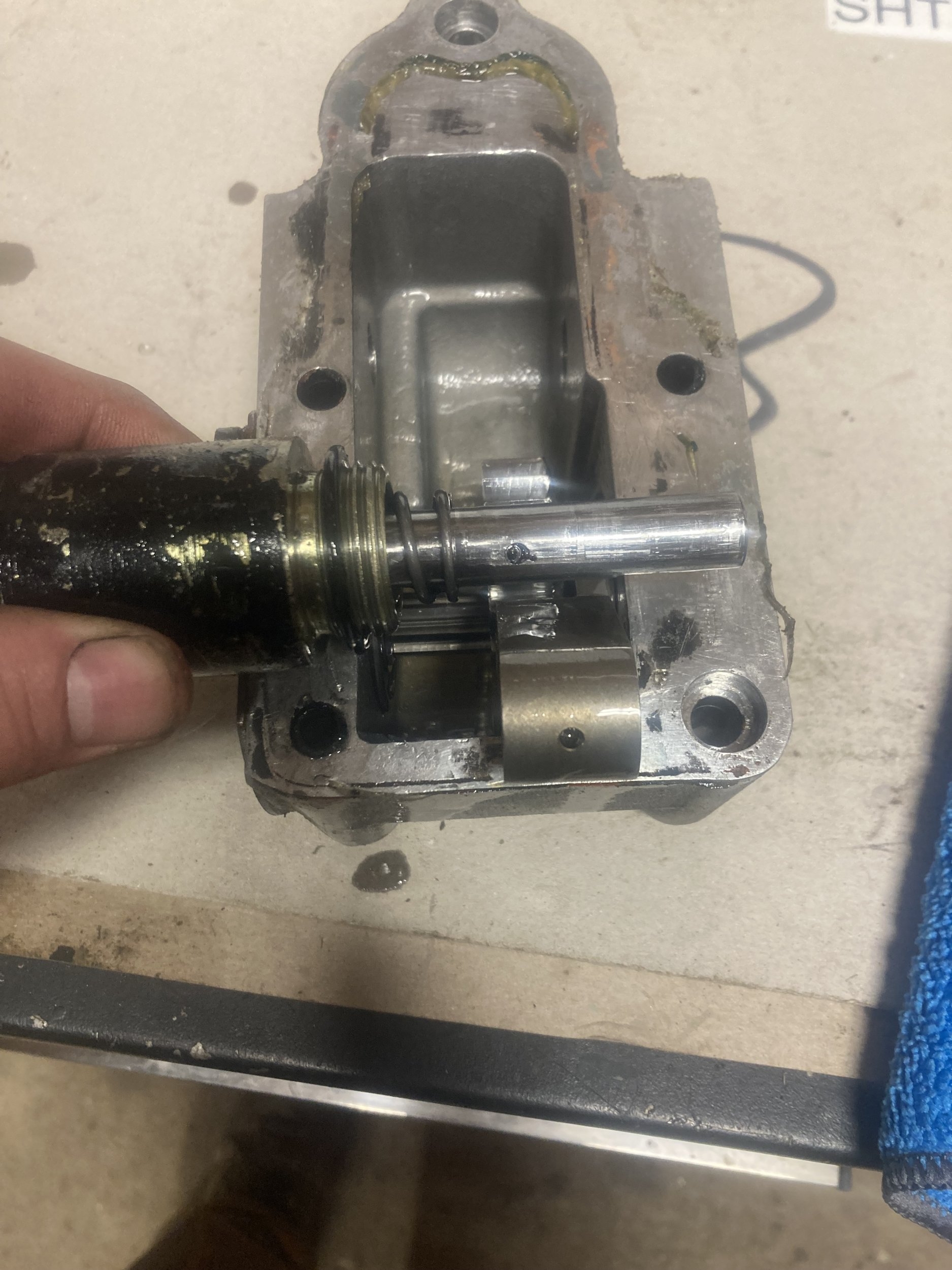

Hi folks,
Looking for some help with my John Deere 4310 e hydro. My machine runs fine, after about 35 minutes of use the pto shuts off. It’s like an electrical issue after warm up. I can hear and see the main pto turn on and off with the button but the mid pto doesn’t. I can let it cool for a bit then the mid will start back up for a bit. I switched the relays in the fuse box with the lights. Just to isolate a bad relay. I bypassed the seat switch and replaced the solenoids all three on the valve bank. I even removed clean and tested then switched the plungers in the valve bank. I also opened the switch panel and tested the on and off pto knobs all tested good. Running out of ideas any help would be appreciated.

Appears that there is only one PTO clutch and the mid PTO runs off of a shaft from the rear PTO after the clutch assembly.
The mid mount PTO is actuated with cylinder 1 moving shift fork 11:
If the mid mount PTO is falling out over time I would suspect that actuation cylinder part #YZ81107 is leaking down,
or the hydraulic controls or solenoid that activate it parts 2-9 here:
Maybe pay particular attention to making sure that solenoid attached to part #2 is not weak/heat sensitive

Thank you folks I am going to dig into the actuator and see where that takes me. I will keep you posted.
/ John Deere 4310 mid pro issue

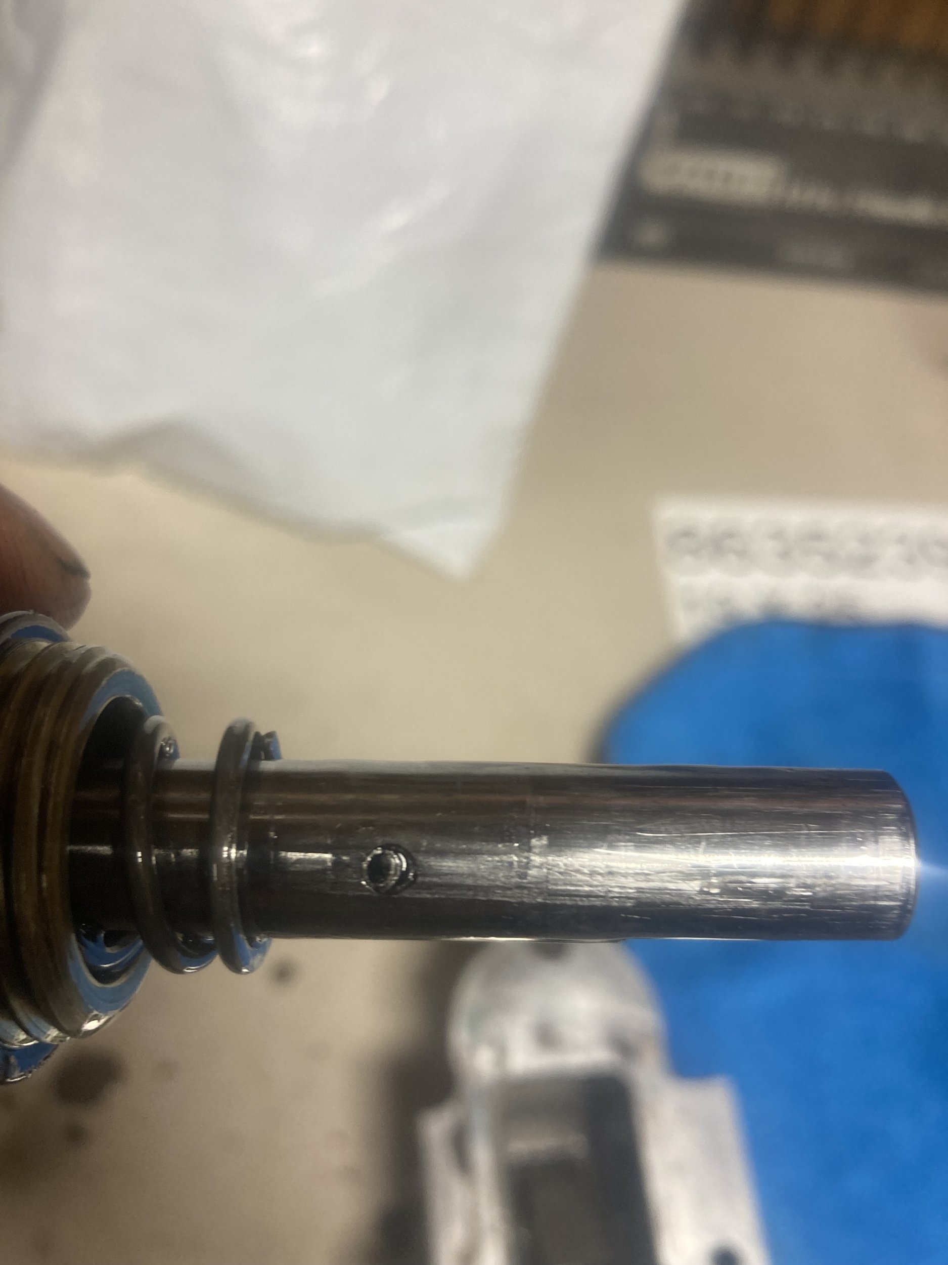

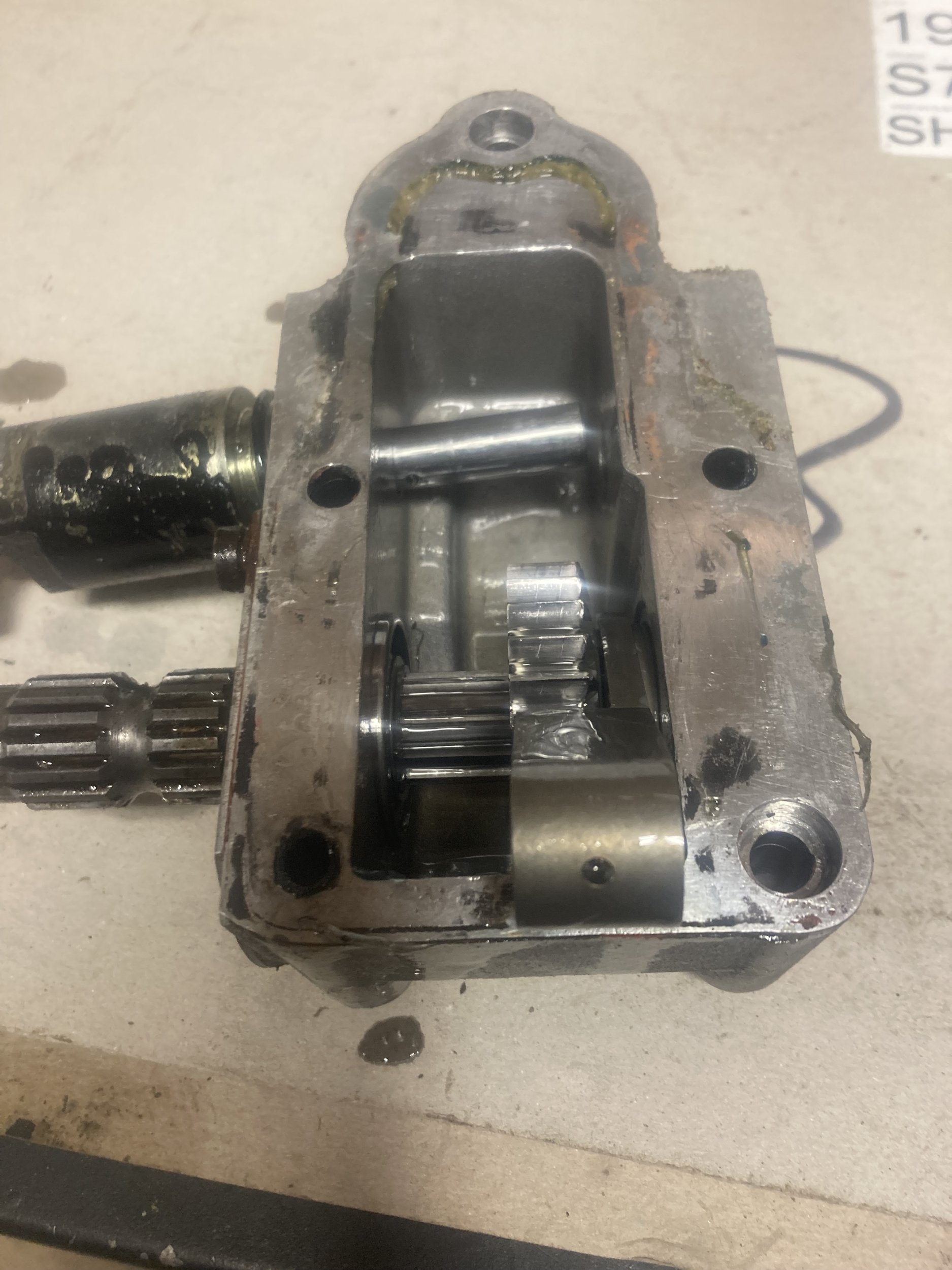

I removed the actuator and the shaft came out with it. Is that right or should it be pinned to the shift fork. I never took one out and trying not to drain the hole transmission.
/ John Deere 4310 mid pro issue #6
Sure looks like from the diagram that pin 10 is supposed to lock that shift fork to shaft 4. What does the hole in shaft 4 look like? Is there remains of a sheared roll pin?
If the shift fork is sliding on that shaft you may have your smoking gun

Thanks for the help it was the roll pin that broke and the shift fork was floating causing the intermittent operation of the mid pto. Problem solved thanks again.
