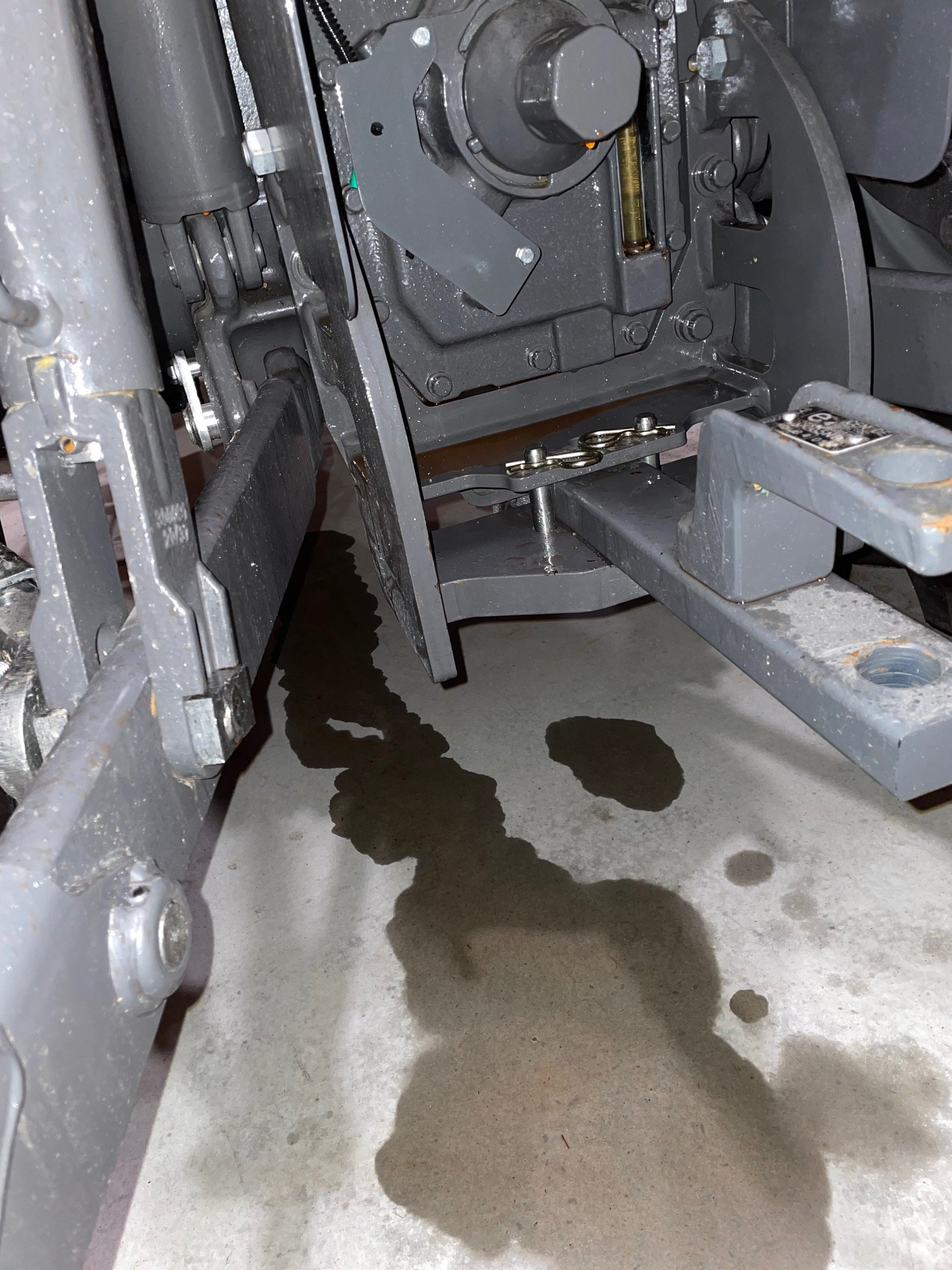

Went out to the garage and looked more closely at everything. It's not fuel, it appears to be coolant. Why would the back of the tractor be sprayed with coolant? Also, the coolant reservoir is quite low, further suggesting it's a coolant leak.

Cab heater line leaking?
Sounds like you have just about nailed it down, good luck
That should be easier then finding a fuel leak.
A caution with that color anti freeze be carefull what you mix with it.
If you don't find your leak at a hose connection loosen your fan belt and check the fan for water pump bearing issues.

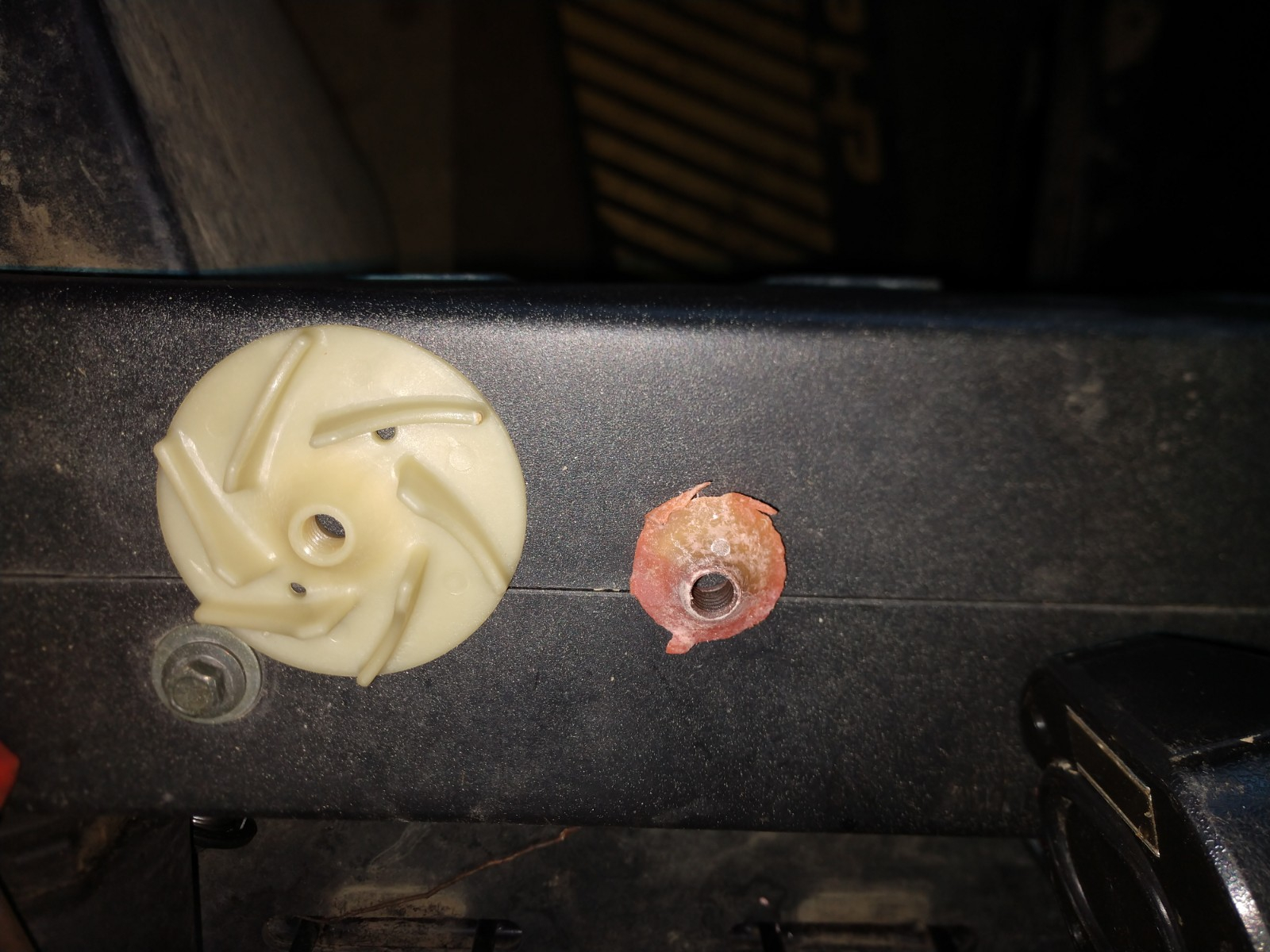

I changed the coolant in my UTV to a "long life" and thought I had flushed it good.
I have no idea what it had before or if someone had added something to the coolant system.
But I ended up with a hard waxy substance that seemed concentrated in the water pump
with just a bit in the lower section of the radiator.
And here is the new water pump impeller compared to the one removed
So I have no clue what to tell you other then be careful, and if you change it I'd recommend a really
complete flush which will be difficult to do in cold weather as most engine do not have a low point block drain any more
and draining the radiator will leave a gallon or more in the block.
Good Luck
