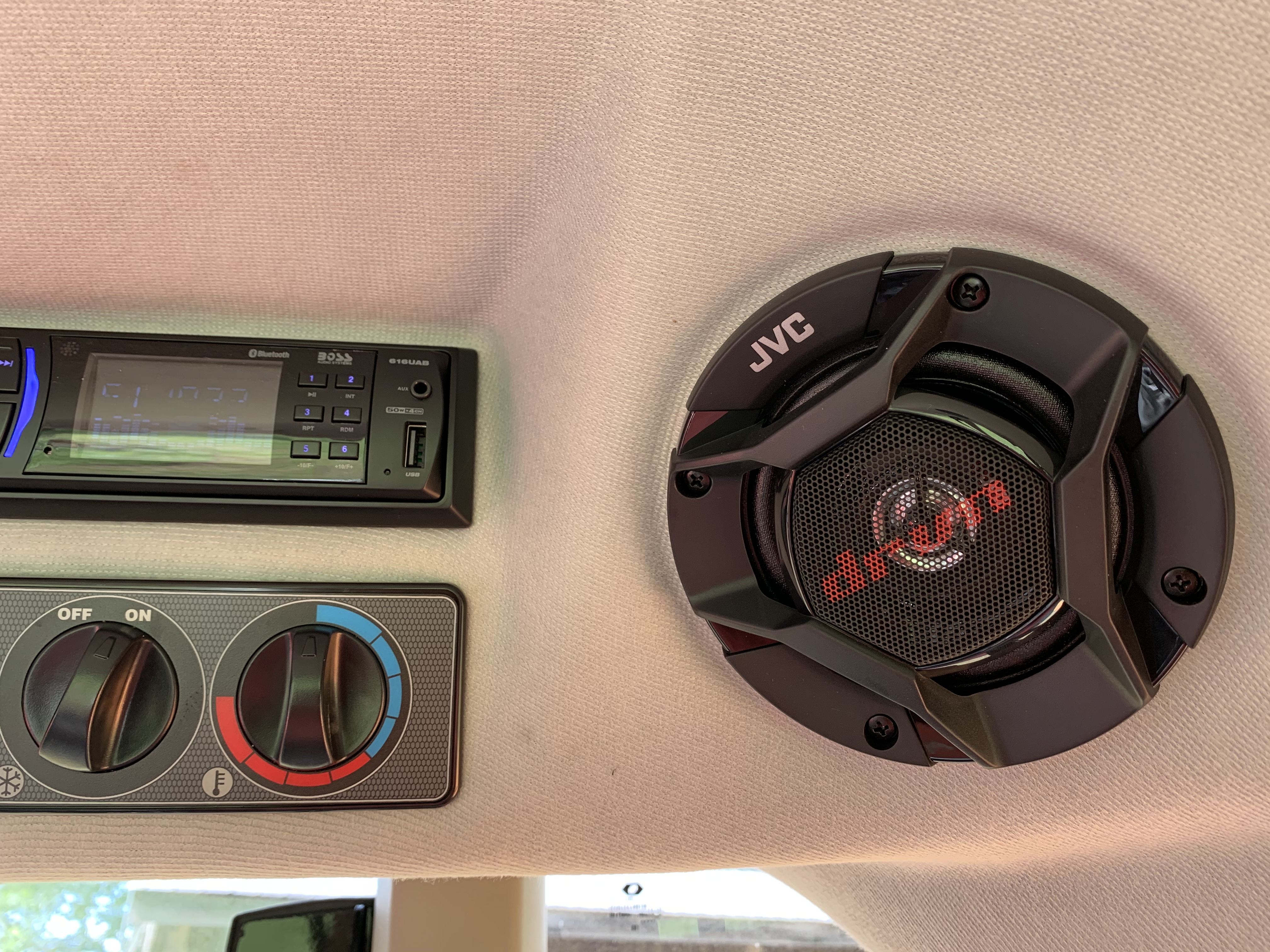

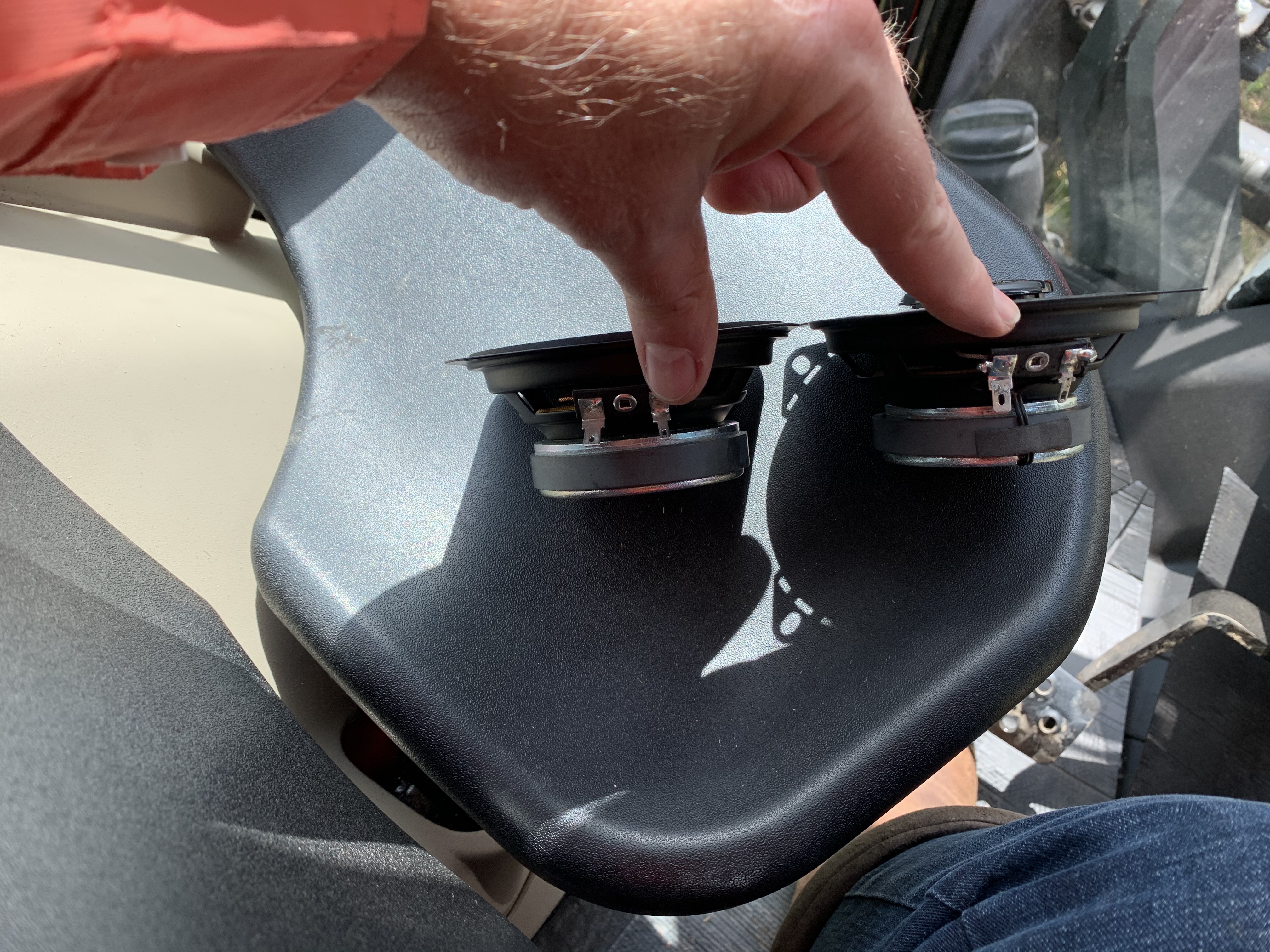

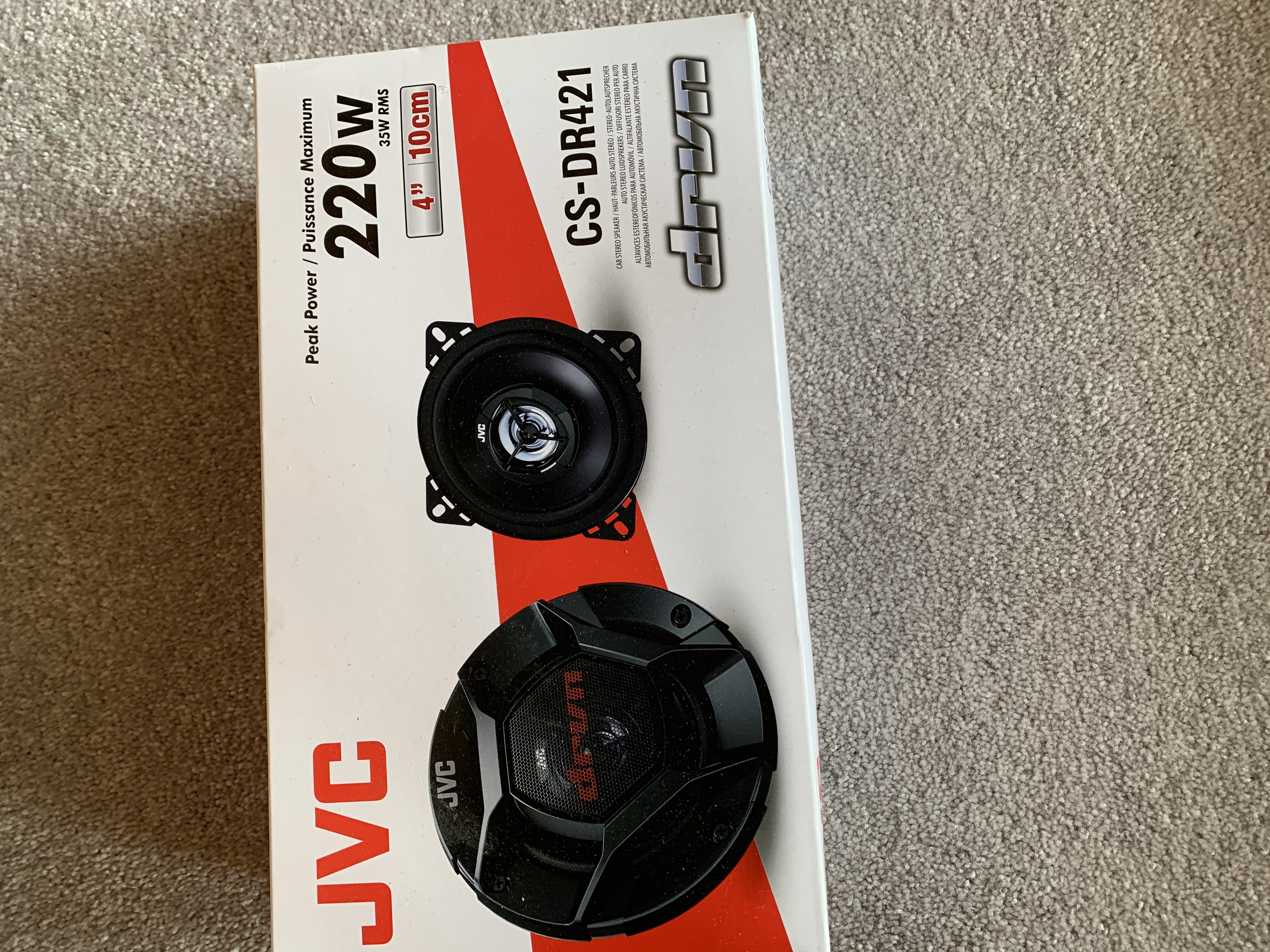

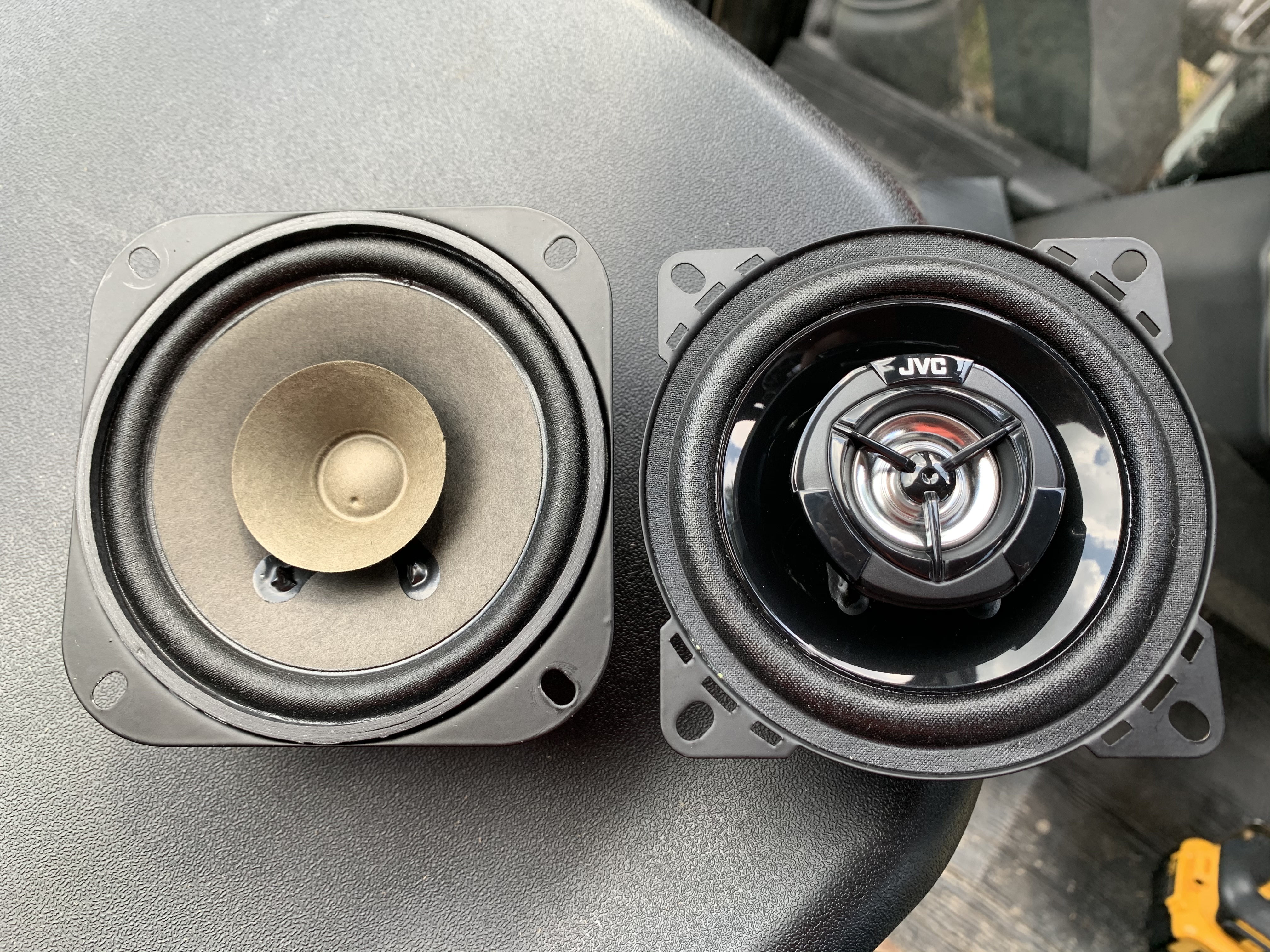

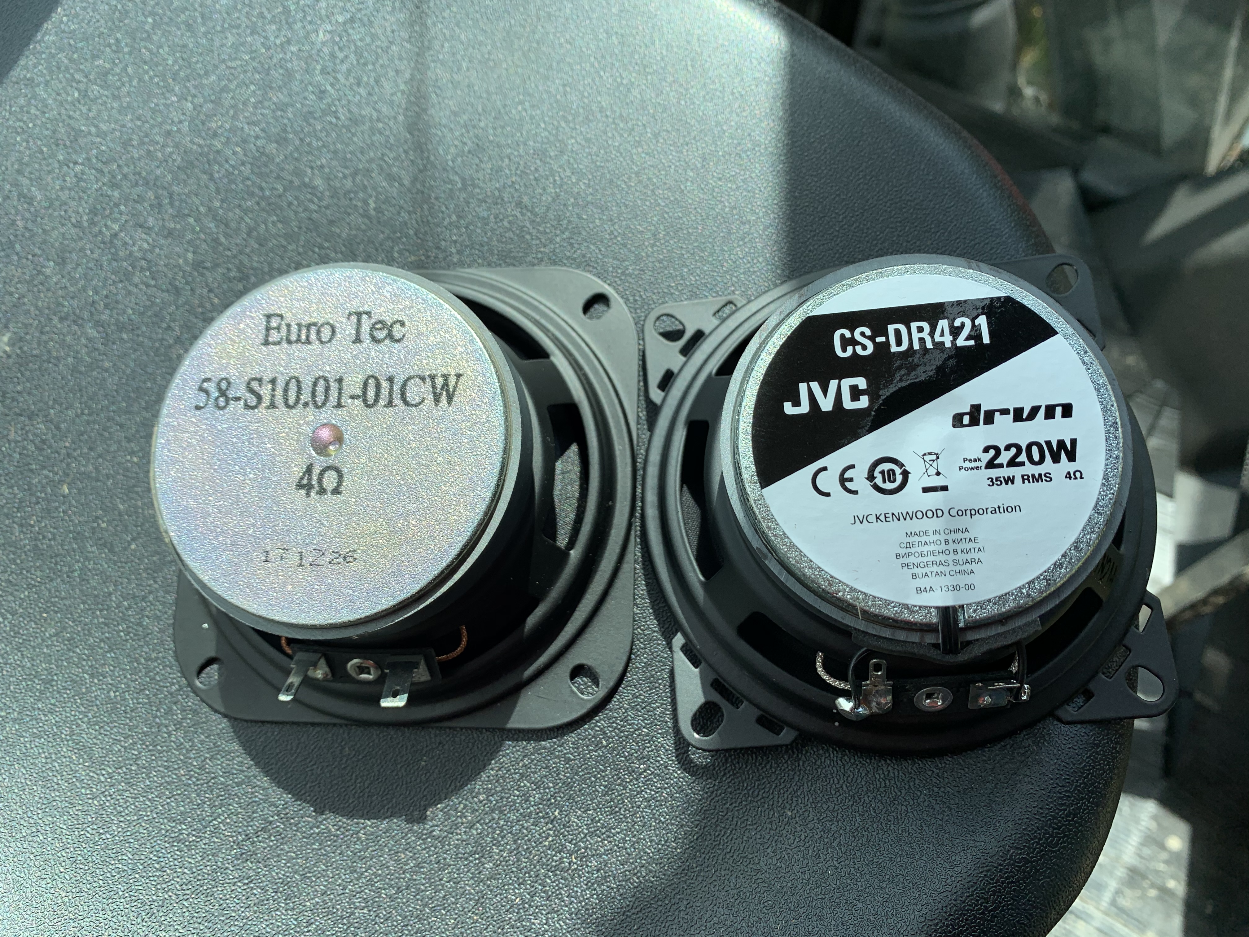

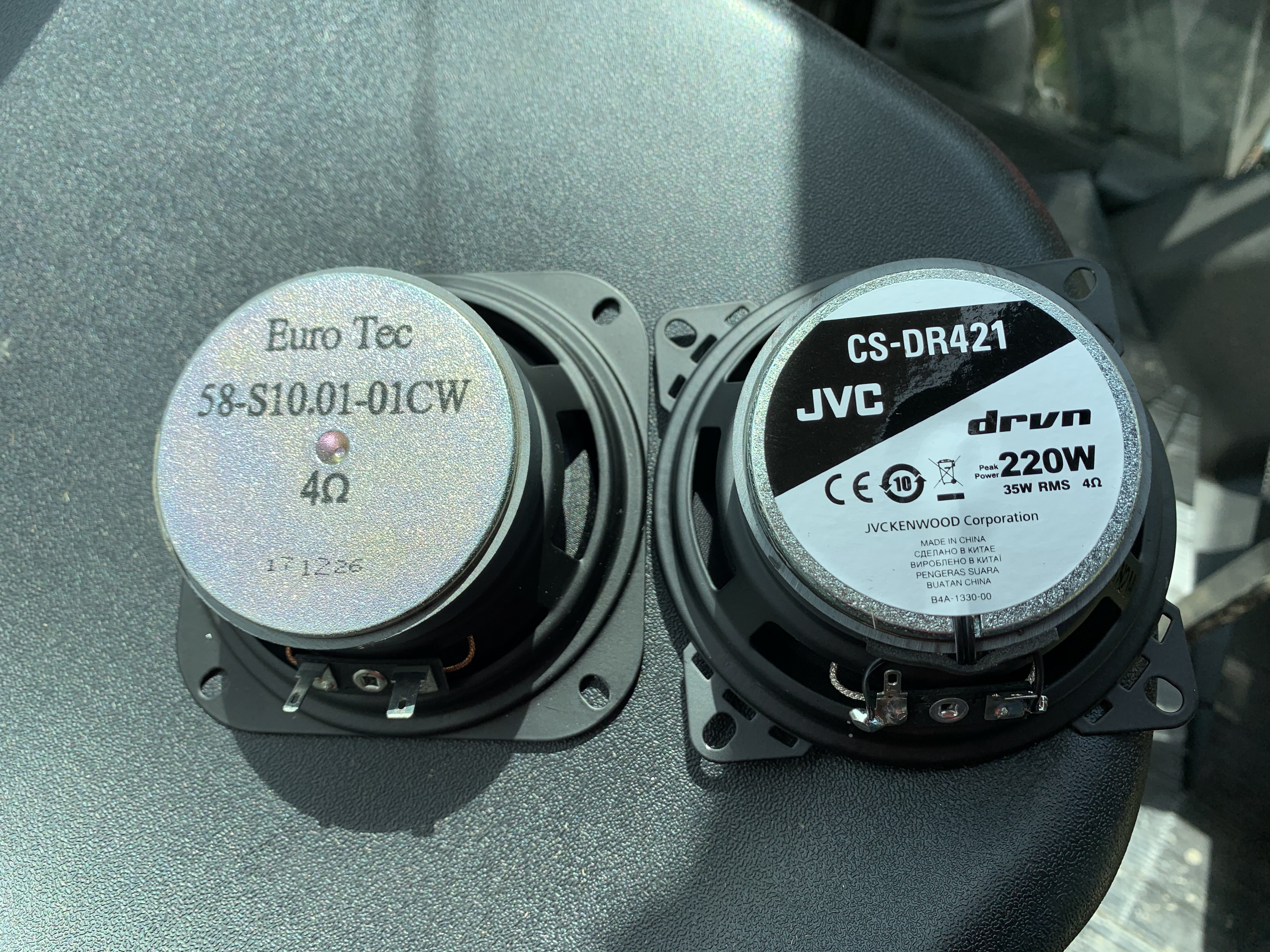

Hey guys, I did a upgrade I wanted to share. When mowing I had to turn up the music too loud to hear the words. It was just muddy sounding. I took out a speaker and looked it up on the net they cost $4 ea so no wonder. I spent a bunch of time measuring and researching.
I came up with JVC CS-DR421 from here. They fit perfectly and come with new grills. You can not get more bass from 4.5 inch speakers but having a quality two way speaker with a separate real tweeter made a difference. I can hear the music clearly at a lower level.
This was easy plug and play. The factory speakerS wire fit on the new ones perfectly. The grill screws fit on the tractors tabs. Hardest thing was getting the old grill off. You take a awl or tiny screwdriver and stick it in the perforations on the edge of the grill and pull it out 1/8 inch the move 90 degrees and do the same working around the grill until it pulls out.
I took comparison photos so you can see how close to the same size it is. For $39 bucks this was worth it to me. I did find a powered sub that would fit in the manual pocket but I good for now.

Wow, this is great. I was thinking the other day it seemed like the music wasn’t so stellar. Thank you for posting on this!

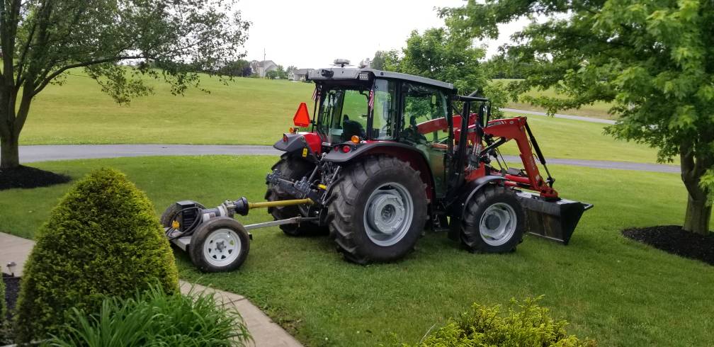

That’s awesome with the generator! Did you have a special ground or anything or just use the ‘house ground’? What size cable did you run from it & through what amp breaker? I have something set up for my pto generator from harbor freight but haven’t actually tested it out..I thought it was 16k but turns out max isn’t that much running through the 220, maybe 10 or 12k (can’t remember)- which is a little frustrating but not end of world. Supposedly people still use it to run majority of house if you don’t run everything at once.
