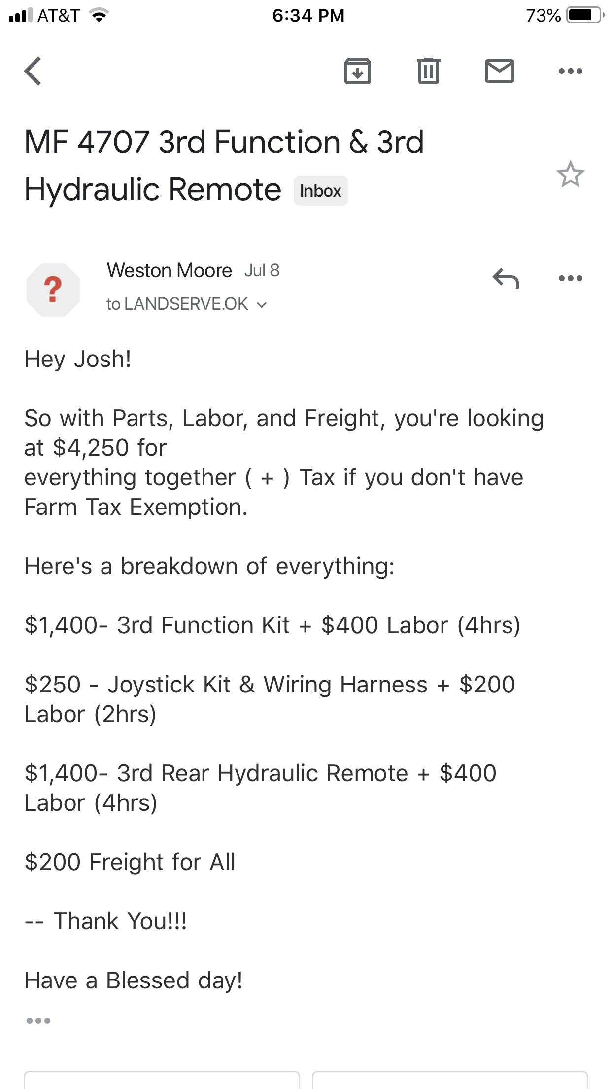

Called the dealer and got a quote to add a 3rd remote in the back and a 3rd function on the loader. Does this quote look right? Have any of you had this stuff done after the purchase? 6E87CCCB-4067-4BD0-8AF1-E73E98E8DD48.png
Called the dealer and got a quote to add a 3rd remote in the back and a 3rd function on the loader. Does this quote look right? Have any of you had this stuff done after the purchase? View attachment 612234
I can’t speak for the rear 3rd remote but my dealer sold me the front third function kit for $823 and install was $250 for both that kit and the front fenders. I don’t see a separate line item for a different loader joystick. Not sure if they had to swap that out or if it was already installed on the lot.
When I was pricing early on the front 3rd function was around $1000 installed on the 1760 or the 4707 if I wanted it. When I got it, it came with a new joy stick and wire. I’ll take a photo next week of the joy stick when I’m back and post it. I liked the way the stock joystick looks better but it works good.
When I was buying the tractor I thought they had told me a little over $1000 for the 3rd function and like $1500 for the remote but so I was pretty surprised at the price. He did say this would be the updated controller rather than a diverter button on my current joystick. I’ll keep shopping.. No good dealers around here, it’s been super frustrating working with the 2 local dealerships.
My third function was around $1000 or so. Looks a little high IMHO. My dealer charges from his whole goods parts list and makes a little on the install. They are fair.

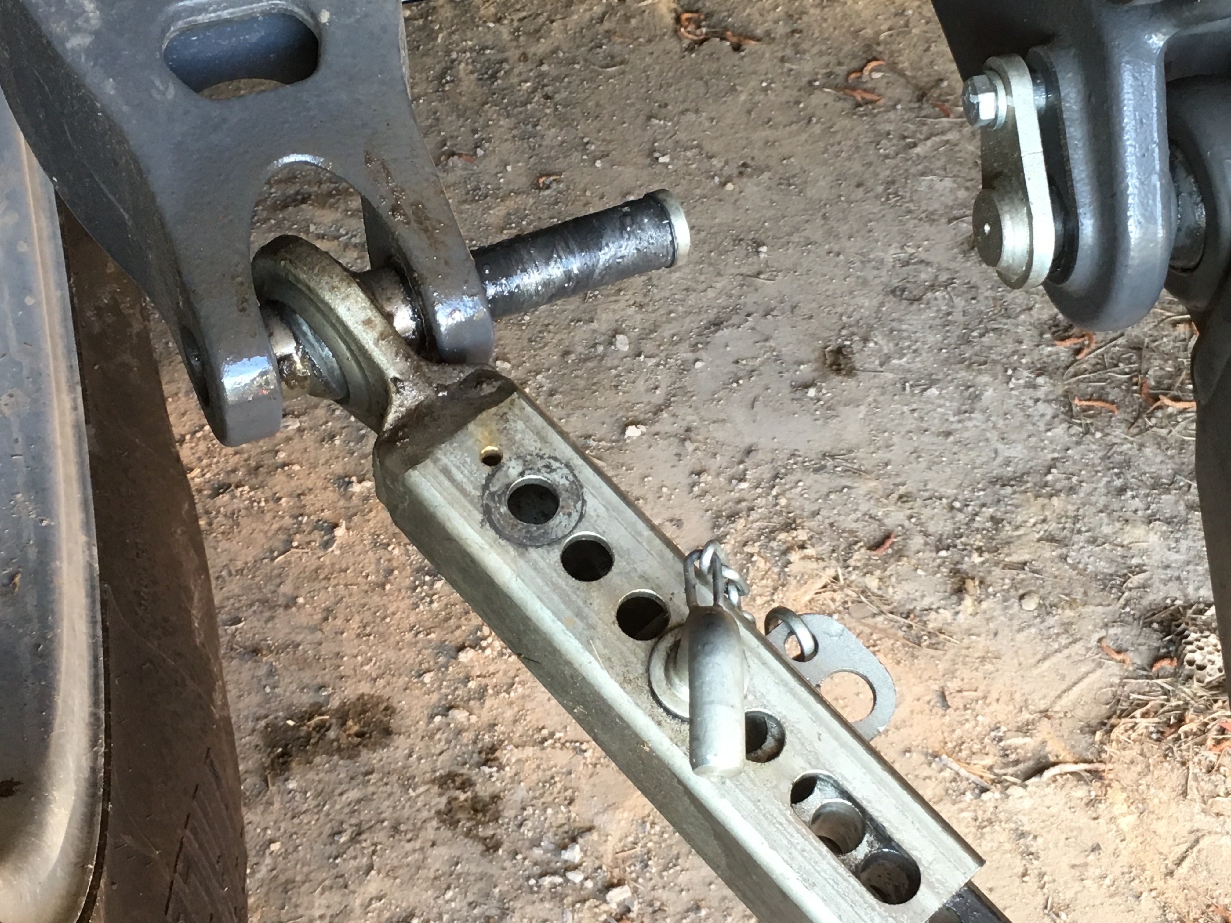

now this applies to any tractor, regardless of make, with a three point.
washed my tractor yesterday early in the morning to beat the heat, and last step was to lube the fittings.
Well nice surprise to be found.
Needless to say, I put the replacement pin back in facing forward and up, something yanked the old one out and I got lucky
here. Things tend to bend and get wrecked when a fitting lets loose.
