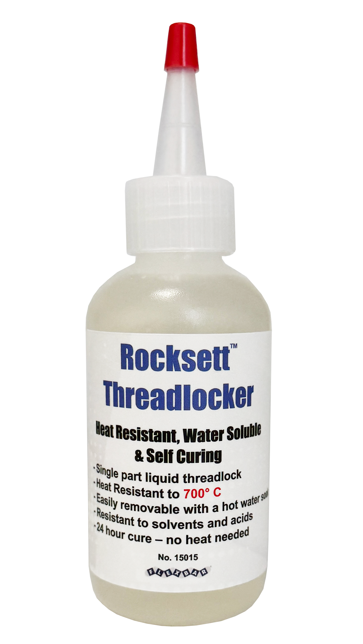

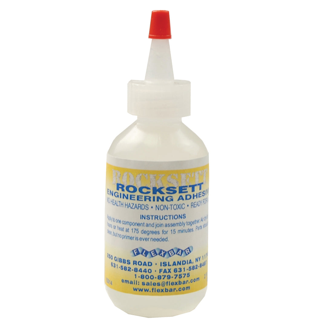

Rocksett and Vibra-Tite are decent alternatives if you can't or don't want to use Locktite brand. Rocksett is particularly good for larger thread diameters.
