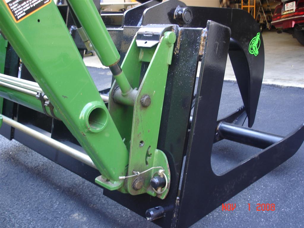

Hey Folks, I have a JD 460 Loader with the standard disconnect - catch on top and a pin on the bottom.
I have a chance to buy a used snow blade that is on the 400x loader with similar pin - catch disconnect.
Will this new attachment fit? Is the width and pin configuration the same?
Thanks in advance - Dave
/ 460 FEL Loader Attachment Question #2
There are two different measurements for the JD QA (quick-attach) system, and it's the spacing from the top hook to the lower pin that's different, both width's are the same.
The newer attachments actually have both pins so they will fit both QA's, so you will have to get the seller to measure the distance for you to confirm it will fit.
See my picture below to see the difference of about 4" or so...

Actually it is very clear.
Thanks Kenny!
