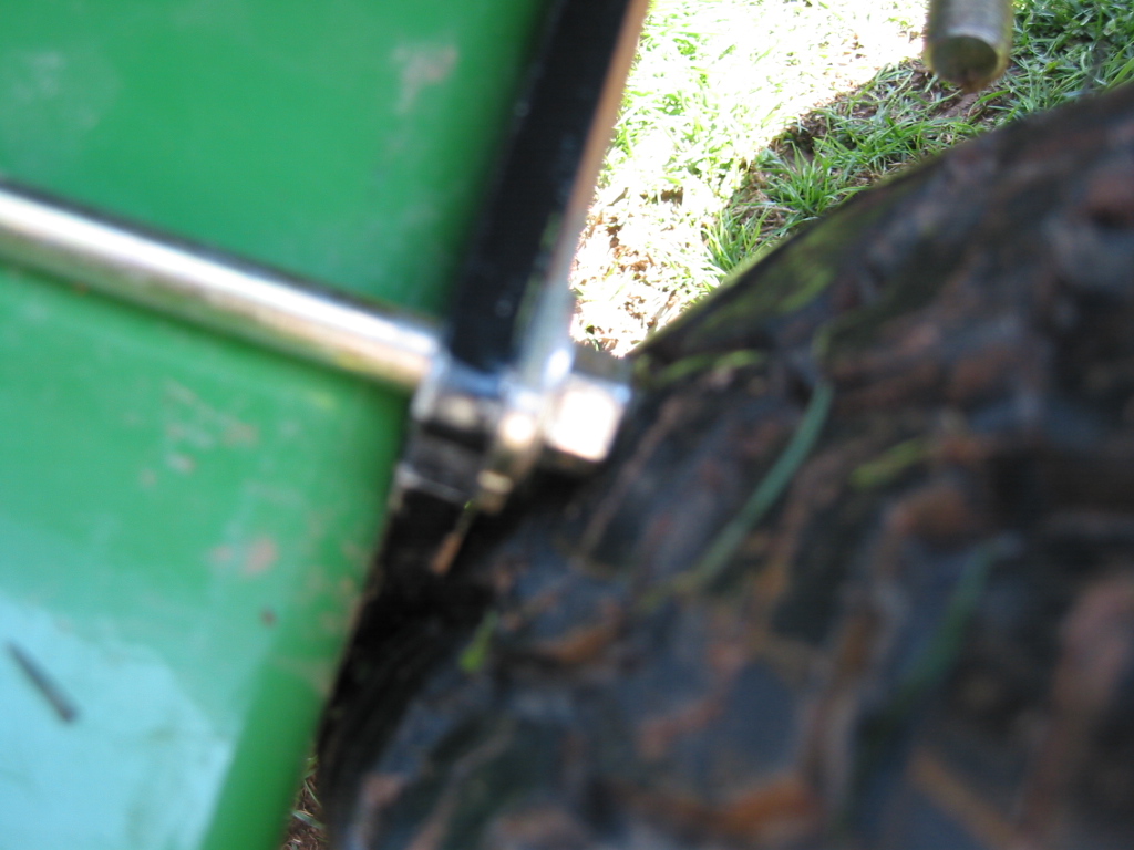

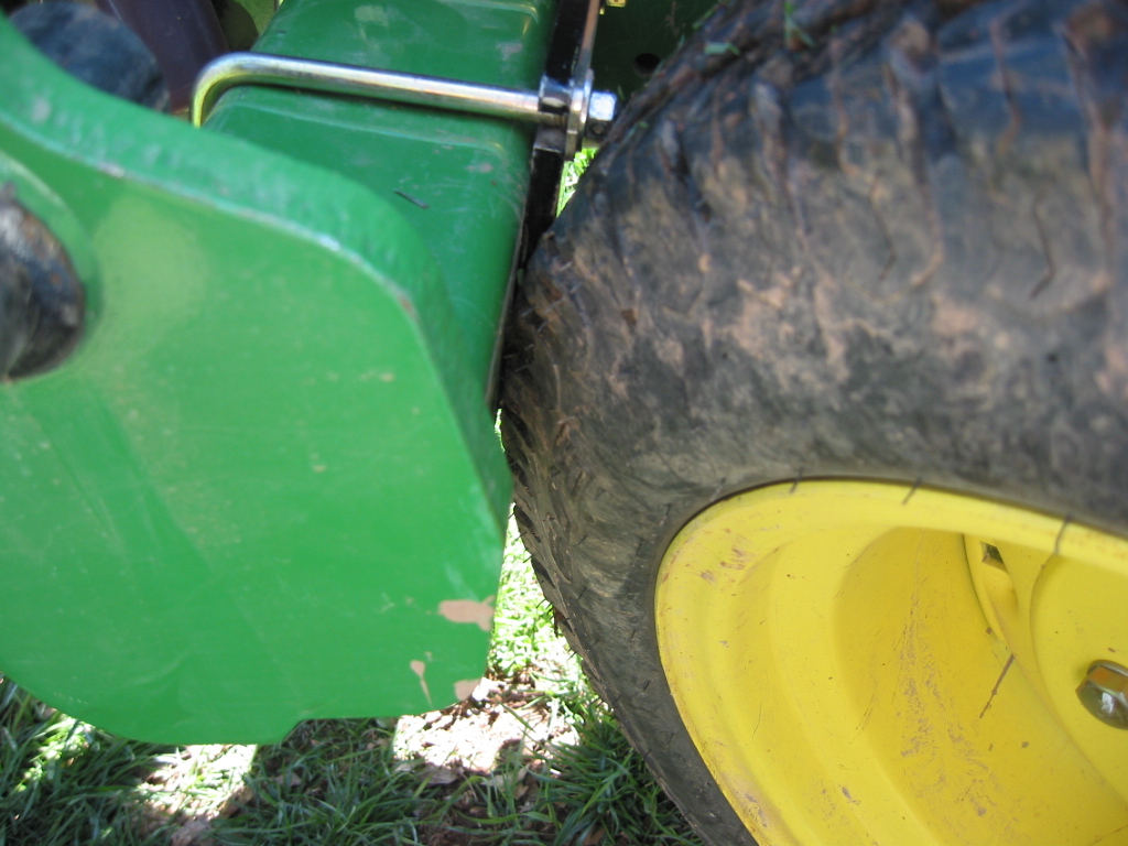

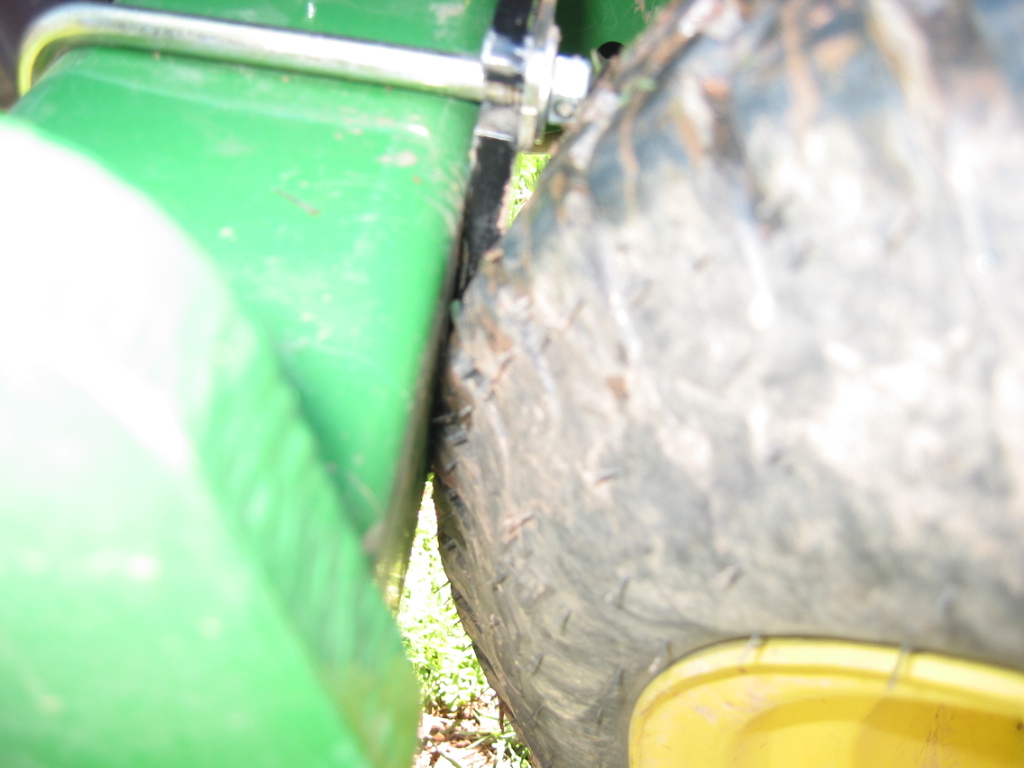

I have a 2520 with the 46 B/H frame. I have been fighting the tire issue hitting the loader frame and mounting bolts for the B/H for several months. JD's solution so far has been to offer to buy back the tractor. (Not going to happen, I like the 2520's capabilities)
JD is now working on new brackets for the B/H subframe to alleviate the U-bolt from tearing up the tires. The issue is aggravated when you are on uneven ground. The uphill wheel is shredded by the bolt (see attached pic). JD also has said that the fix will be to go the R-4's. Turf tires are to big and will always hit the loader frame and B/H bracket. I bought my tractor with turf tires so I don't tear up the lawn. It seems to me that JD is being very arrogant and not really addressing the issues.

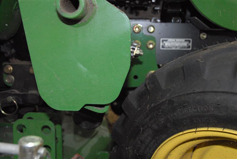

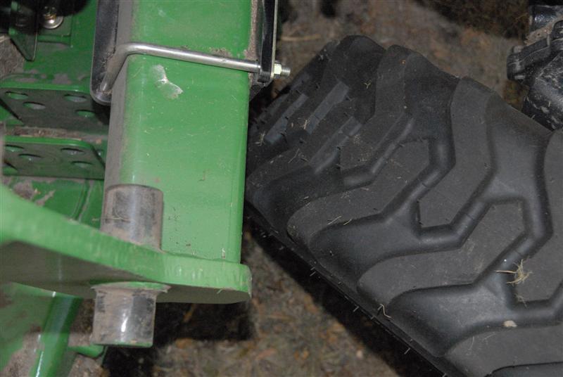

Now I see there the problem is, my 2520 with R4s doesn't seem to have that issue. I've attached a few pictures to show what my tires look like when fully turned. If I can provide any measurements or other pics to help, just ask.

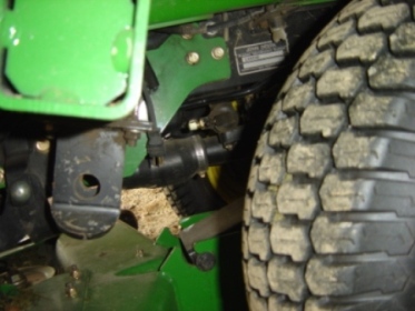

Raining here today so I'm not going to futz with BH but here's a pic of my set-up; 4110, loader frame w/46BH support attached, turf tires....there's over 4 inches of clearance between tire and closest points on the BH mount.
-Norm

/ 46 BH Subframe/Front Tire Issues #13
Put your tractor on uneven ground, where the front axle is hard against the left or right stop, and your tires will hit the loader frame. It doesn't matter about the tire size.
/ 46 BH Subframe/Front Tire Issues #14
Tried it, pretty darn close but doesn't hit. Turf tires.
-Norm
