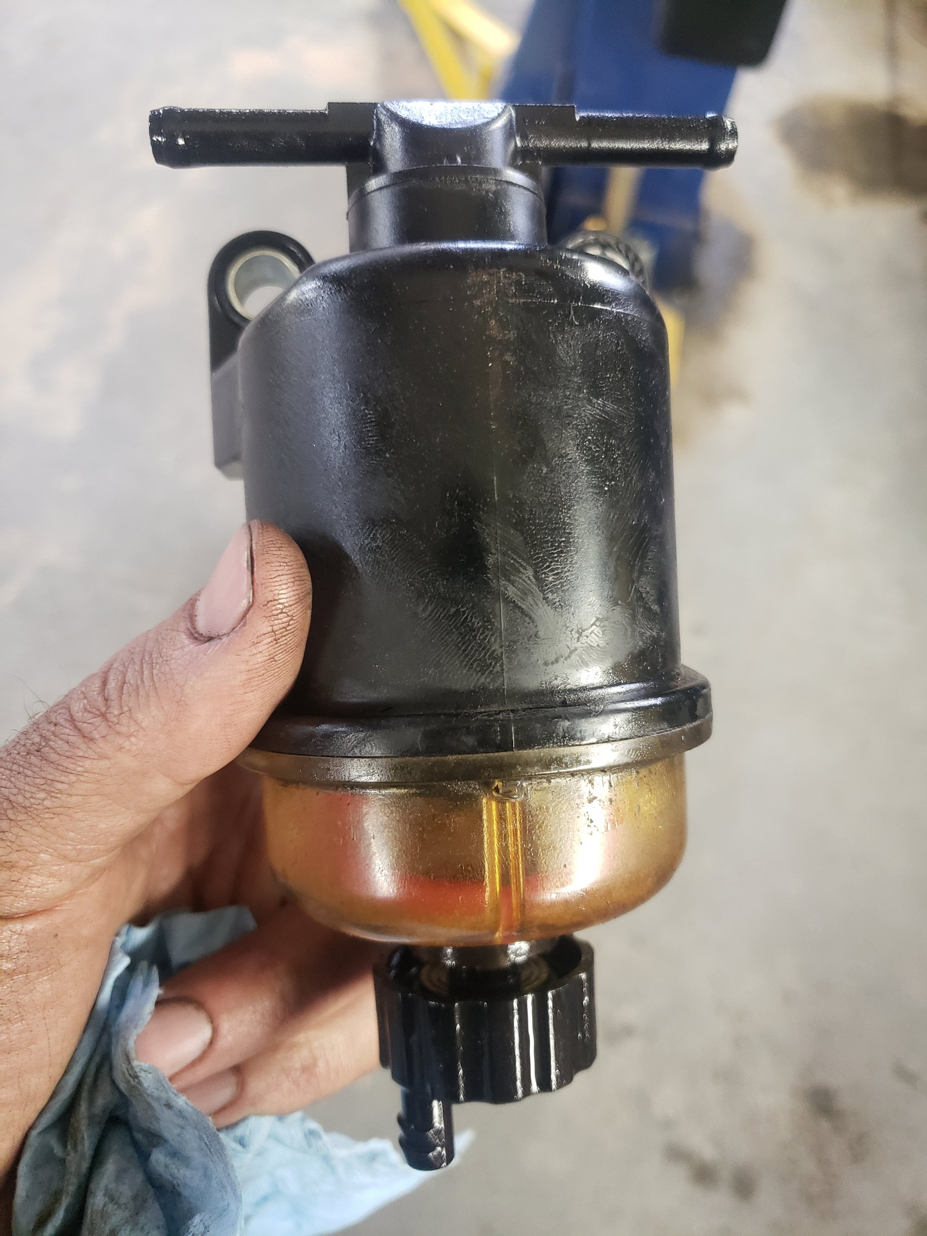

This was the filter assy on a 4520C. Are these plastic units supposed to have a replaceable element? I've tried all I can to get that lower bowl to unthread but I'm just gonna break it.
Tried 2 different strap wrenches and 2 different pairs of oil filter pliers. Even tried heating it a little with a heat gun.
edit: I should say the illustrations in the upside down right-to-left manual and any videos I could find online show a metal assy with just the clear plastic bowl, thus I'm wondering if the all-plastic is serviceable

/ 4520C fuel filter #5
ok this type of fuel filter does not have a replaceable element inside its an all in one unit and you replace the whole thing
EA00005318A is the branson part number for this filter, as of current i am unaware of a crossover for this, however there could be one out there locally but you will probably have to take the old one to your local parts store and see if they can do a physical cross over
/ 4520C fuel filter
Thank you that's the part # I came up with as well.
It'd be nice to find the part # for the metal unit and I'm fairly confident I could make it fit as I'm a machinist and fabricator by trade. Or perhaps there's an aftermarket option?
My only concern with an adapter block (assuming the metal unit doesn't have matching bolt spacing) is that it might push the assy into a cable which is exiting the firewall near there....I assume it may be the accelerator cable but I haven't had time to look.
Still, my local dealer wants $83 for this and that seems dumb when replacement elements for the metal units are $11 to $13

My filter is the same. I think I would rather have the water separator and replace the unit when needed vs a cheaper replaceable cartridge.
/ 4520C fuel filter
All of Lou's suggestions above have a water separator....? AFAIC it's mandatory for a diesel but most setups let you just replace the canister or element filter.
/ 4520C fuel filter #11
That filter would be high on my list to replace with a serviceable separator / filter. The Racor filter mounts are robust enough that I suspect bolting through one hole would be more than adequate assuming the spacing doesn't match up.

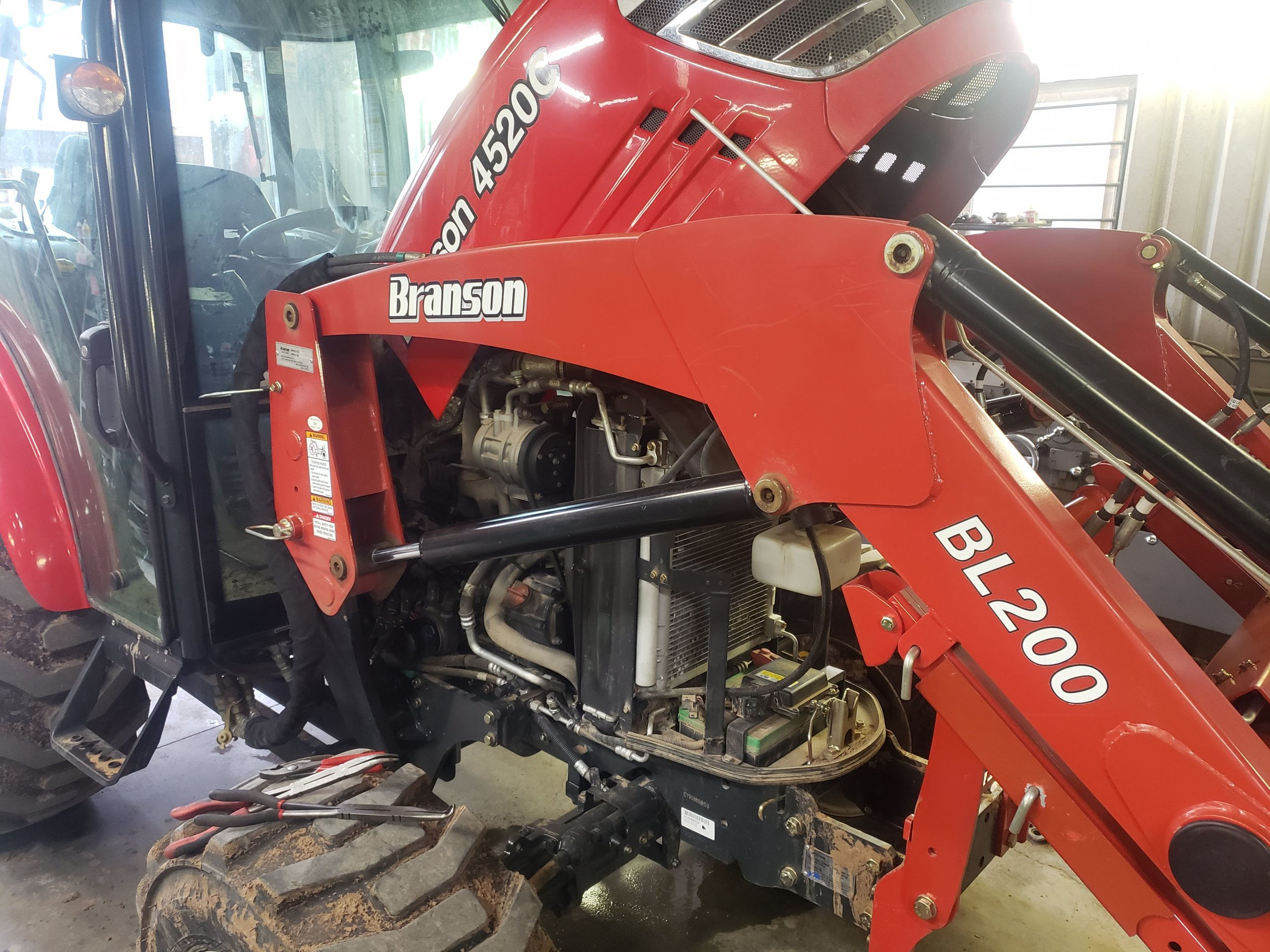

It's not my tractor and I'm not paying for parts but I still thought it was disrespectful of Branson to not include a large vial of Vaseline and Sil Glyde (because the Vaseline alone just ain't adequate)
Also a shot of the cable in question which is indeed accelerator. In this pic I have the filter slid out a bit on the studs so an actual human can reach the bleed valve on top. And I did position the spring clamps such that the ears wouldn't chafe the accelerator cable housing
