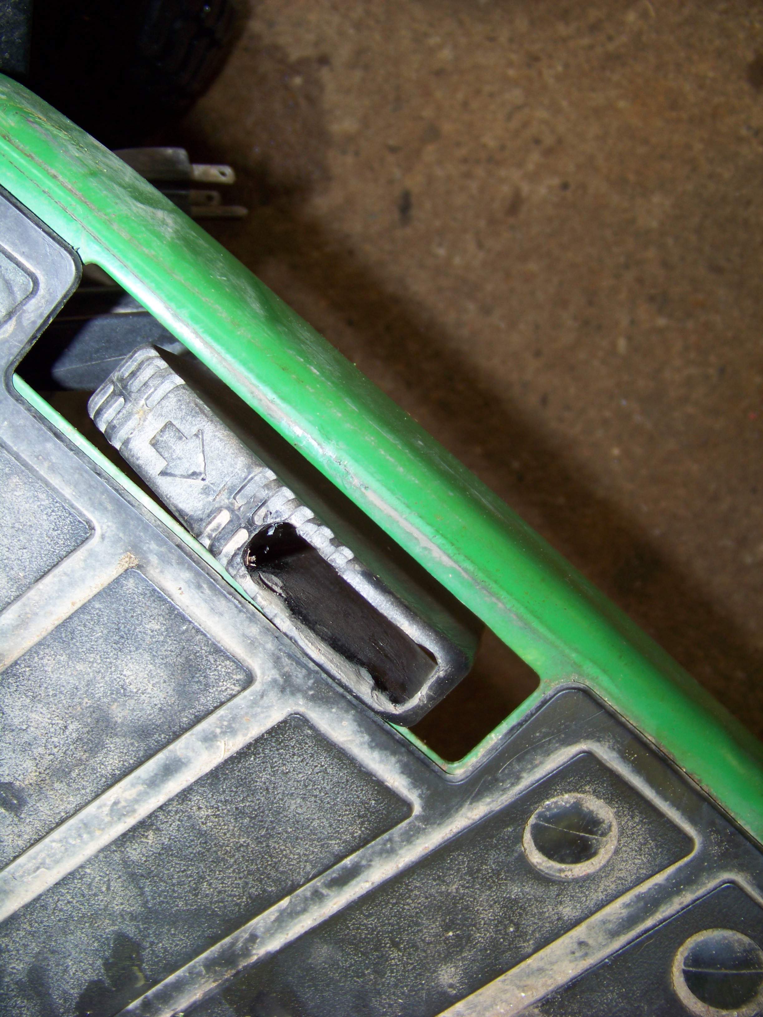

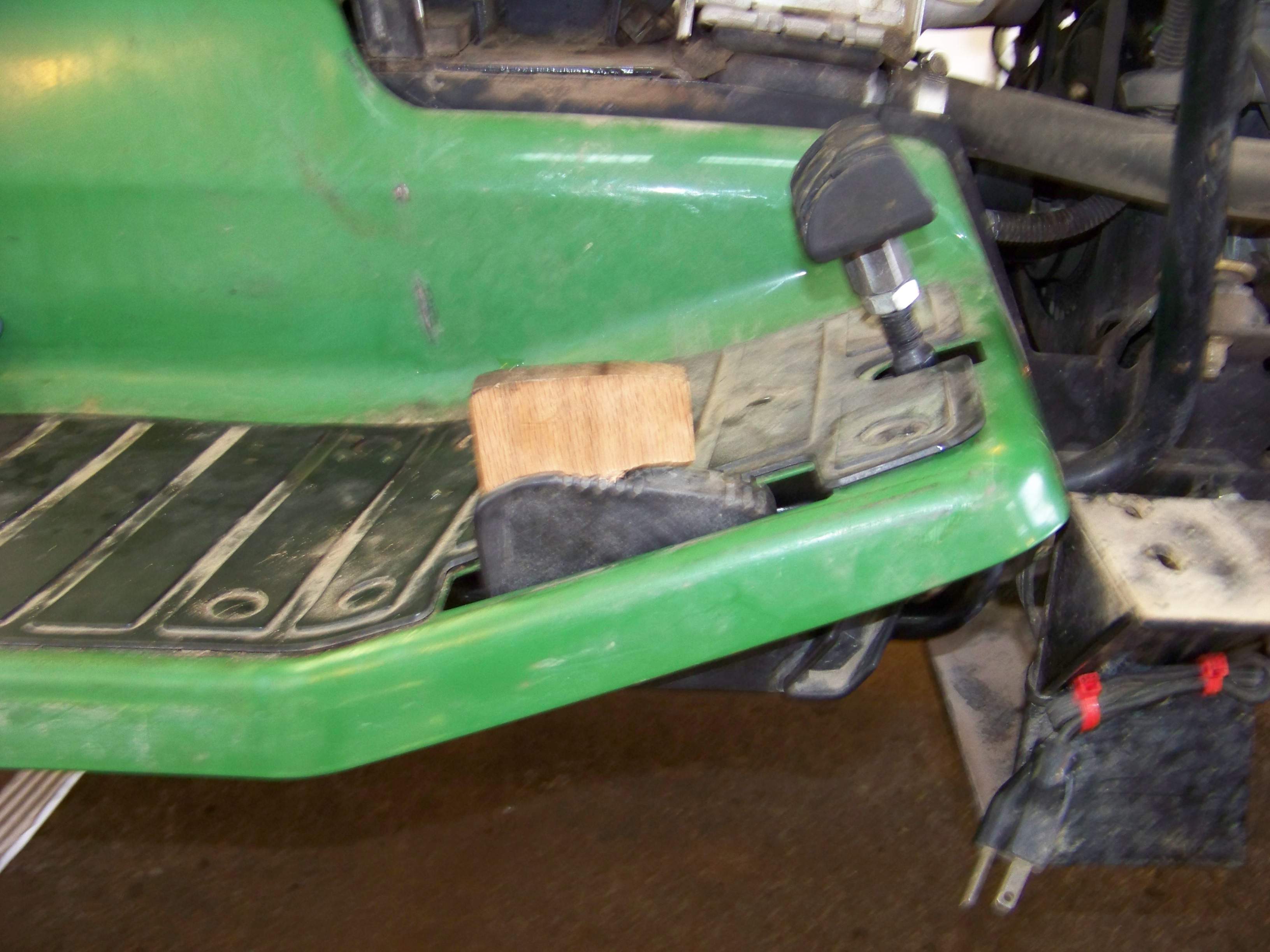

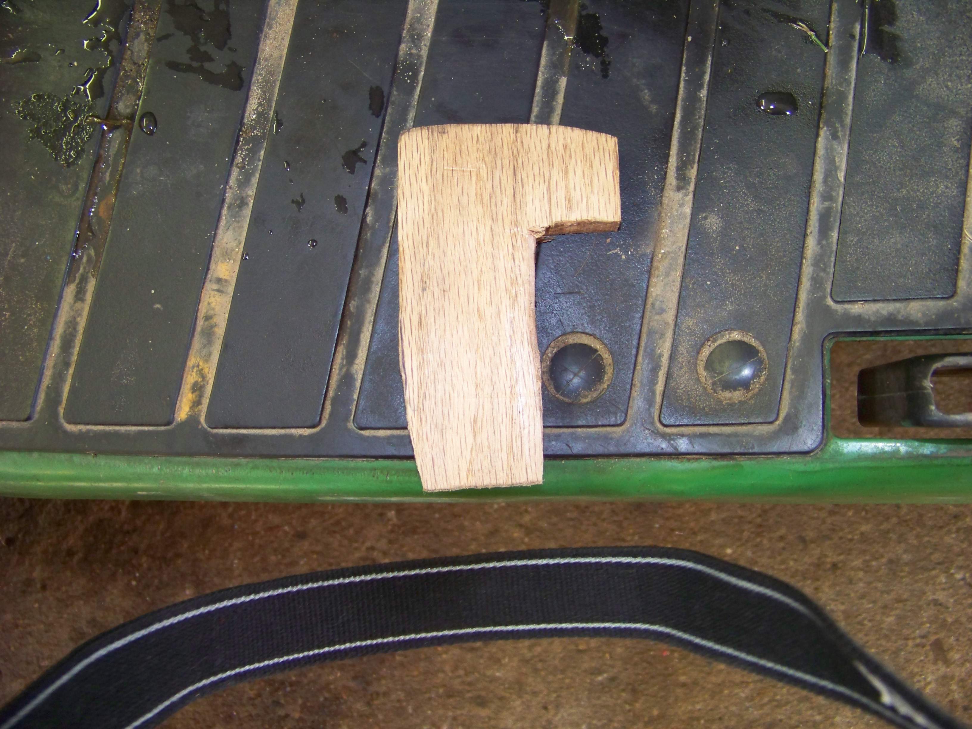

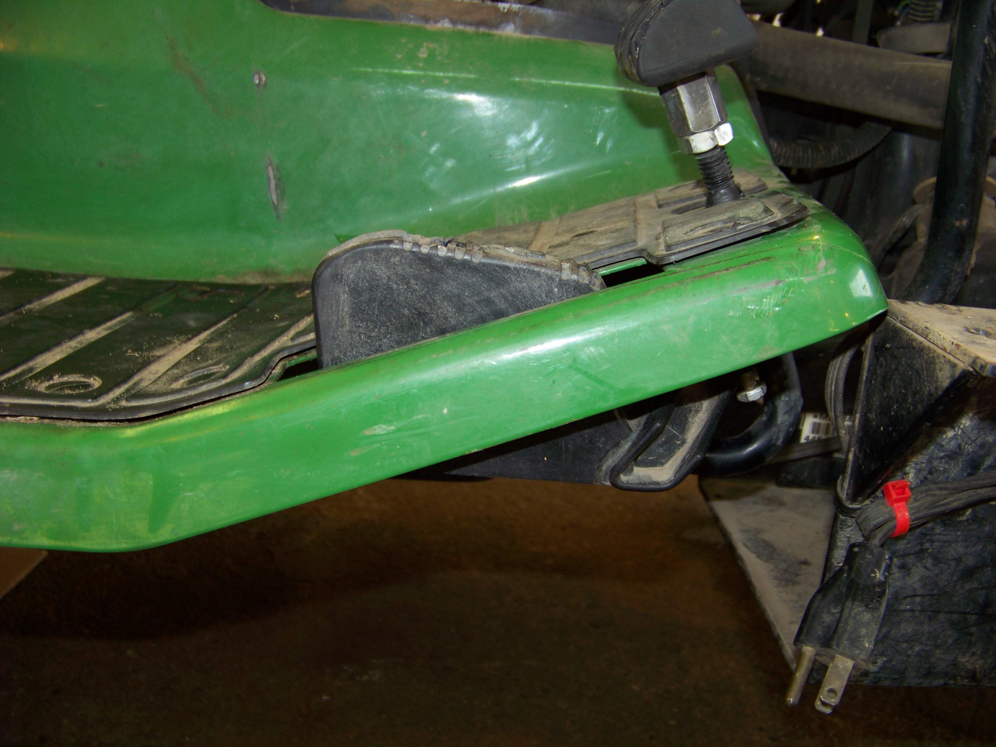

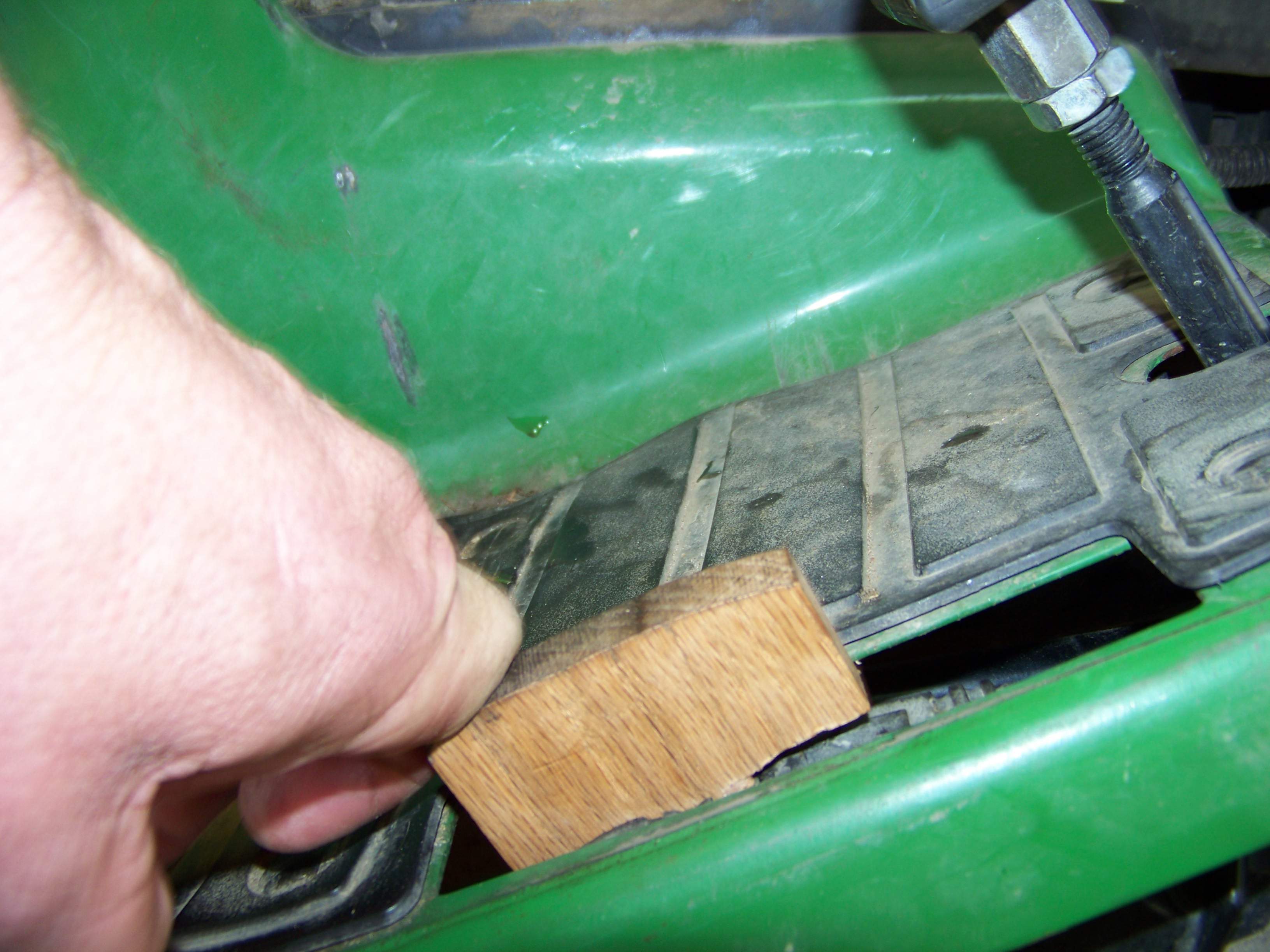

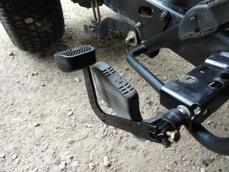

About 5 yrs ago I made a real simple extension for reversing my 445. You think one of the dudes in design at Deere John could have had a brain fart and made the pedal easier to use anyway look at the pictures and see what you think.
The block is made from a piece of hardwood.

That is pretty close to the way I fixed my 455 and 425. Prolly a safety reason that Deere has them going a bit slower in reverse and it was a corporate decision... But I like the peg that you put on yours.. I just formed mine to fit the curve of the pedal and it is glued/screwed to the top.
Yours is prolly more stable and will hold up longer than mine.

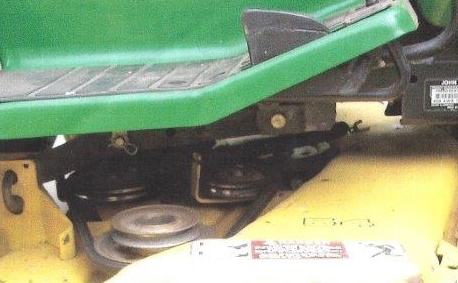

Well I think I posted the wrong link. I suppose others are selling this also and these might be OK.
But this is the one I put on my LX188 and they are the same pedal per this listing.
They are $32 with free shipping.
John Deere 425 445 455 "Revised Enhanced" Reverse Pedal with Rubber Pad | eBay
Below is a picture that I took of my LX188 when I was installing in.
I took this to show the difference in the original vs the new extended version. (both on the shaft)
So you can see how much higher the pedal sits. Obviously the old one has to be removed.

No "problem" backing up either, but from day 1 the reverse was slower by design than forward. With the extension, reverse is just as fast as forward. That was true on all my 425's, 445, and 455 which have been several.
