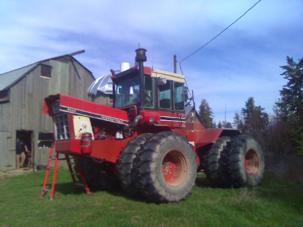

Hello, need help lookn for a 4386 IH steering valve. Dealer says not avalible no more. Dont have any tag numbers yet, will later. Any input on kits, remans or interchange with others is very welcome. Starting here is a good start for such info:D

O.K numbers are 211 1065 001 char-lynn steer valve. Plus a picture of the 4386 tractor. I'm Helpn the father as this time of year is a race to get seeding/fertilizing done without these little surprizes....

Is your powersteering leaking under the steering wheel??
This leak will show up in the cab and under the cab.
On our IH1066 we had the leak in the unit under the steering wheel, they pulled the unit and replace the two seals and it was fixed.
Hope this helps.
/ 4386 IH steering valve help
Thanks for the info. Yep, filled the steering collum and made a mess out of the brothers feet and the floor. Did find a char-lyn parts dealer and waiting on a new valve. The outter seal did look to be installed upside down. But with 12,000 hrs on it, going with new valve:D
