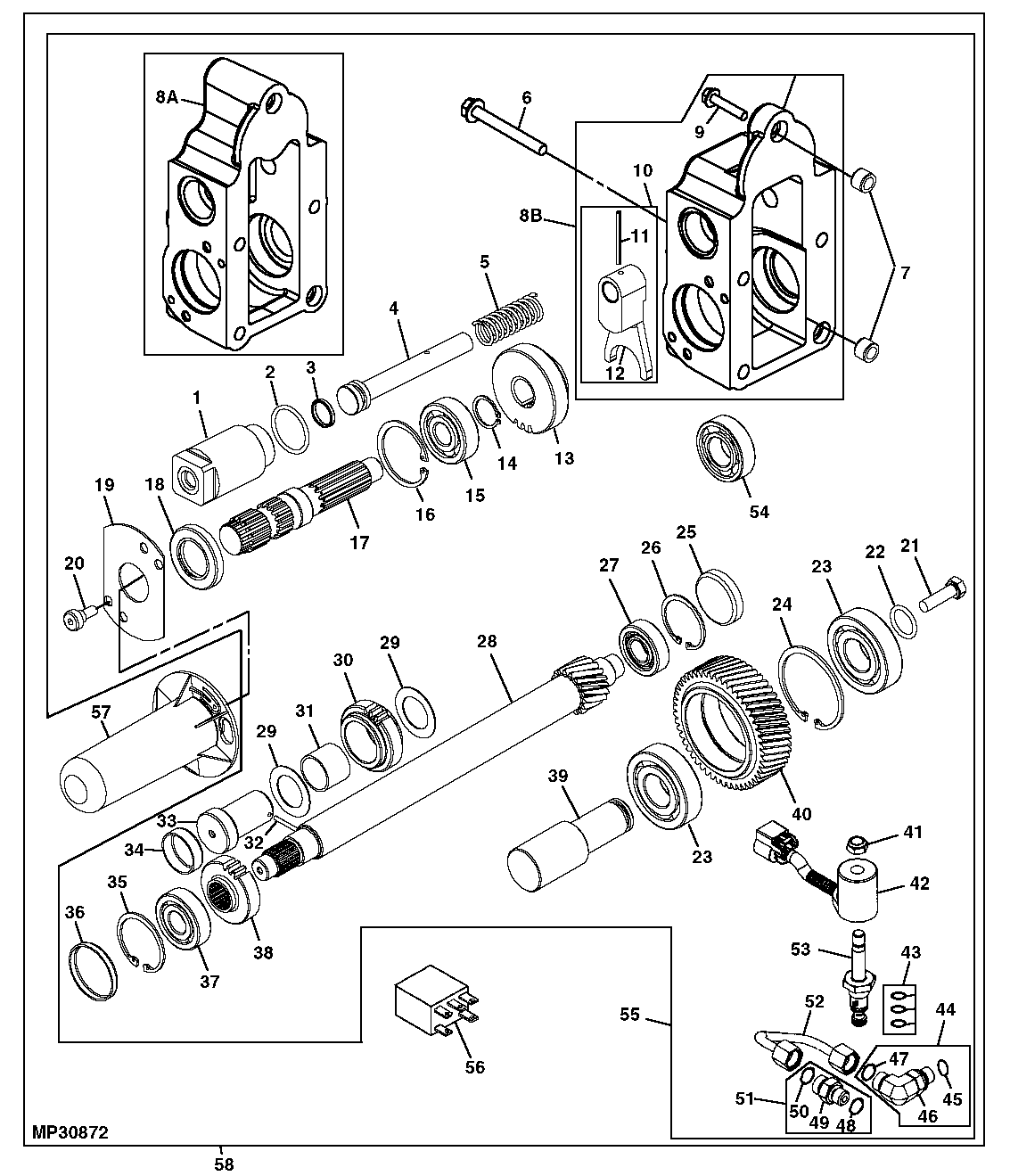

The Mid-PTO is all gear driven from the rear...not much to go wrong. Where you sitting in the seat? Can you have someone check to see if the rear is spinning while the front is engaged?
I need to retract this statement a little. I was going by memory and thinking it was the same setup as the 4x00 series that uses no electrics for the mid-PTO. It seams that the 4x10's uses a much more complicated system to engage the mid-PTO. It appears it is electro-hydraulicly activated. It looks like the place to start is checking voltage at the solenoid valve (#42). It may also be corroded/seized since you have not used it at all in 800 hours. This might be a good time to get a service manual;)

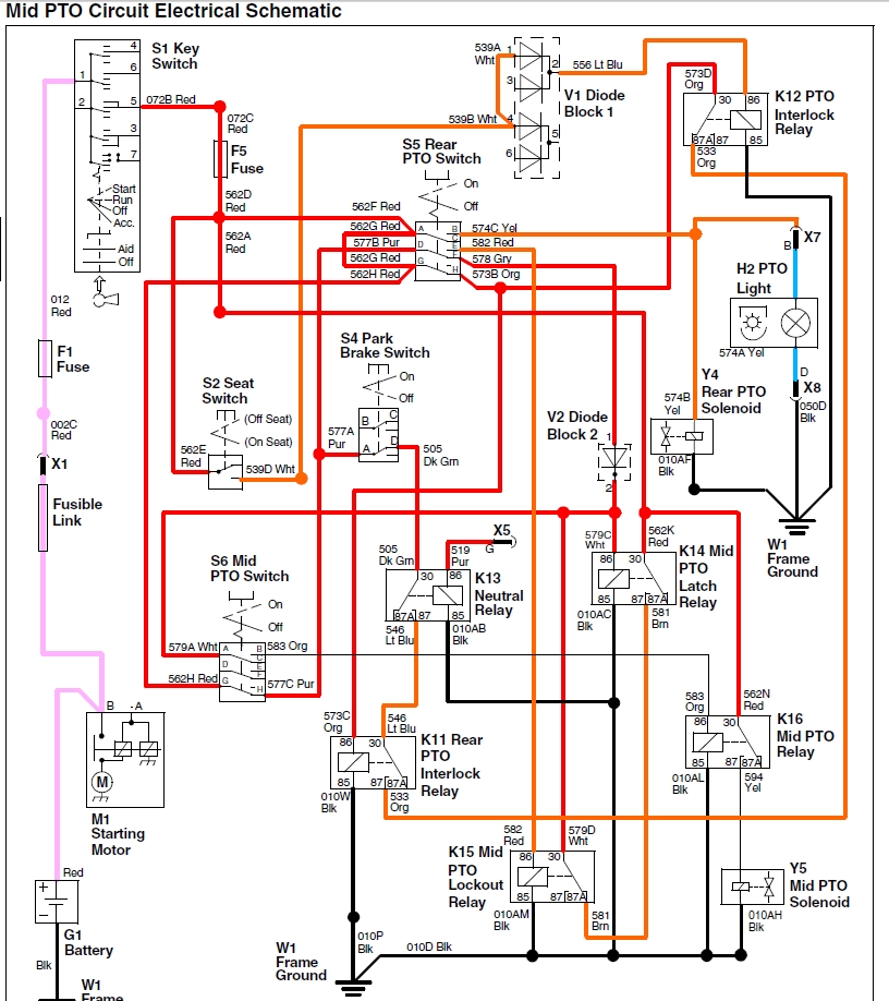

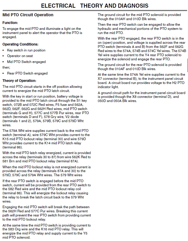

It would take me a while to trace through the logic for the PTO, but for now here is the schematic.

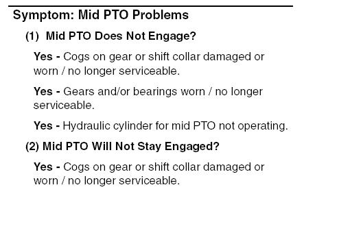

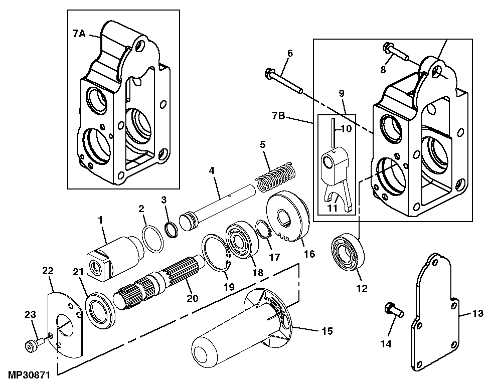

To add to JD755's post, here is a pic of the mid pto on the 4310 that shows the solenoid, and the brief trouble-shooting guide (from the tech manual).

I want to say thank you so much for all the helpful insight! :thumbsup: My wires underneath the tractor were connected into the wrong places and everything works like a champ now! you guys are great!
