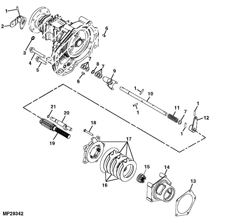

Part #2 is the cam shaft?
Why not take it apart and fix it? There isn't all that much to it according to the tech manual.
that's not my major problem at the moment
and to fix it you have to take the side of the transaxle off, a lot of work
usually they free up with a little travel, you wouldn't accept that in a car

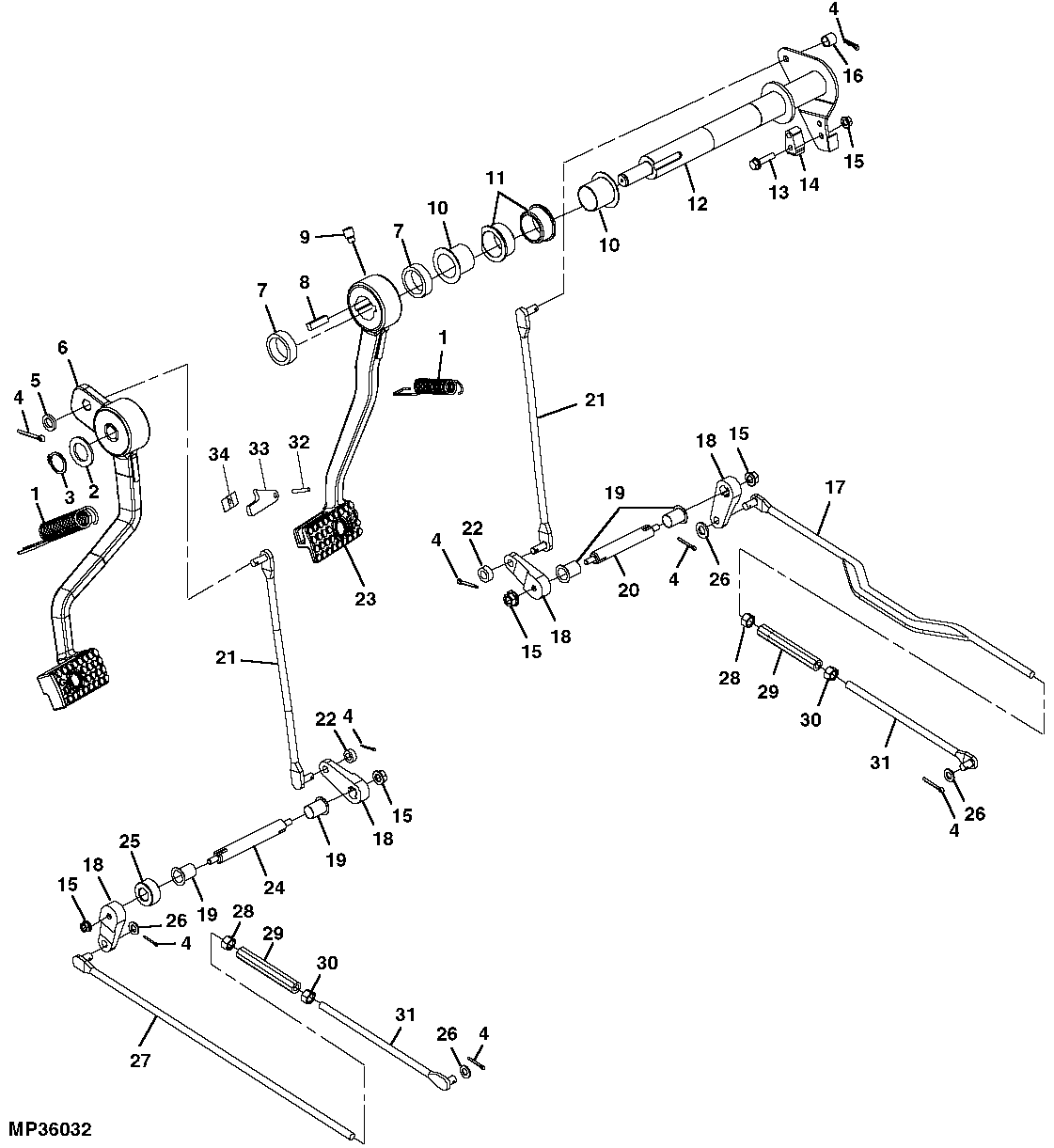

/ 4310 brakes hanging #23
They don't seem strong enough to disengage a stuck brake.
I don't think they are strong enough to disengage a stuck brake. There
are a lot of places where you get friction in the whole linkage system....
I have had EVERYTHING apart, including the friction discs and plates inside
the axle housings. Especially trouble-prone are the greasable pivots inside
the bell housing, IMO. Even a slight bit of additional dragging caused by the
bellcrank not returning to the not-engaged position can be a performance
problem.
BTW, the brakes on my 4300 work very well now, despite the hours and
the previous hard rental life.

#25
I very much agree with that. I had all the linkages apart and made sure they worked like they should before I could get the brakes adjusted properly.
Did you notice any binding inside the housing like Chickenman is describing?

/ 4310 brakes hanging #26
And you didn't buy a new car. You bought a used 4310. And you have all the known problems. Much like every used car I buy winds up with most of the known problems for that model and year.
Besides, I don't operate my car in a field most of the time. And actually, the car I do operate in a field needs more maintenance than my tractor does to keep it running in top shape. Exposed disc brakes and flexible hydraulic lines in a tractor/farm environment would be a non-starter for most people.
It sounds like you should buy a different brand of tractor. It'll make you happier.

/ 4310 brakes hanging #28
No. Once I got the brake bellcranks off (VERY HARD, see story), and the
axle housings separated, I could easily see that the plates and friction
discs were pristine and barely worn at all. I don't see how they can
lock up or stick together bathed in oil like that, unless left unused for
a long long time. (M/C clutches can stick, but they use many more plates.)
What I did notice is when everything was reassembled, and working very
smoothly, even the weight of components without any springs attached
could cause the brakes to drag. That's why I think that JD added the
ROPS bracket spring as a helper. If the brakes drag just a bit, I noticed
that turning the trans gears by hand was quite a bit harder.

/ 4310 brakes hanging #29
You noticed dragging even with the 1" of free play for the rods in the crank slot? I don't have any binding at all now that I've got them adjusted per the tech manual. I only bought new springs because I was already buying the valve adjustment parts. I will consider myself lucky then.
Chickenman, why don't you buy the right manual then? My TM1985 Dec 2002 doesn't split your tractor by serial number like the manual for my 4200 does. Though this website hints at there being a split at 139001. And JD Parts seems to split at 234502 for the controller. Either way, you should be able to get the right manual....

/ 4310 brakes hanging #31
At rest, you want the brakes fully disengaged. In the inch of free play that
you have the wet brakes start to resist at only the slightest bit of
lever movement.

i dropped the link to the brake and still had to pound on the bell crank
I was looking at that today on my tractor. You have/try a slide hammer? I wonder if that makes it any easier?
I would be pulling the final drive housing to repair that. Your brakes are alway on then and I can't see that being good for your wallet let alone the tractor. Those parts in there are very expensive.

/ 4310 brakes hanging #35
You added that I take it? Thats pretty cool. What was required to add the dash knob? I have the lever. And I have a hole for the dash knob since I have new cowl panels and JD only sells the ones with the hole now.
JD changed from the early hand brake lever to the dash knob parking
brake latch in about 2001. That is just one of the many differences
between my rebuild project tractor, a 2000 model, and the later one.
Yours is much like my 2000.
Fortunately, I did not need to buy any brake parts from JD.....it would
be bad if you can not get the early parts any more.
I kinda like the hand brake. This and the Bolens-Iseki G274 are the only
tractors I have seat time on that have hand brakes. One problem is
that the JD handbrake takes some care to fully disengage. Maybe that is
why it was discontinued?
As for the bellcranks, they get a bit of corrosion between them and the
shafts. Both of mine required drilling for my strongest gear pullers.
