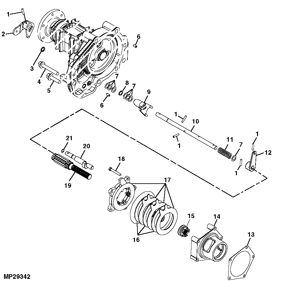

Part #2 is the cam shaft?
Why not take it apart and fix it? There isn't all that much to it according to the tech manual.
that's not my major problem at the moment
and to fix it you have to take the side of the transaxle off, a lot of work
usually they free up with a little travel, you wouldn't accept that in a car

They don't seem strong enough to disengage a stuck brake.
I don't think they are strong enough to disengage a stuck brake. There
are a lot of places where you get friction in the whole linkage system....
I have had EVERYTHING apart, including the friction discs and plates inside
the axle housings. Especially trouble-prone are the greasable pivots inside
the bell housing, IMO. Even a slight bit of additional dragging caused by the
bellcrank not returning to the not-engaged position can be a performance
problem.
BTW, the brakes on my 4300 work very well now, despite the hours and
the previous hard rental life.
/ 4310 brakes hanging #24
Especially trouble-prone are the greasable pivots inside the bell housing, IMO. Even a slight bit of additional dragging caused by the bellcrank not returning to the not-engaged position can be a performance problem.
I very much agree with that. I had all the linkages apart and made sure they worked like they should before I could get the brakes adjusted properly.

Did you notice any binding inside the housing like Chickenman is describing?
No. Once I got the brake bellcranks off (VERY HARD, see story), and the
axle housings separated, I could easily see that the plates and friction
discs were pristine and barely worn at all. I don't see how they can
lock up or stick together bathed in oil like that, unless left unused for
a long long time. (M/C clutches can stick, but they use many more plates.)
What I did notice is when everything was reassembled, and working very
smoothly, even the weight of components without any springs attached
could cause the brakes to drag. That's why I think that JD added the
ROPS bracket spring as a helper. If the brakes drag just a bit, I noticed
that turning the trans gears by hand was quite a bit harder.

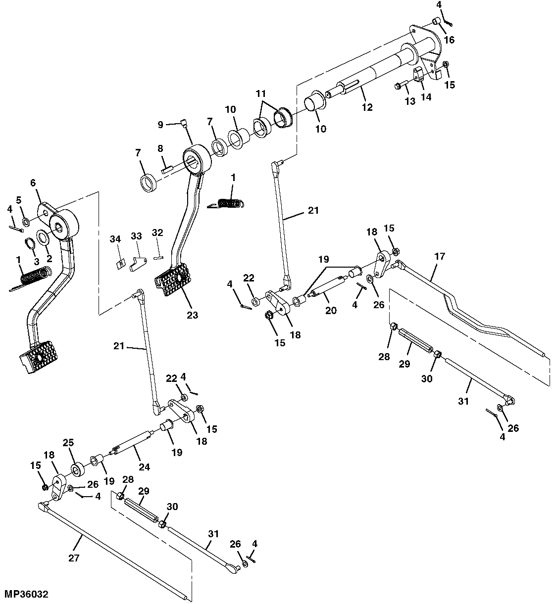

You noticed dragging even with the 1" of free play for the rods in the crank slot? I don't have any binding at all now that I've got them adjusted per the tech manual. I only bought new springs because I was already buying the valve adjustment parts. I will consider myself lucky then.
At rest, you want the brakes fully disengaged. In the inch of free play that
you have the wet brakes start to resist at only the slightest bit of
lever movement.

At rest, you want the brakes fully disengaged. In the inch of free play that you have the wet brakes start to resist at only the slightest bit of lever movement.
The lever/pedal/cam/whatever has 1" of free play on mine. As per the tech manual. Before the brakes begin to engage, you have to move all that at least an inch. Once you hit the end of that inch, its like you're saying, they start engaging immediately. Mine do not engage from linkage friction as far as I can tell (had the kid operating the pedals while I was under the tractor).
