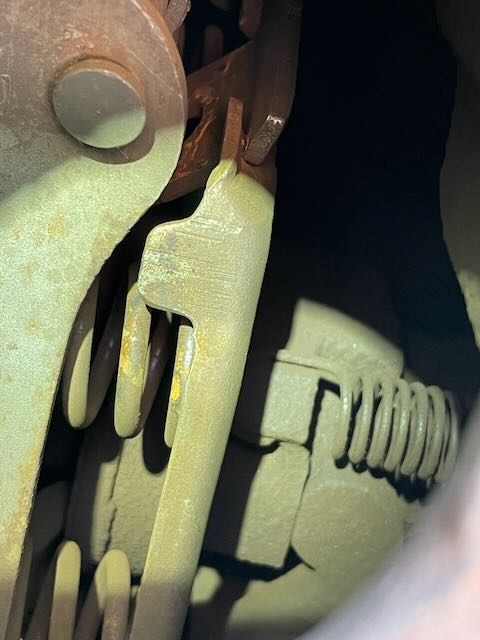

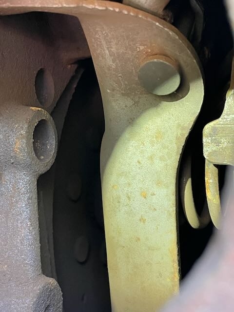

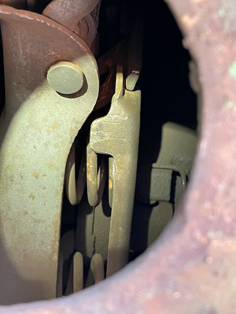

Didn't buy it ...yet. Tires are too rotted for me and he said we could negotiate on that but the clutch was the killer. It worked but was really heavy. I'm 170lbs and I had to hang on to the steering wheel to help me press it down. Smooth but heavy. He said it was replaced years ago but not used a whole lot since so shouldn't be worn out. Zero free play on pedal. Any ideas? He had another one there that his Dad bought new and had original clutch still, you could push that down with ease, as light as my 8N clutch.
Had a look in the inspection cover but nothing I could recognise as bad.

I agree clutch pedal shouldn't be that difficult to depress.
