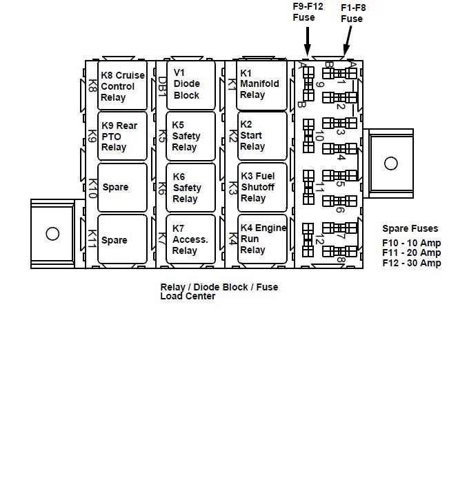

Are there any spare relays in your fuse/relay panel?

nope, no spare relays or fuses. now i need to trouble shoot why it won't start until i pull and replace a relay....and if it will work when done w/ ANY relay, or just that one.
i do believe the tech manual tells how to check the relays, so i can try that before i get new ones....but wouldn't be bad to have a spare or 3.

Just went and pulled one for you defed. They're standard automotive SPDT 30/40A relays. Your truck (if you have one) may have a spare in its fuse box.
