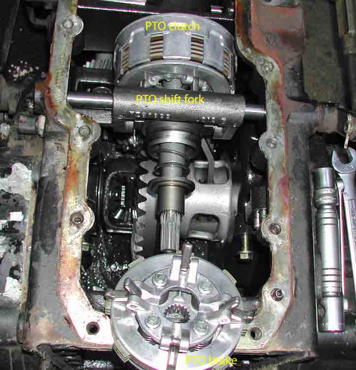

I first noticed it when I was running the rotary tiller, it would stop the tiller when it would hit a rock or something. Then when I was using the posthole digger today the auger would stop if I hit a rock so I would pull it up and it would start turning again. Any thoughts.

Possibly the PTO clutch is slipping...how many hours on the machine?

Is the PTO clutch something your average backyard mechanic can tackle? Can the clutch plates be replaced or do you have to buy a whole new clutch?
/ 4300 PTO stalls #9
Getting at the clutch is not bad at all. You do need to lift off the 3-pt
cyl housing, which weighs 80-90#, and is clumsy. Also, the right rear
wheel needs to come off so you can get the PTO shift shaft out. No
special tools required.
First thing I would do is remove the rear gearbox case cover (PTO cover)
and see what you have in the sump. Like clutch chunks.
As for parts, JD sells the clutch pack (9 friction discs and 8 plates) for
$240, which is high, IMO. I returned my pack after I was able to locate one
more separate friction disc---used but OK. I have one extra if that is
all you need. I found that there was enough play in the clutch engagement
to cause the last disc in the stack to slightly protrude from the clutch
basket, which caused that disc to break. My solution was to eliminate one
friction disc, replacing it with one clutch plate to get the right overall
thickness. My PTO clutch now has only 8 friction discs, but it seems to
work in my dry tests.
Did you look at the photos I posted?

Oh, yeah, you can also drain your oil, pull the suction screen, and look
into the sump to see if there are any clutch chunks in there. Good luck,
Jeff.

Are you sure you are pushing the PTO lever all the way forward, not stopping at the first notch? Hard for me to imagine with 1000 hours your clutch is worn out. The 4300 (like my 4400) is mechanically engaged, on more than one occasion I did not push it "all" the way forward, and it will act like it is slipping.

Wayne_H I think you may have hit the nail on the head. I say may because I dont want to jinx myself. Today I was using the auger and put the lever as normal and it would stall on a big hit. Then I engauged it even further and went right back in the same spot and it wouldnt stall( Knock on wood). I really appreciate the help from all of you.
