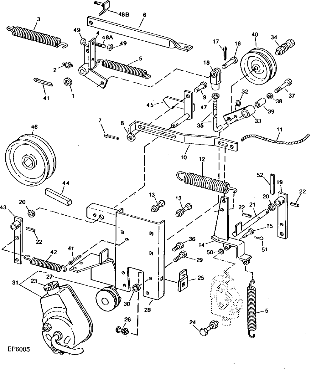

Hi, I'm Linda. I turned to this website for help since my husband is too stubborn. He ended last season with the baler working fine. This season it ties over and over in the same place and won't cut. He has replaced parts, greased and about everything that you would normally do. If you reply I think your comment will go to his email. Any suggestions?
/ 430 baler tying problems #2
Linda
The tying mechanism on a JD 430 rd baler is a little complex. First tell your hubby to be sure all 5 springs in attached photo are intact and attached correctly. Hay/debris can build up under parts key # 14 keeping spool valve from shifting allowing twine arm to move to the RH but not return to LH side to put twine on bale and cut twine. Also rust/debris on spool shaft of valve can cause problems. Back when 430's were new I sold and delivered them. Your hubby can feel free to call me at 8one7*five1seven-1five9zero and I will try to help him. Also I baled many bales with a 430 before I upgraded to a 435,then a 466,then a 467 in my 20+ yr custom hay baling career.

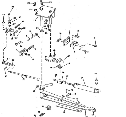

Good Afternoon, I found this old post about JD 430 tying problems. I have a 530 doing a similar thing and I hope you can help or point me in the right direction. In the thumbnail you had showing the parts break down, #21 is not returning to the home position back under #14 after I dump a bale, I have to manually pull #21 forward towards the tractor about 1/4 inch before I start a new bale. I have replaced the springs, changed the filter, and check the fluid level. If I reset #21 back under #14, the tying arm will travel correctly, however I also have to apply pressure to the arm when it reaches the RH side to make it click and then travel back to the LH side. It will start to pull the knife blade down, but does not seem to have enough pressure to complete the knife cut. any ideas? thanks in advance Carl
/ 430 baler tying problems #11
Welcome to TBN
Are all 5 springs in place on twine pump mechanism? Have you liberally greased fittings(keys 48 &49) on twine gear assembly??
