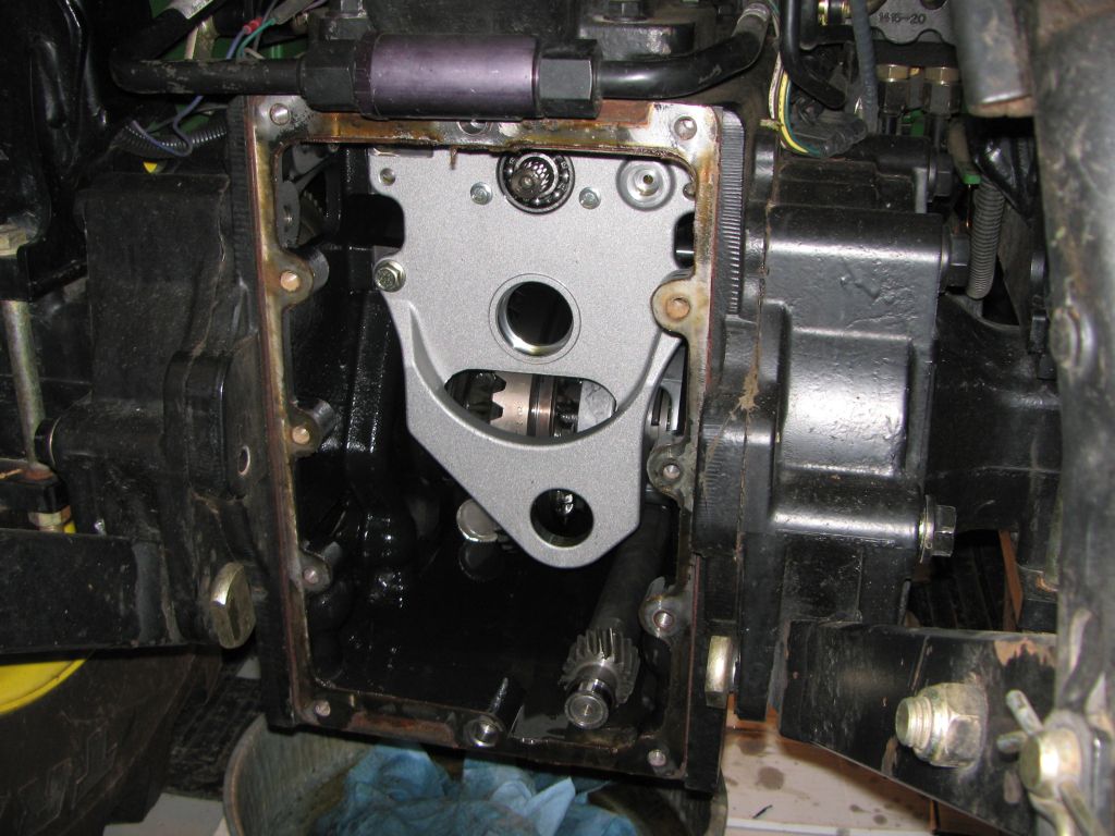

If it is clicking while running, it may be something in the trans... Don't be afraid to pull the back cover and take a look. Drain the oil first. Here is the inside of the 4400. I don't have a picture of the back plate, but the PTO shaft meshes with the gear you see on the lower right to get power to the mid PTO. Check those teeth to make sure you have not dropped and bearing and broke something. Take a look around, and see if you see any metal inside.
Now you're probably asking why did I take my cover off? This was KennyD and Wayne's spring project last year when we installed the mid-PTO on my 4400. KennyD thought it was fun to see my poor 4400 all taken apart, but all is well and no real problems.
Wayne
