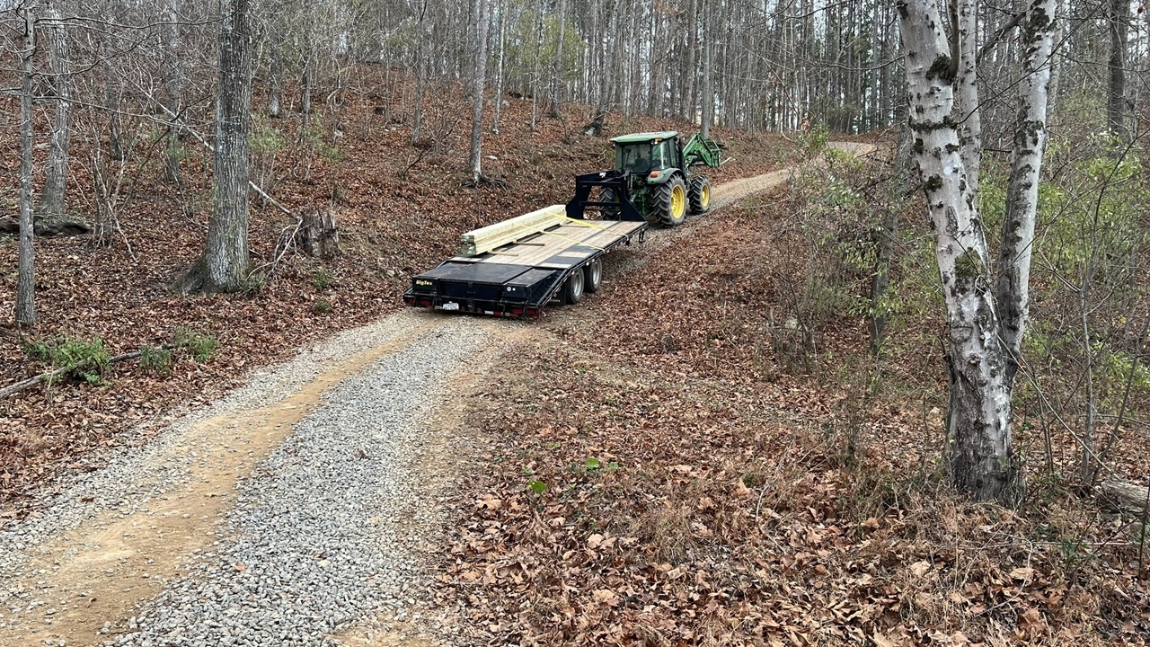

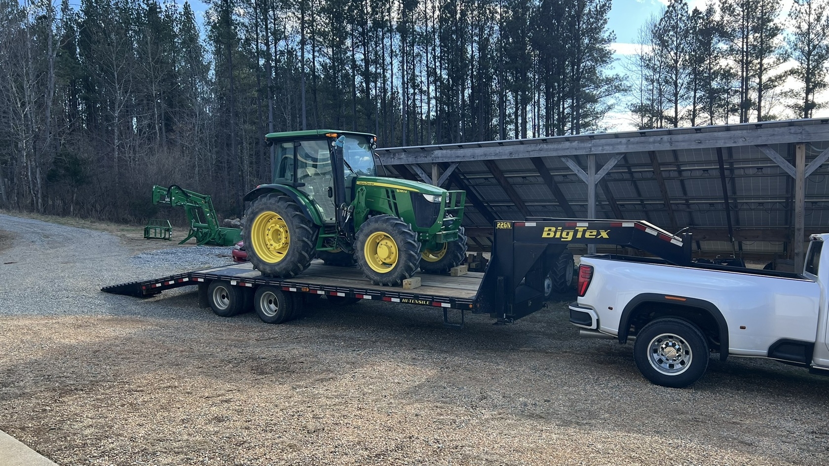

Finally had a chance to pick the tractor back up today. Parked with the trailer facing downhill a little and then put blocks under the front wheels:
Got it of the trailer fine and parked it on flat ground:
Here's a more detailed printout of the work they did:

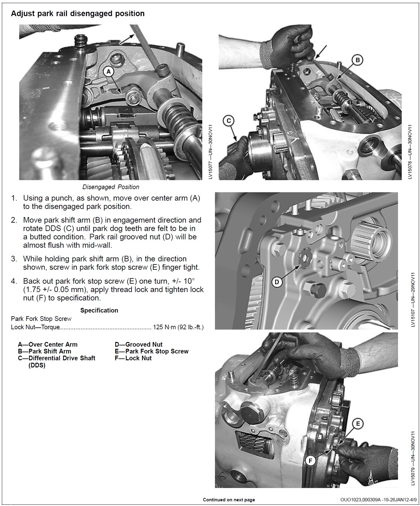

Interesting that there was a dtac case on this issue. Hopefully the tech got it adjusted to where it won't happen again. Too bad I had to drive the tractor that 1/4 mile to load it onto the trailer with the park gear grinding away, but I really had no other choice.

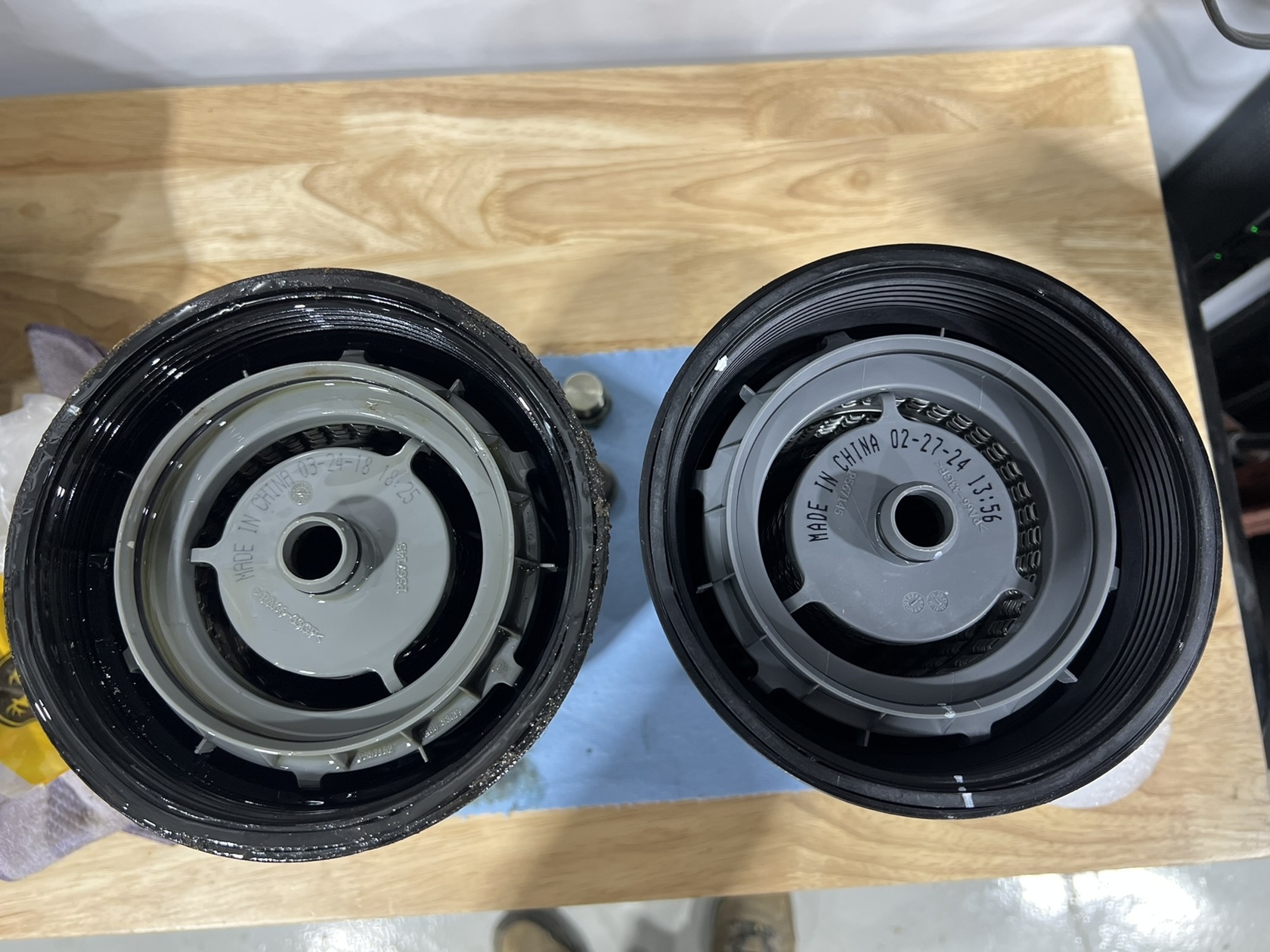

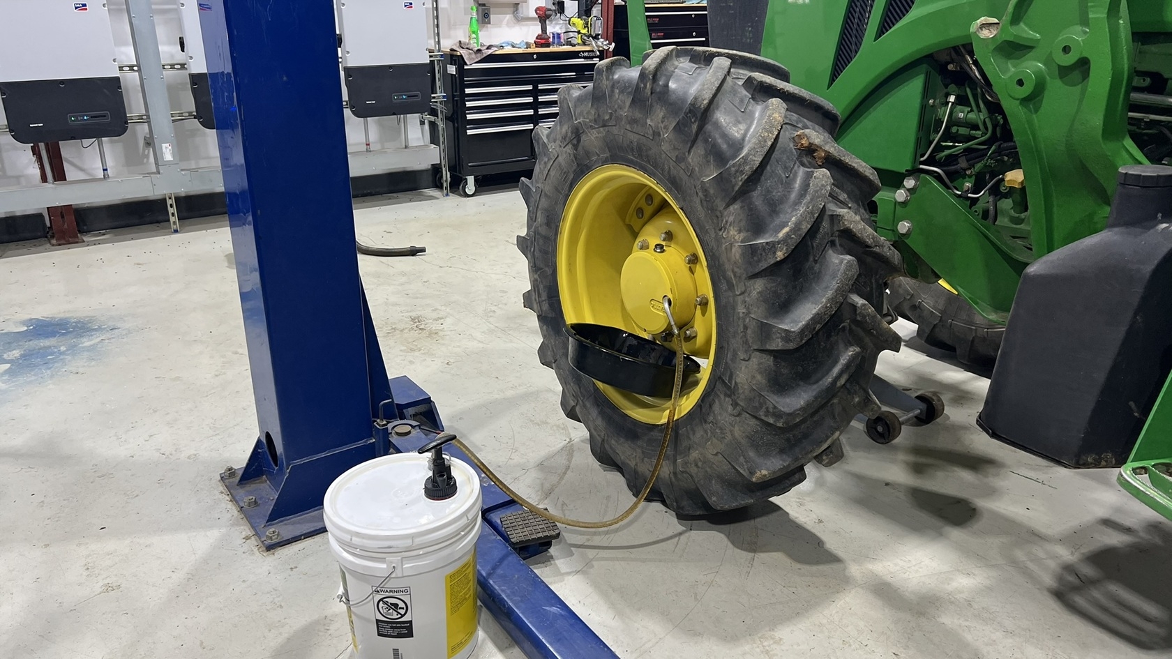

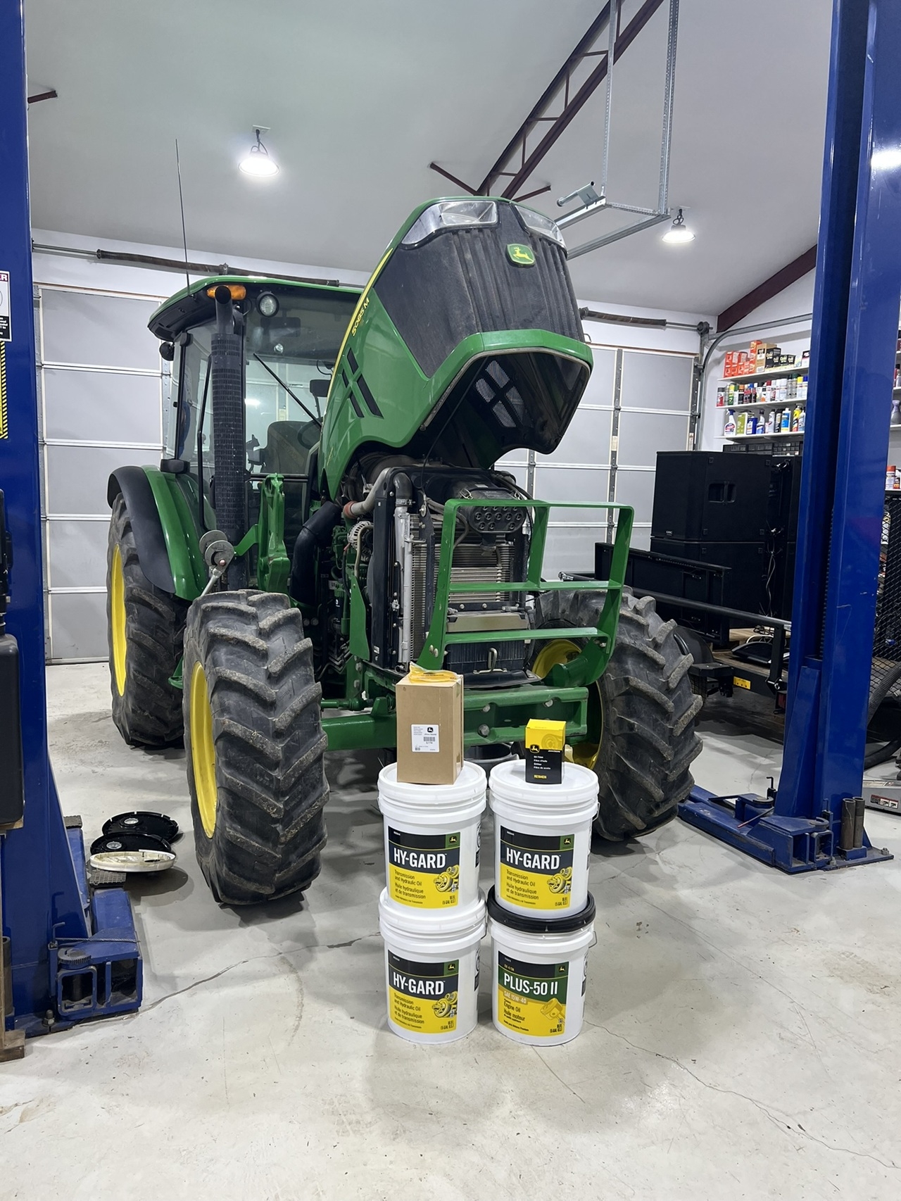

I drove it around some and it seems perfectly fine. I then pulled it straight into the shop and drained both the hydraulic and engine oils. Before I left the dealer, I picked up new oil and filters:
Man that stuff is getting expensive!
Hydraulic coming out was surprisingly clean looking. Old vs. new filter:
2018 sounds about right for when I did the 600 hour service.

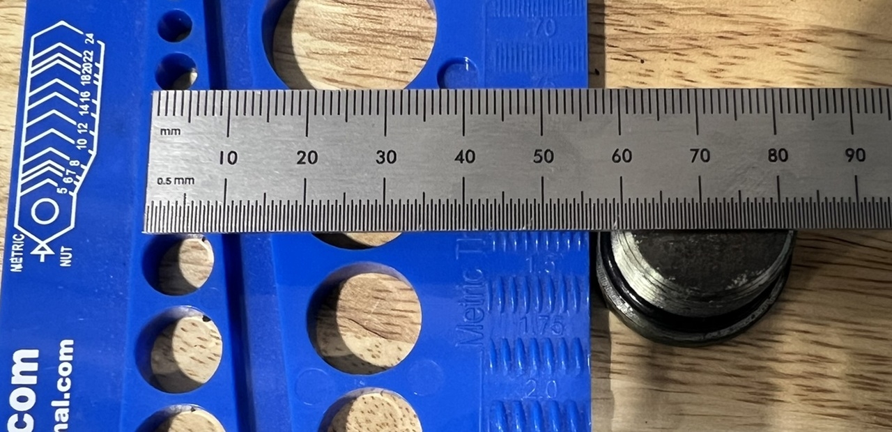

@Alan46 Good idea about getting a magnetic drain plug. It looks to be metric with a 1.5 pitch and 24mm diameter with integrated O-ring:
I'll look around to see if I can find one. Leaving the tractor draining fluids overnight since the hydraulic fluid was still pretty cold, even after driving around for 15 minutes.

Finally had a chance to pick up the tractor back up today. Parked with the trailer facing downhill a little and then put blocks under the front wheels:
I always drain fluid overnight and often get a surprising amount extra in. Which means I get a surprising amount of nasty stuff out and that's my goal. I drain hot or warm but you won't get that in this weather.
   / 5085M stuck in park, but was forced to drive it anyway
#47
I keep my shop at 62F during the winter (lowest setting the mini splits will do). So that helps a little. Did get quite a bit more fluid out, but it still looked good down to the last drop. So if the tips of the parking gears got worn off, I'm not sure where the metal went...
Even though the manual calls for 14 gallons of hydraulic fluid, I hit the full mark on the dip stick at around 11 gallons. I know the filter will consume some, but not 3 additional gallons! I'll keep an eye on it.
Figured while I was at it, I might as well do the front axle and hubs. Letting all those drain overnight.

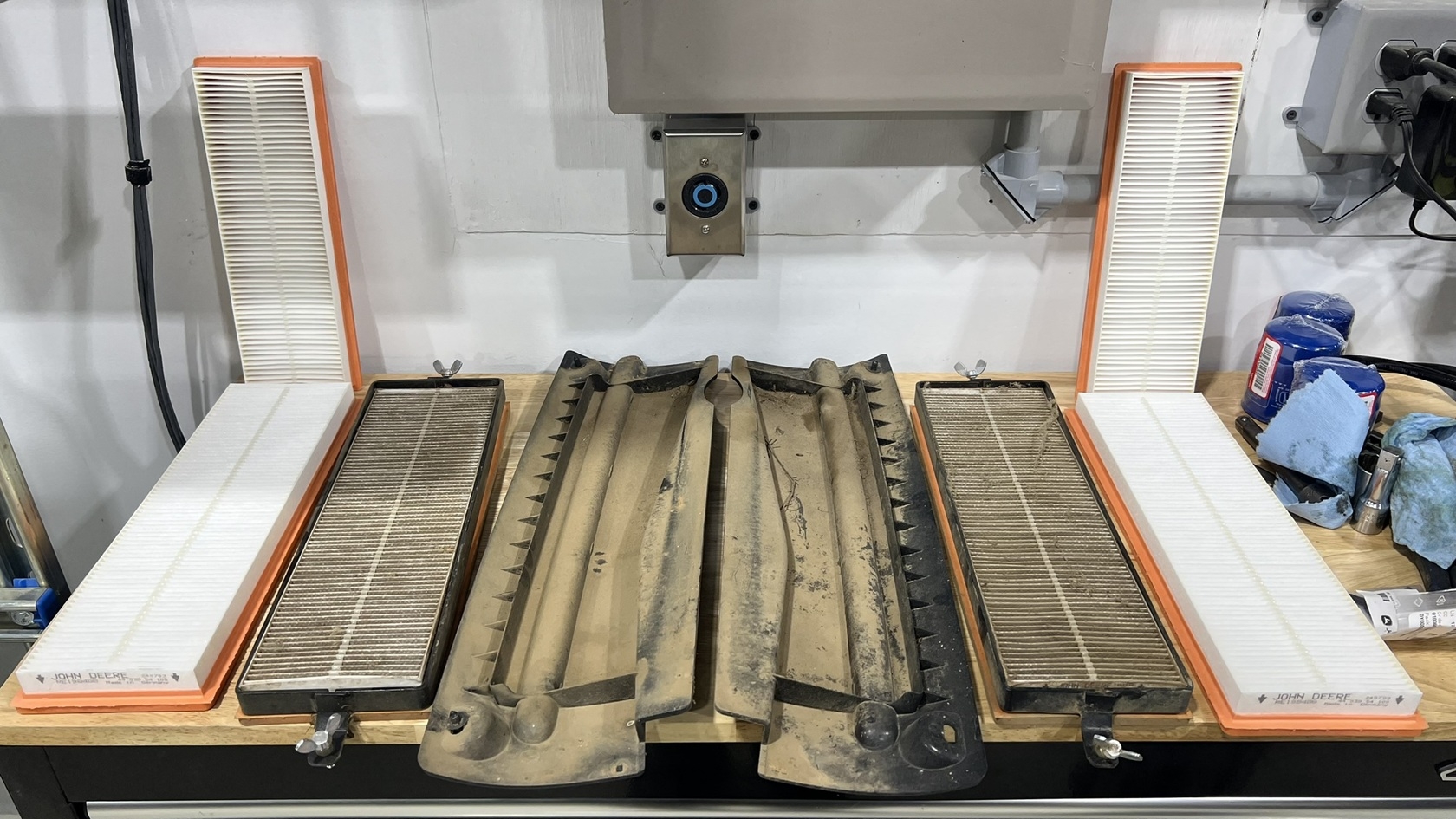

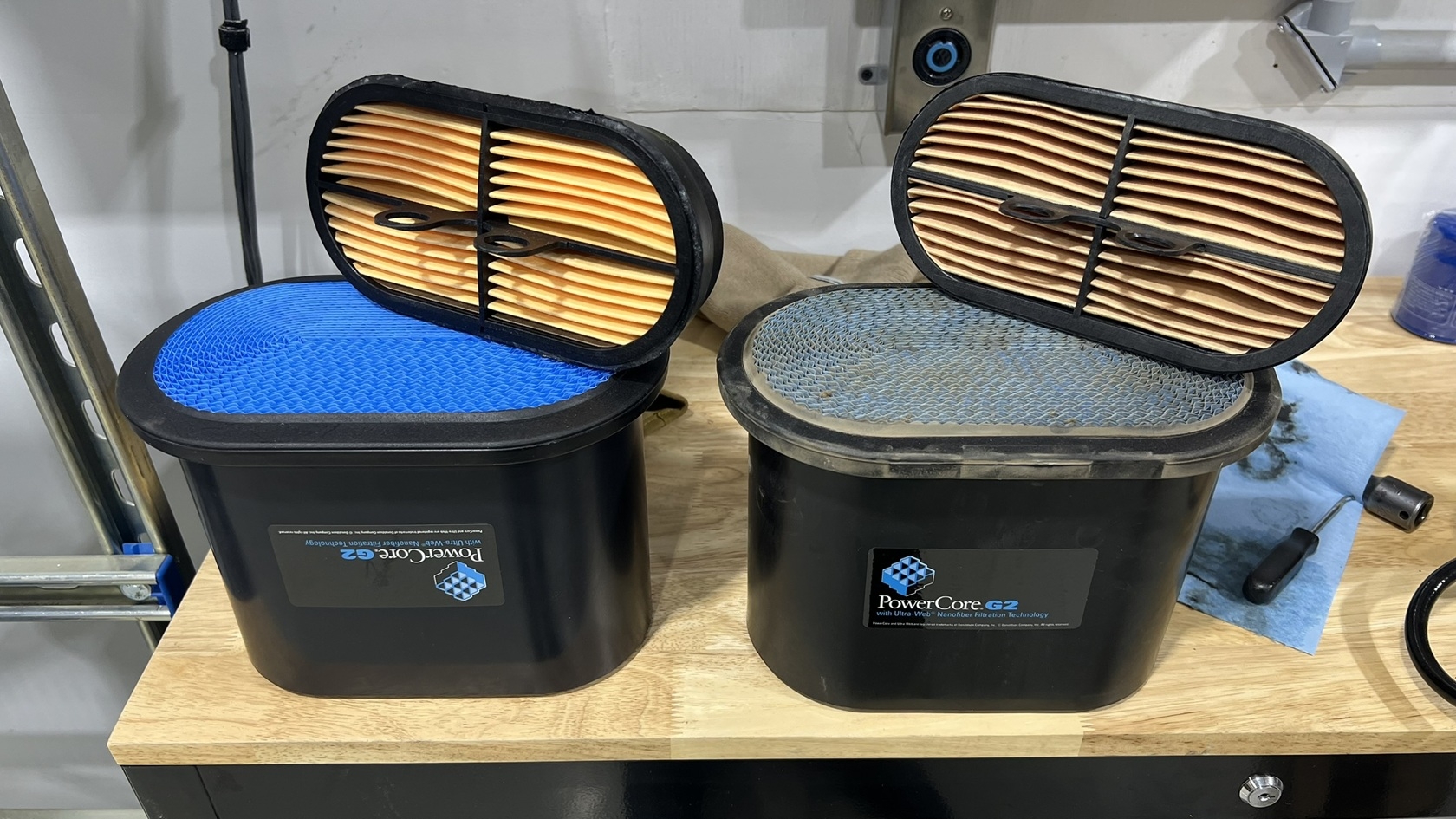

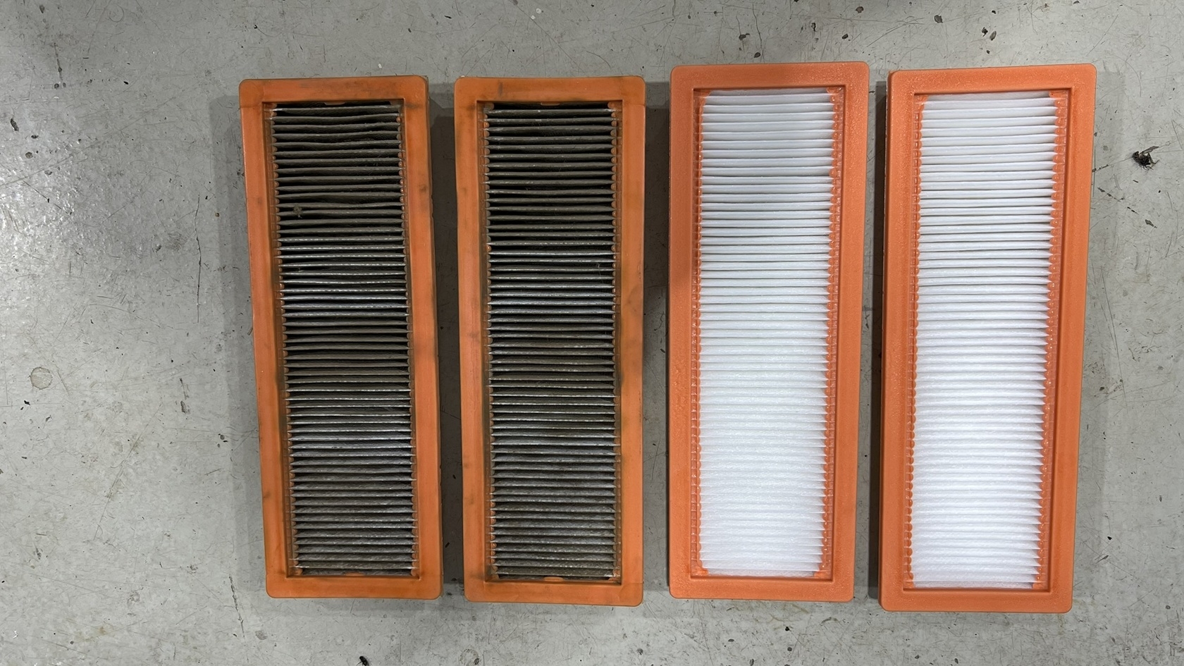

Finally, I decided the check the engine air filters and cab fresh air filters. They were nasty:
And:
I also picked up the recirc air filters while I had my wallet out back at the dealer today. It took a quick look and it would appear that I have to drop the headliner to get at the recirc. filters?
Last time any filters were changed was back in 2018, so I figured it was time.

I was able to pop the plastic vents in the cab and replace the interior air recirc filters as well. They were nasty:
Having new fresh and recirc air filters (the old ones were the originals from 2012, 1050 hours ago) made a HUGE difference in the amount of air coming from the vents. I probably got about as much volume with a fan setting of 2 now compared to 4 before with the clogged filters. I'll definitely start replacing these more often going forward!

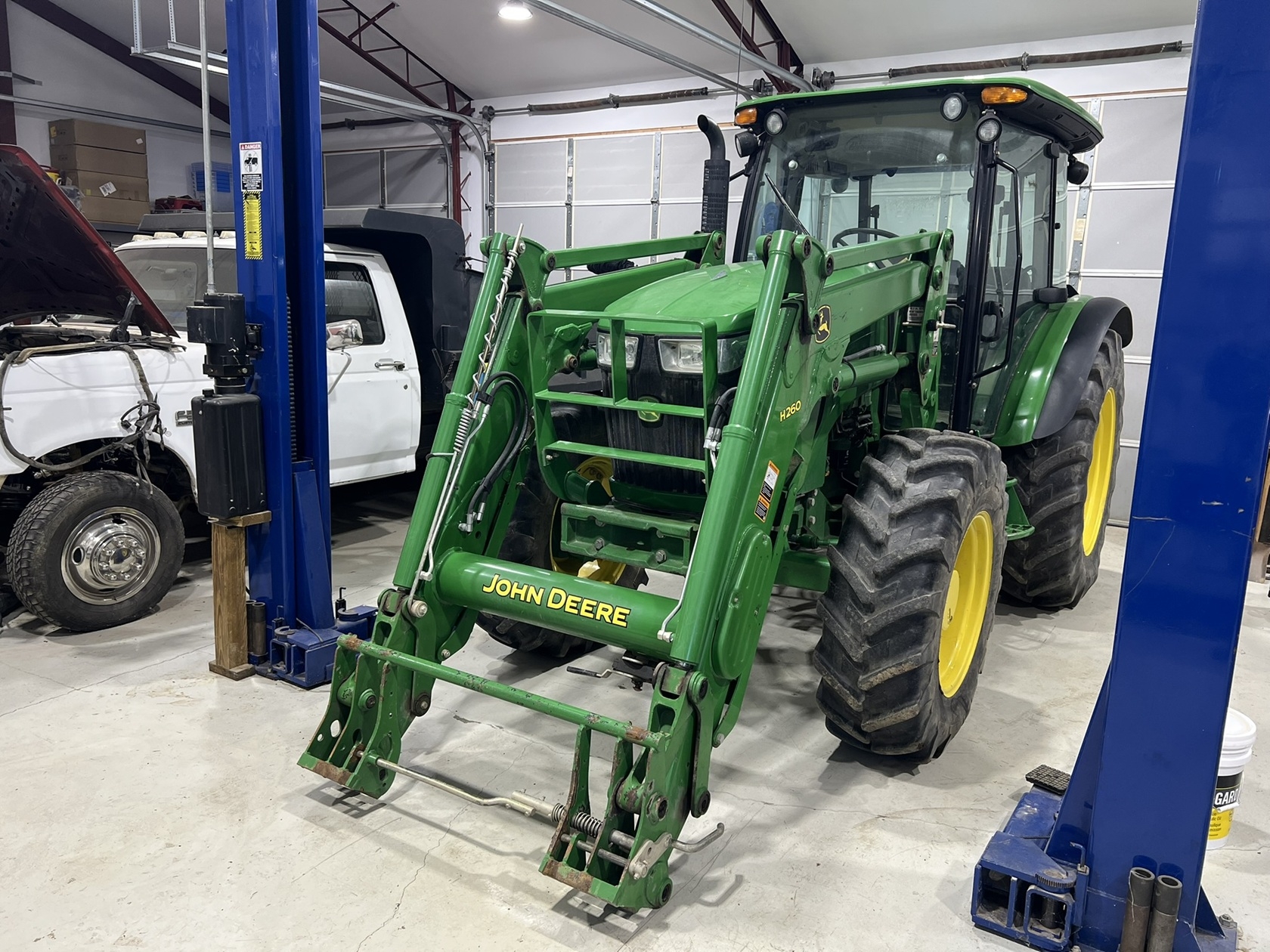

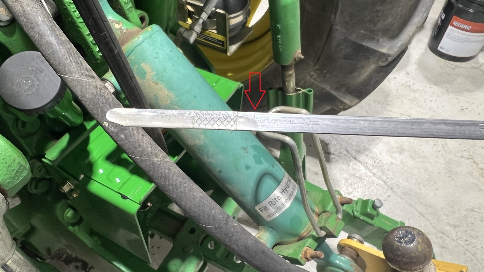

With all that done, I hooked up the FEL and went driving around for about 20 minutes, raising and lowers the FEL and dumped and curled the bucket a bunch. Also raised and lowers the 3pt hitch and worked the top link in and out. After all that, I pulled back into the shop and retracted all cylinders:
Waited 5 minutes and checked the fluid level:
So I'm a bit over. Figured I'll put the front grabble on next and the 3-way hydraulic blade (might need that anyway come Monday morning as they are calling for 5-8 inches Sunday night). This will allow me to work the fresh fluid out into those implements. Afterwards, I'll check the level again and then drain out enough to get back to a few ticks below the full mark with all implements in the retracted position.
