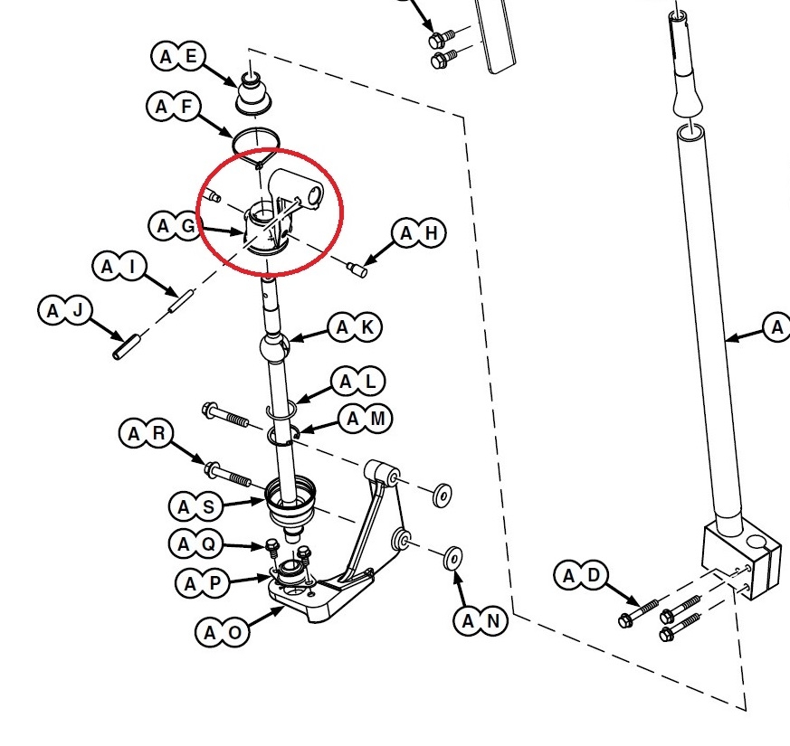

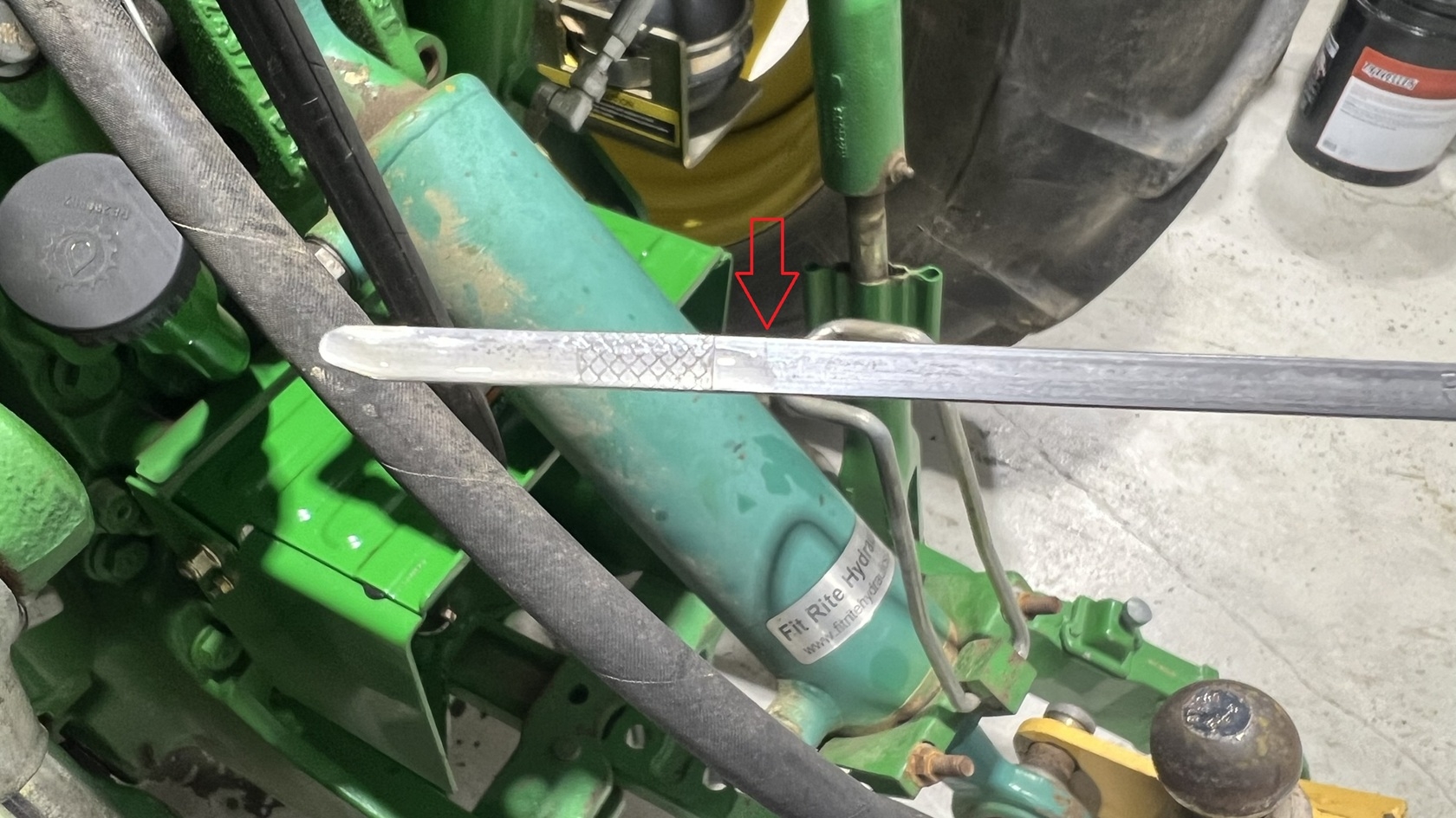

Tractor is a 2012 5085M with PowrReverser Transmission. 16 forward and reverse gears (4 ranges with 4 gears in each). It's NOT the PowrQuad PLUS or Powr8 transmission and it doesn't have the creeper option.
The range selector (A-D and Park) is a long shaft with a cradle at the bottom with a ball joint:
About half way up the long rod, is the item circled above. This connects directly to a shaft going into the transmission shift rod. There are no external adjustments at all. When I attempt to push the range selector away from the seat towards the park position, the shaft going into the transmission won't allow it to come towards the park position. There's nothing external that is preventing it from moving in that direction.
Never had a single issue with the transmission in my 12 years of ownership. So it went from working 100% to not working at all after putting it in park on a step hill with a trailer attached.

Suspect the load on the park pin kept it from disengaging fully when you parked on that hill. Used to have same problem with our 2510. We learned to do everything you could to not put it in park under much of a load. Had to use another tractor to pull in slightly once to get it to come out of park.
Surprised you got it to shift into gear.
Hopefully nothing to major damaged and a lesson learned.

5 series tractors have had this type of transmission on the sync shuttle and PR I know since 2000. Sounds like something broke in yours and I can't imagine not doing additional damage if you drove it very far stuck in park.
   / 5085M stuck in park, but was forced to drive it anyway #30
Sounds like the "park" pawl is stuck partway & grinding gears as you move. A simple adjustment may be all that is necessary, But you will want to do an inspection of the gears/pawl for tooth damage/wear before putting it back together. Hopefully, they were smart enough to make the pawl of softer metal so it took the damage instead of your gears. Also probably need to change the tranny fluid/filter at a minimum. worst case, you're looking at a rebuild.
